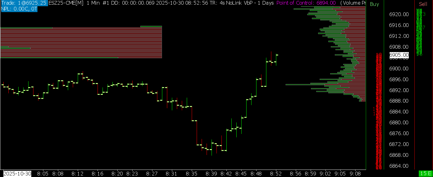

The way you are doing this is also the best option to get what you want.
With "Right Align Volume Bars" set to "Yes" and "Always Display Last Profile within View" set to "Yes", the RTH profile should be aligned to the far right of the graphics area. See the attached image of how it shows for us. If you are not getting this, then we would need to see an image of what you are getting.

So I noticed, during the "Day" session, the prior day's RTH profile, does get printed on the far right edge of the chart, as it should be. The attached image confirms that. But during evening session, this profile, doesnt get plotted on the right most edge, but further left..,before the end of the previous session. Instead, the prior day's evening session profile gets printed at the right edge of the chart. ( I dont have screenshot of this..,perhaps I could replay and capture that). They swap places, essentially..cluttering up the chart. I just need this evening session profile GONE (or atleast hidden)..How can we do that?
