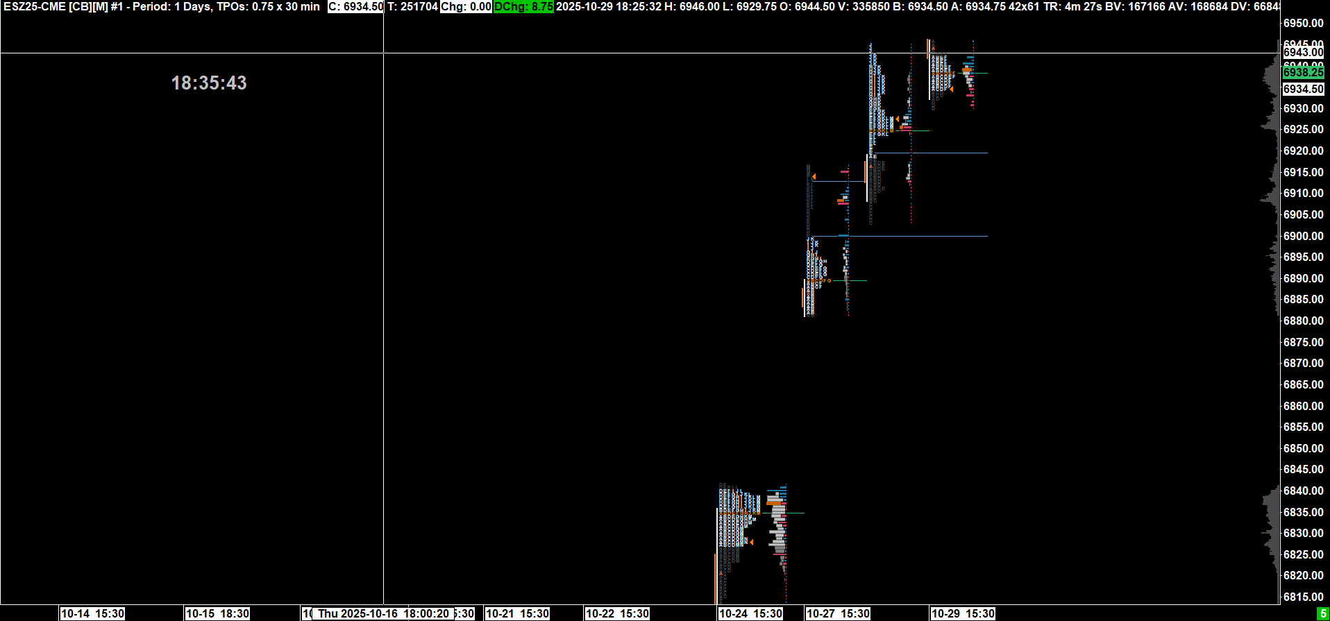

This is my view on es market profile cash today. There is an error downloading the market profile. It s not showing all the periods.
Thanx in advance
https://www.sierrachart.com/image.php?Image=1761591546432.png
imageScreenshot 2025-10-27 193119.jpg / V - Attached On 2025-10-27 18:36:53 UTC - Size: 191.45 KB - 181 views

I think i might have a problem with my values in my tpo chart. In think that in the last 2 days, after confronting with other members of sierra chart community i noticed that my value of poc, vpoc and IB high of yesterday cash session tpo are not the same. Can u check it?
Thanx
https://www.sierrachart.com/image.php?Image=176175934494.png

User135243 - Posts: 337
for me this looks like your charts are set-up using European time (and you've not changed the exact start-tiome for this week), so if you don't change it, there will be 1 hour difference, next week will everything be ok :)
[2025-10-30 17:46:25]
User226008 - Posts: 5
Ok I will wait until next week then. Thanx.
