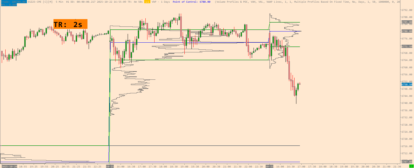

We are not seeing any issue with your chart. What we see is exactly what you are stating you should be seeing - the current Volume by Price profile is displaying the previous day's data and is not updating with the current bars. Attached is an image of what we see.
Is this occurring when running a replay or some other specific thing occurring, or even during regular chart updates?
imageESZ25-CME [C][M] 5 Min #1 2025-10-22 16~55~10.466.png / V - Attached On 2025-10-22 14:56:39 UTC - Size: 35.09 KB - 161 views

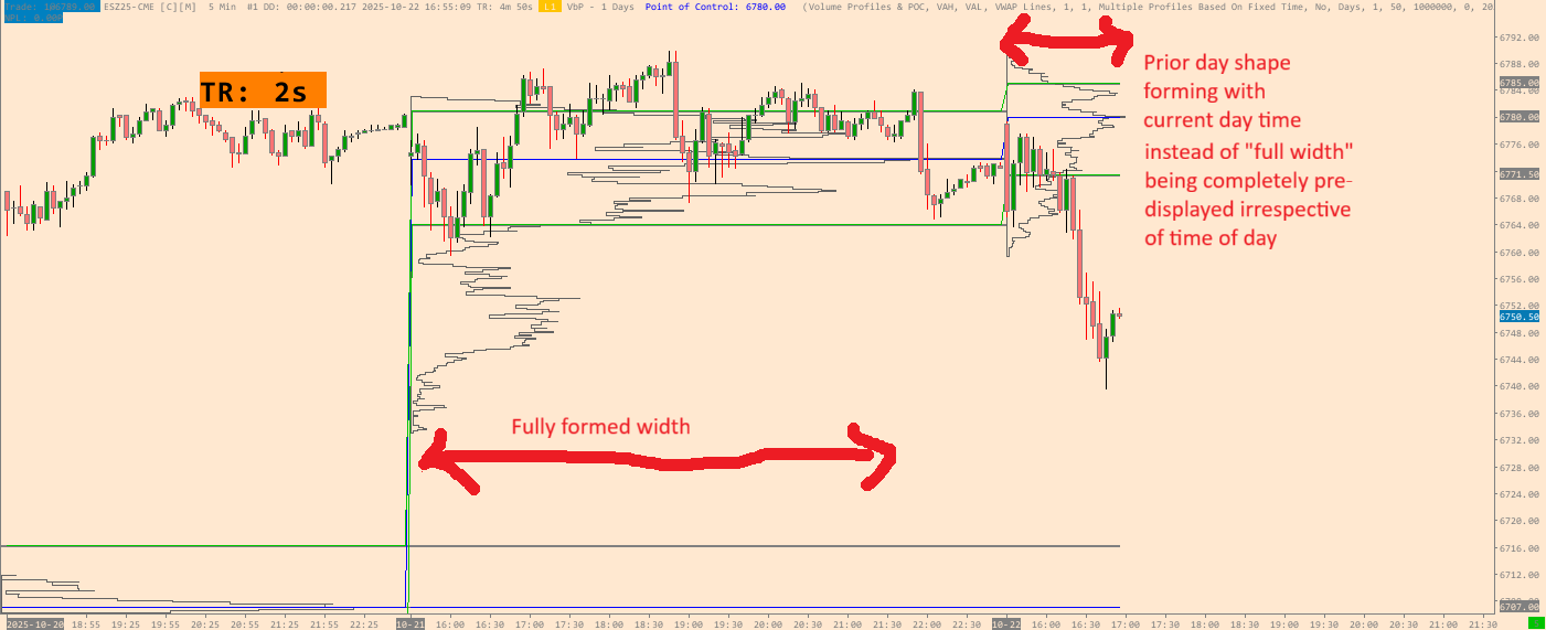

The current day is displaying previous day's volume profile data; that is not the point of contention. The issue is about how the data is being shown. I have attached an image with highlights and notes called "John_image_Highlight.png" - comparing a finished day's display of prior day profile versus an ongoing session's display of prior day profile.
Effectively, I am seeking a static displacement of fully formed prior day profile that is not dependent on current day's time to display its structure.
imageJohn_image_Highlight.png / V - Attached On 2025-10-23 09:54:12 UTC - Size: 69.54 KB - 196 views
[2025-10-23 17:04:54]
So this is about the Width of the profile itself, not the data within it?
In this case, this is how it is. The current day only exists in the bars up to that point. So displaying the previous day's profile in the current day is only going to show it in the size of the bars that exist at that time.
