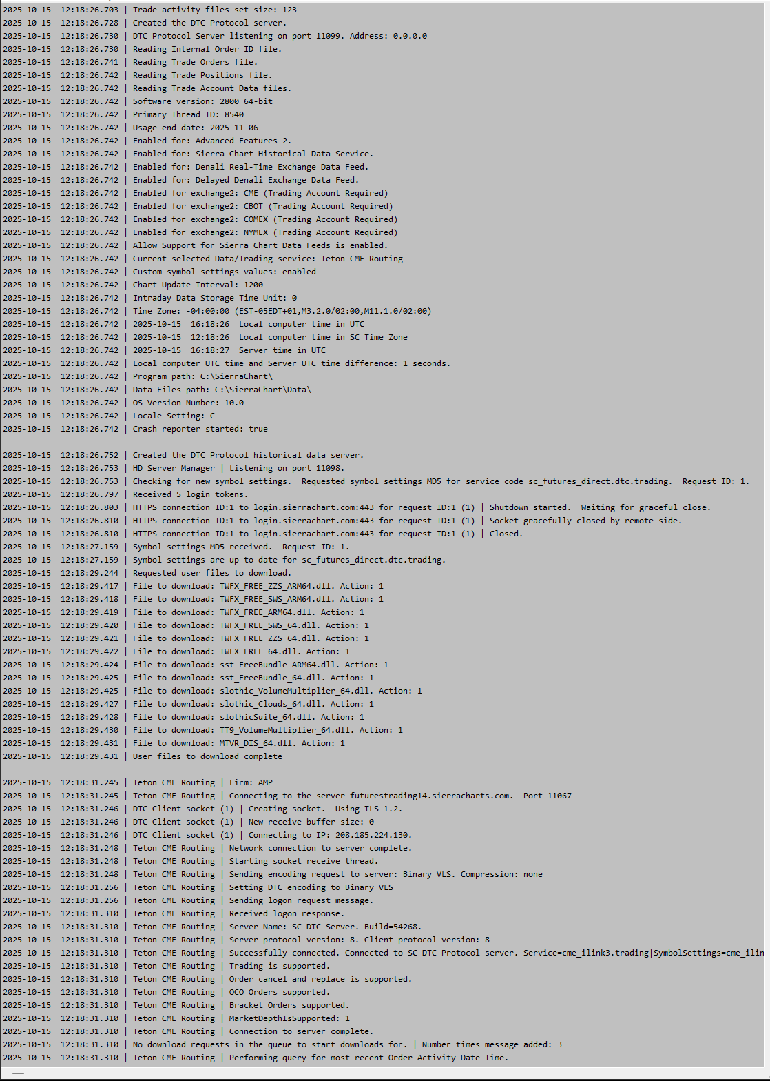

Sierra Chart Message Log Shows:
2025-10-15 12:04:53.254 | Created the DTC Protocol server.
2025-10-15 12:04:53.254 | DTC Protocol Server listening on port 11099. Address: 0.0.0.0

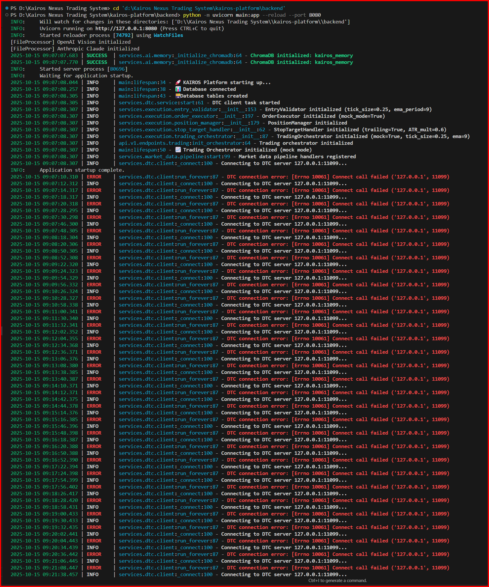

External Application (KAIROS Platform) Attempting Connection:
2025-10-15 09:07:08.307 | INFO | Connecting to DTC server 127.0.0.1:11099...
2025-10-15 09:07:10.310 | ERROR | DTC connection error: [Errno 10061] Connect call failed ('127.0.0.1', 11099)
Error Code: 10061 = Windows WSAECONNREFUSED (Connection refused - nothing listening on port)

imageScreenshot 2025-10-15 112142 -Sierra log.png / V - Attached On 2025-10-15 16:24:17 UTC - Size: 173.22 KB - 141 views
imageScreenshot 2025-10-15 092243.png - Terminal Log.png / V - Attached On 2025-10-15 16:24:26 UTC - Size: 627.28 KB - 225 views
[2025-10-15 21:56:36]
Sierra_Chart Engineering - Posts: 25481
Looks like a firewall on your computer is blocking the connection.

Thank you for the firewall suggestion. I've verified Windows Firewall has ALLOW rules for sierrachart_64.exe, so I don't think that's the issue, but I could be missing something.
What I'm seeing:
Sierra Chart logs this success message:
But when I check with netstat -ano | findstr :11099, there's no listening socket on that port. This happens with both the DTC Protocol Server (11099) and Historical Data Server (11098).

[2025-10-16 04:27:41]
To test the local DTC Protocol Server you need to run a new instance of Sierra Chart with File >> New Instance and if it connects, then the server is working.
