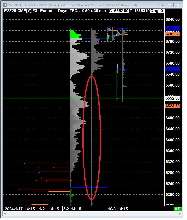

Hello, I am using the Volume by Price indicator based upo TOP chart. The Volume does not seem to print for the entire TPO chart. See attached.
Please let me know if you need additional information.

imageVbP for TPO Chart.png / V - Attached On 2025-10-13 19:56:46 UTC - Size: 73.57 KB - 169 views
[2025-10-13 21:29:22]
There appears to be something very wrong with your data, as the dates jump from 3-2 to 10-8.
Duplicate that chart and then remove the TPO and VbP studies from it. Check the underlying bars to ensure that you have the proper data, which we do not think you do. If you are missing data, then refer to the following:
