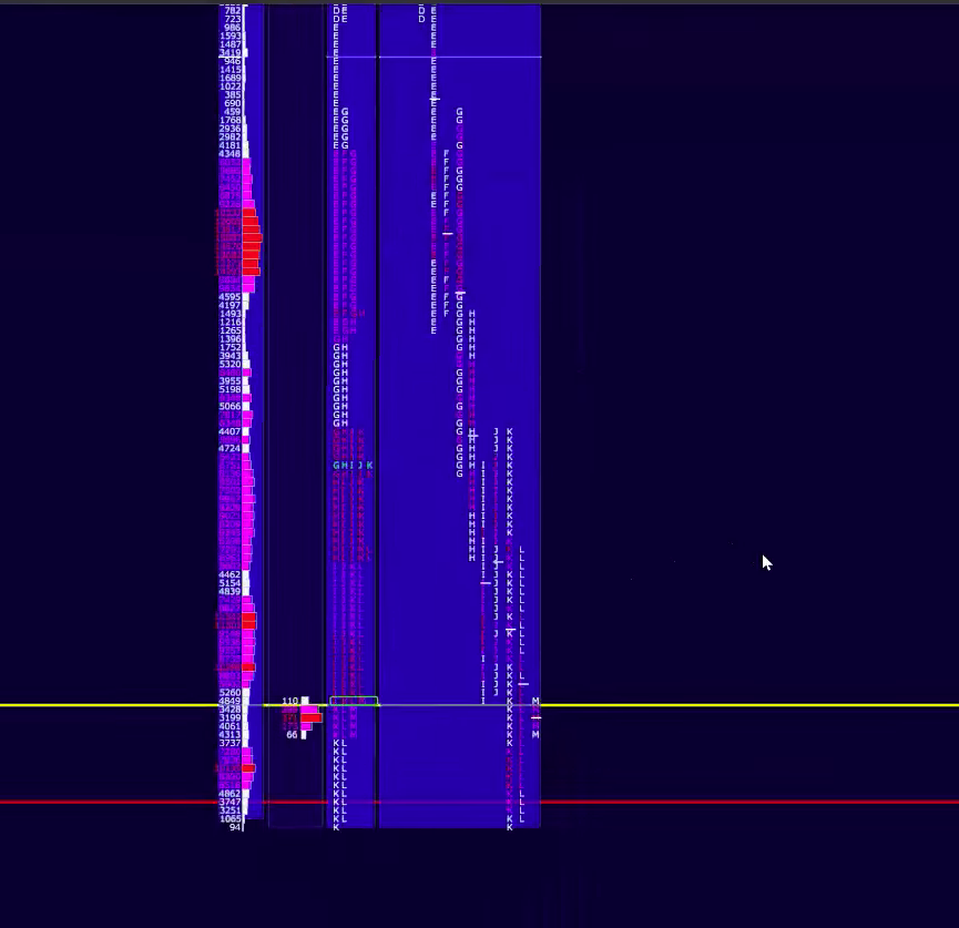

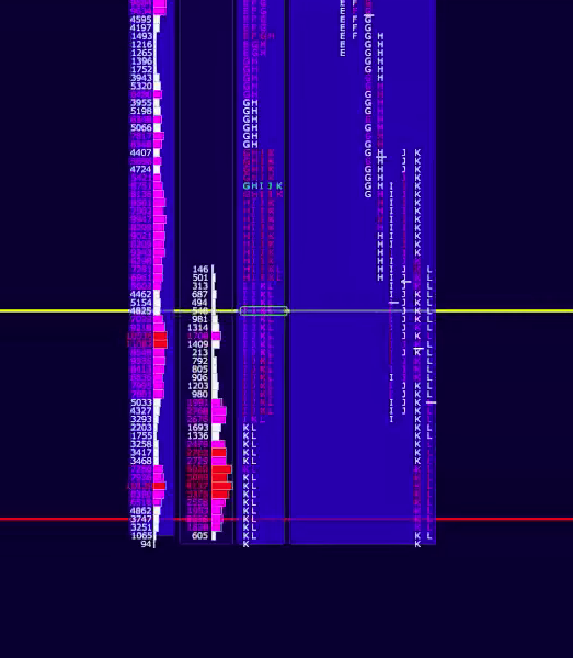

Hi, how can I place a line on TPO a 30-minute segment exactly in the middle? Like in the attached photo. And then another question: in the attached photo, you can see the value area (in pink), which seems to move, as it’s dynamic — this way I can better see how the value shifts. Is it possible to configure it like that? I’m not sure if I made myself clear.

[2025-10-13 18:03:04]
We are not sure what you are trying to do with placing a line. But in general you would just use the drawing tool that you want and place the line. If you are looking for something specific, then let us know what is not working as you want, or what you are trying to do.
With regards to the Developing Value Area, this is not available in the TPO study itself, as there is not a way to display it. But you can use a separate chart and use the "TPO Value Area Lines" study and set the Input for "Draw Developing Value Area Lines" to "Yes". Refer to the following:
