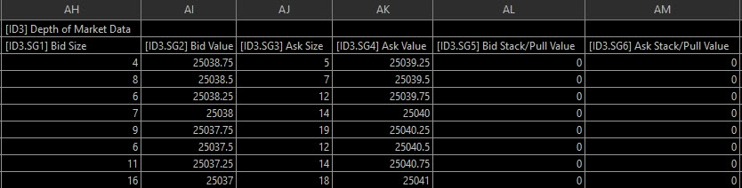

I've added a Depth of Market Study to a chart. I've also added a Spreadsheet Study to the chart. I've set the input "Do Not Output Subgraphs Set To Ignore" to No. In the spreadsheet the columns for Bid Stack/Pull Value and Ask Stack/Pull Value are all 0's. Am I missing a setting or input somewhere?

[2025-10-08 14:53:26]
"Do Not Output Subgraphs Set to Ignore" needs to be set to "Yes" in order to not display the subgraph information in the spreadsheet studies.

SpearChucker - Posts: 116
I tried that and also making those Subgraphs visible - Dash and no difference... still 0's.
[2025-10-08 16:22:46]
Are you wanting to display the information in the Spreadsheet, and your issue is why are they zeros?
If that is the question, then you need to add the "Pulling/Stacking" columns to the chart. The Pulling/Stacking data is not calculated unless it is forced to be by adding those columns.
That worked. Other than your reply, where could I have found that information? It wasn't in the Depth of Market Study Description.
[2025-10-08 19:37:41]
We have added information to the "Depth of Market Data" study documentation to clarify this. You can view this here:
Depth of Market Data: Description
