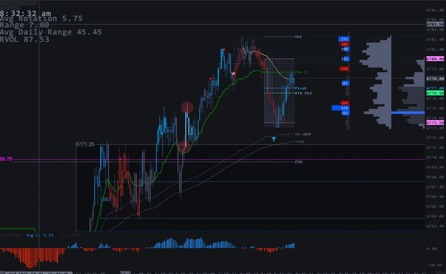

i have this issue with my volume candles on es. not nq. havent changed anything that i am aware of that would explain it. any idea what the issue is? thanks
imagemarkuphero-1udpAEvuOrUZzrwD4vVZ.png / V - Attached On 2025-10-02 13:35:33 UTC - Size: 611.48 KB - 253 views

What exactly is the problem, as we are not certain from the image.
[2025-10-02 17:16:02]
Sierra_Chart Engineering - Posts: 25481
Refer to this page:
Number Of Trades, Volume or Range Bar Charts Do Not Match Setting or Are Not Accurate or Are Inconsistent

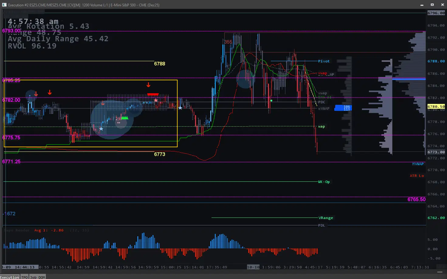

Hello. i have really gone through the page above. and i still have the issue. all my execution charts use volume bars and i have checked through each setting on these working charts. especially NQ which would have the same symbol settings as es. i just cannot figure it out. it mainly seems to be an rth issue. i am using 1200v bars for es. have you got any ideas at all at what could be the issue. thanks
imagemarkuphero-z3CBCNyVSft9cOORAppL (1).png / V - Attached On 2025-10-10 10:00:37 UTC - Size: 860.25 KB - 246 views

You have some study that is displaying those odd bars that you have within the rectangle. This is not a problem with the actual volume based bars that are being displayed.
Most likely it is a Study/Price Overlay, but you need to look through the studies on that chart and see which one is causing it.
[2025-10-13 13:23:52]
tickhead - Posts: 28
Thank you. have found the culprit.
