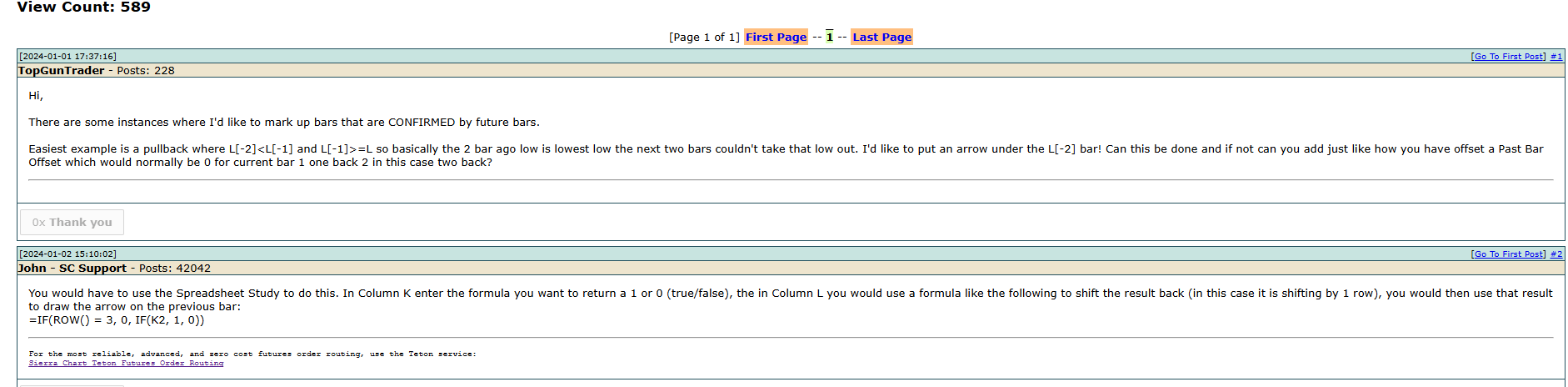

i am trying to do something like this
imageScreenshot 2025-09-26 175842.png / V - Attached On 2025-09-26 21:59:47 UTC - Size: 44.77 KB - 148 views
[2025-09-29 14:22:51]
We need to know exactly what it is you are wanting to accomplish. We can then help you further with this. The reference to the other post does not help us, as that is about putting a marker on a bar 2 previous to the current bar. You state you want something like that - but what exactly are you wanting?
