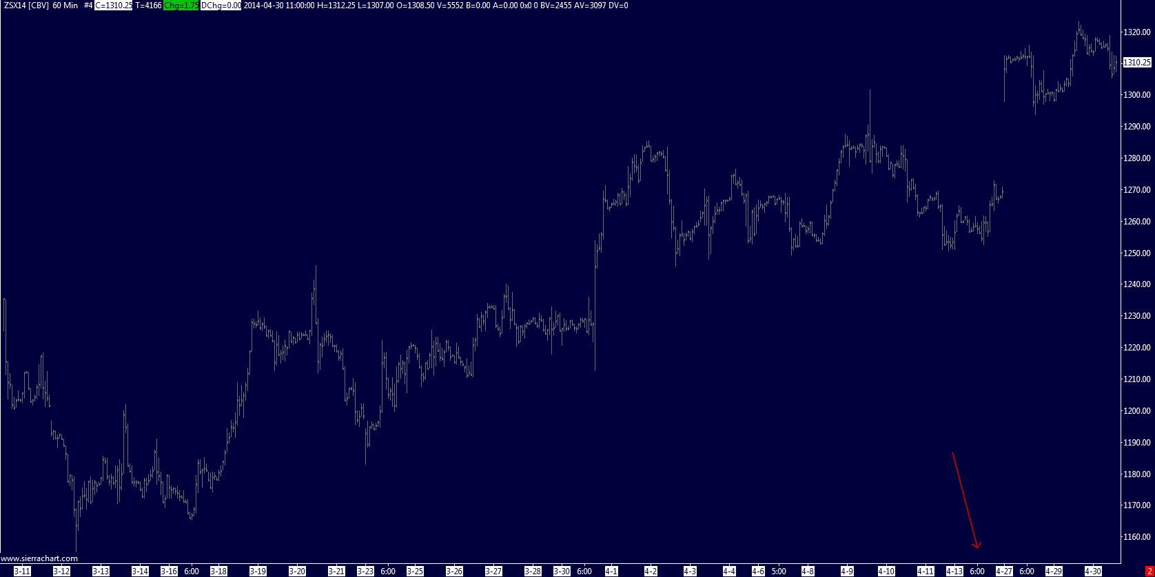

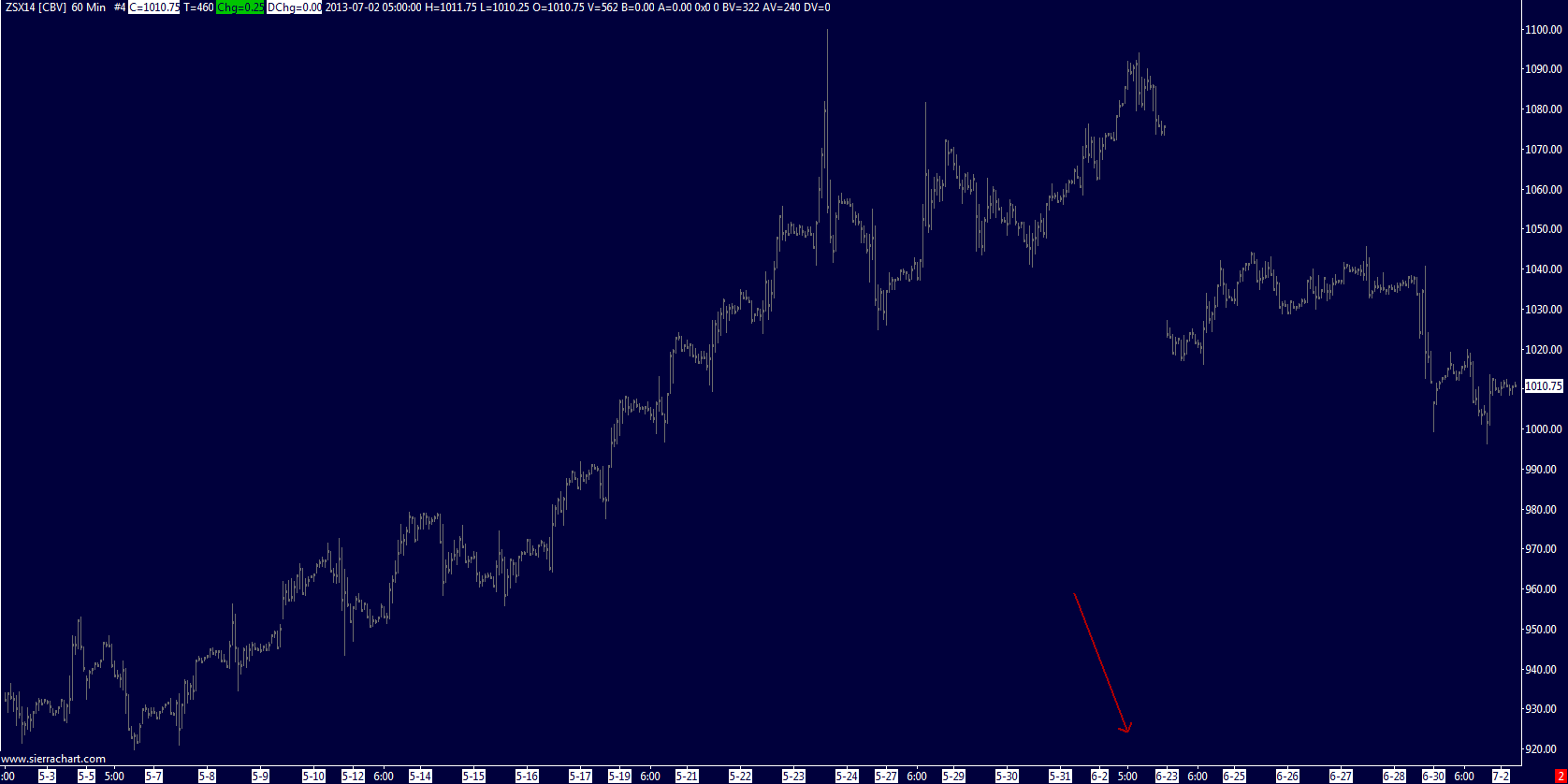

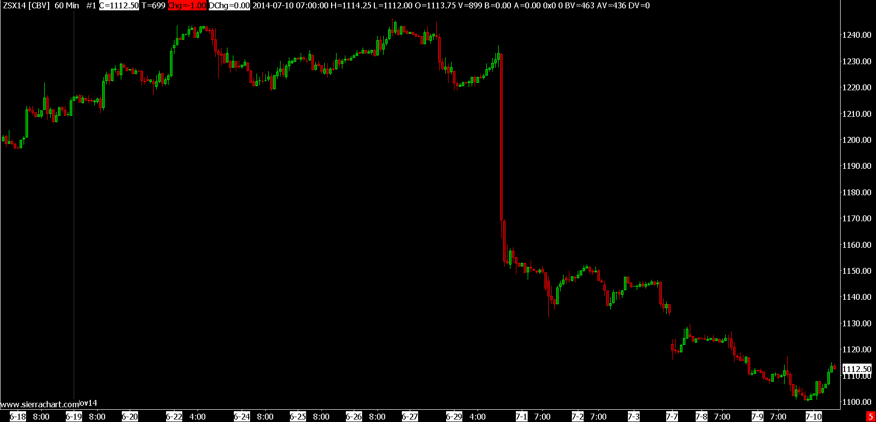

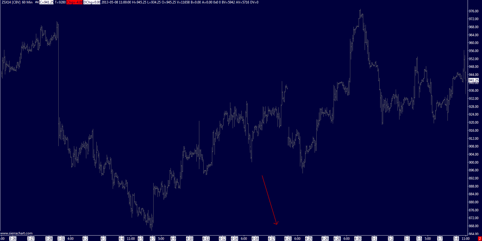

i don't have some data in ZS intraday chart when i use SC historical data service. (i have attached images)
I have did edit>delete all data and download but the problem remains.

[2014-10-12 19:14:54]
Follow the instructions here:
http://www.sierrachart.com/index.php?page=doc/doc_ContinuousFuturesContractCharts.html#ReDownloading
It was only necessary to post one image.

[2014-10-13 19:42:04]
And tell us the exact steps that you followed in response to the instructions that we gave you.
We see no problem with this:
http://www.sierrachart.com/image.php?l=1413229313607.png
Also, there is no need to post any further images.
