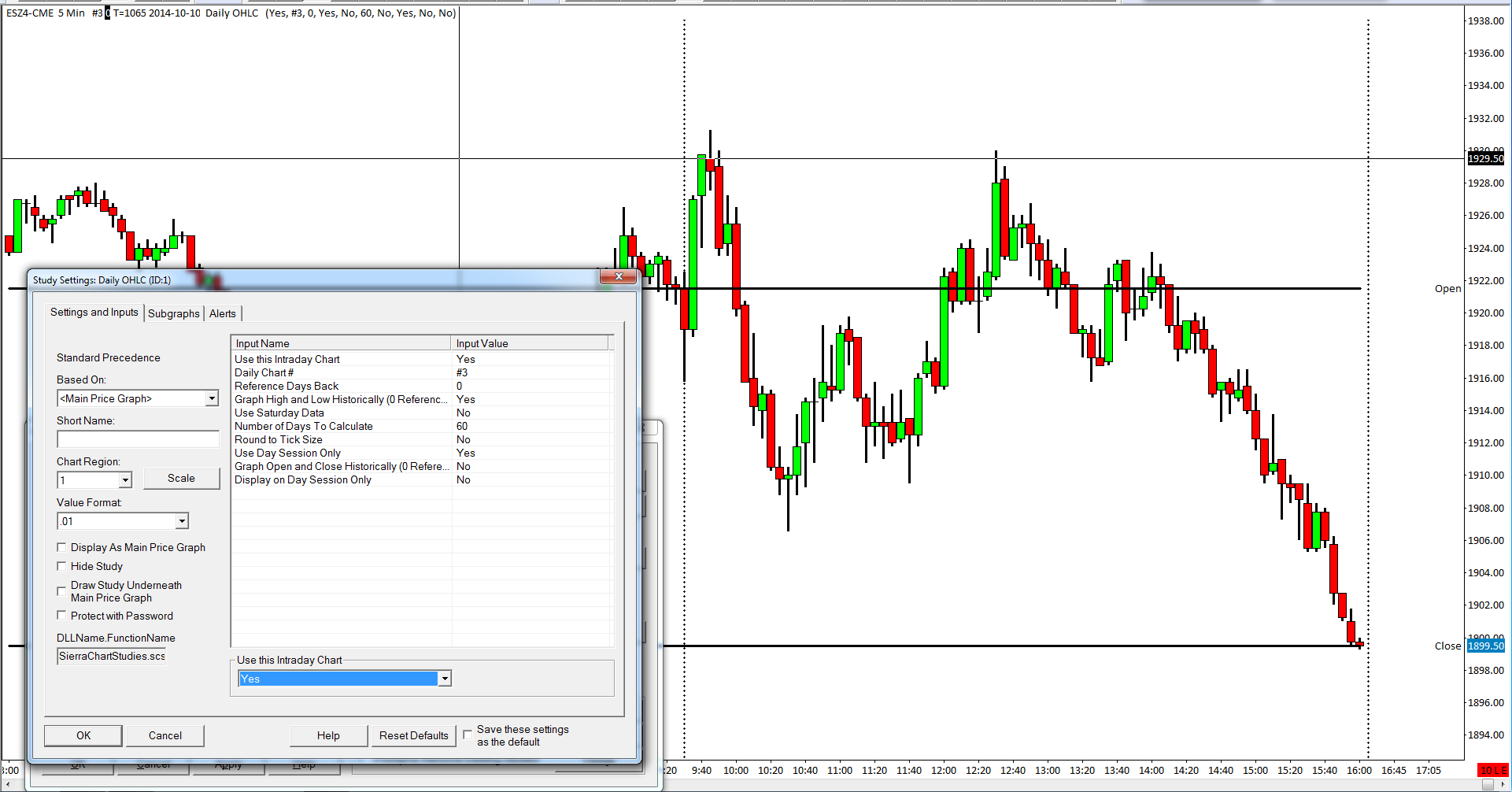

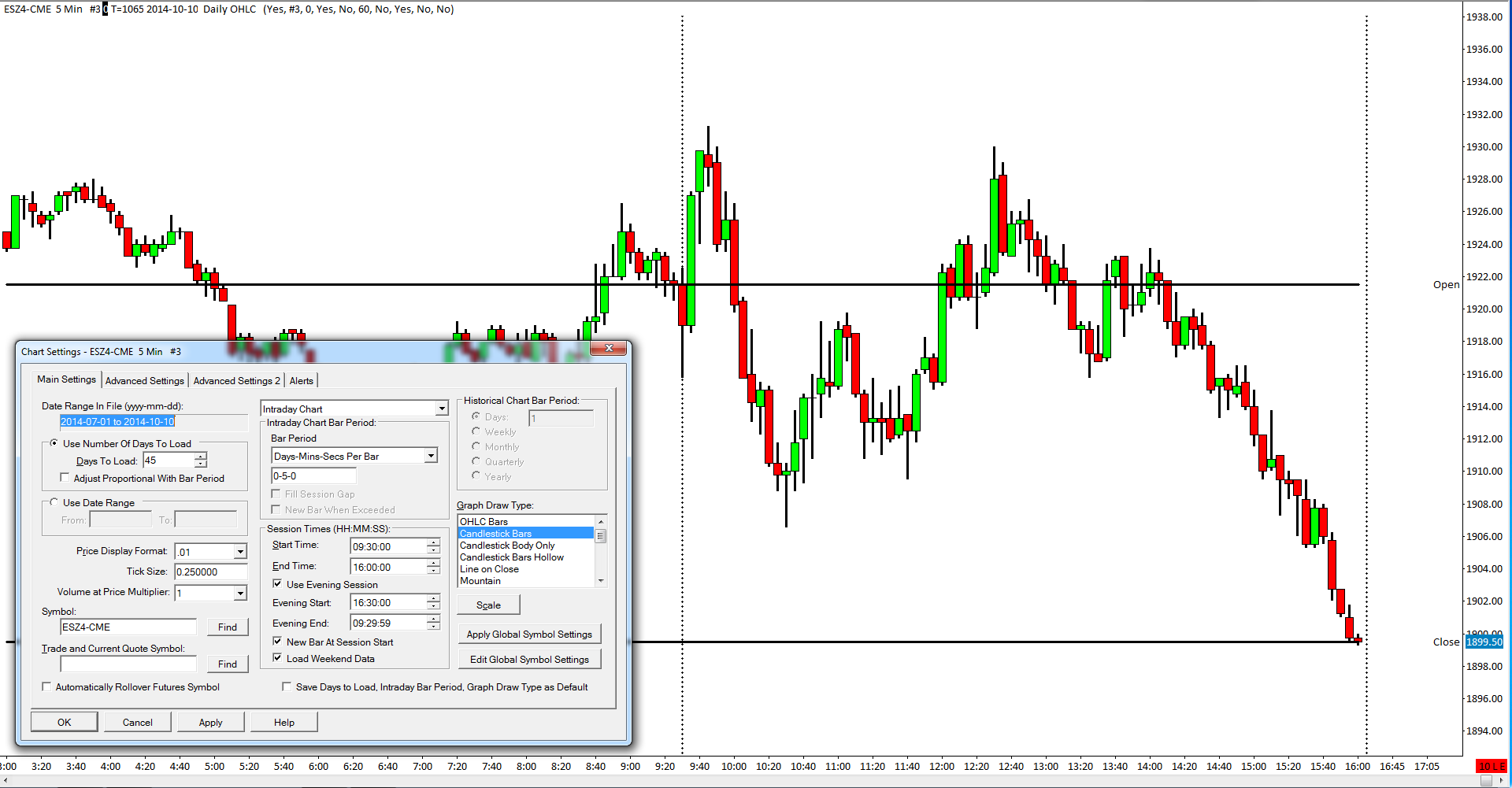

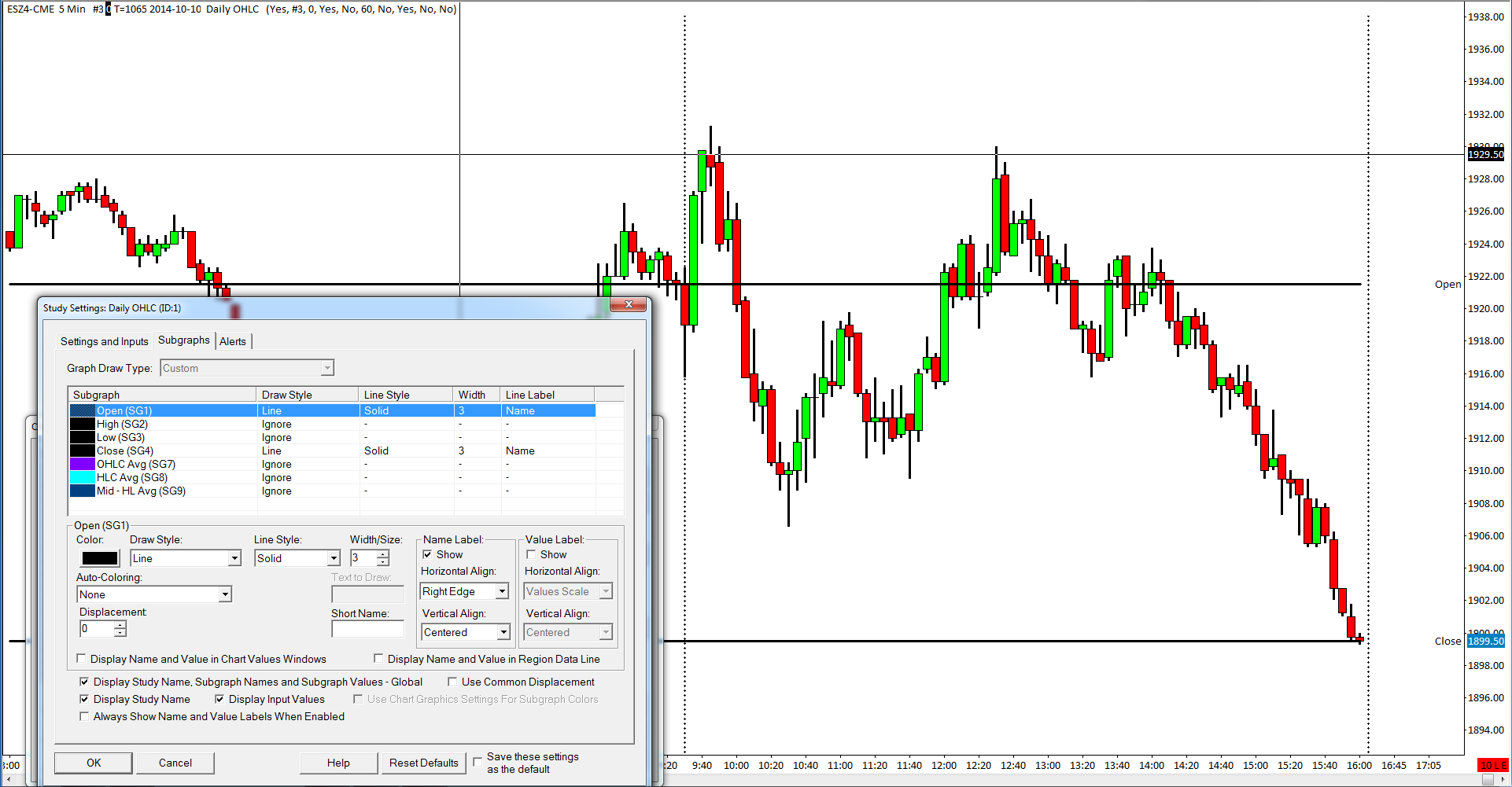

I am trying to have the Daily OHLC study display the NY equities trading session 0930 EDT to 1600 EDT Open and Close as horizontal lines on my Emini ES chart.
I cannot seem to get this to occur. Help please.
[2014-10-12 11:49:22]
Zosimus - Posts: 345
Take a look at the attached images.
image2014-10-12_1445.png / V - Attached On 2014-10-12 11:48:26 UTC - Size: 125.77 KB - 480 views
image2014-10-12_1446.png / V - Attached On 2014-10-12 11:48:39 UTC - Size: 120.19 KB - 512 views
image2014-10-12_1447.png / V - Attached On 2014-10-12 11:48:49 UTC - Size: 134.2 KB - 523 views

Thanks for the info. So the trick is to set the chart stop times to get it to work. I got it working now.

If you want the Daily OHLC - Single Point study to reflect 24 hours then in the settings and inputs of the study change "Use Day session Only" to "No".
