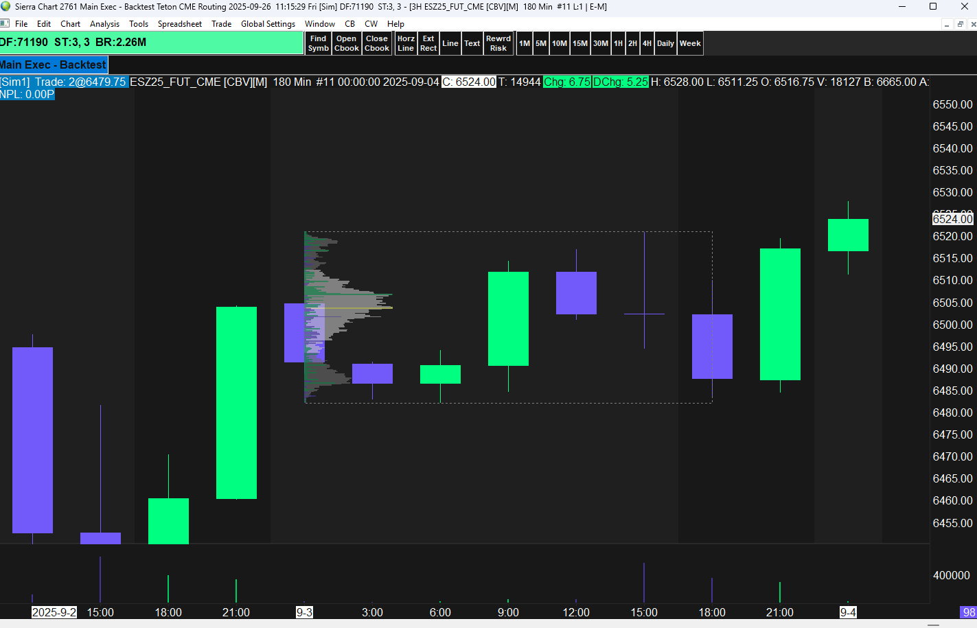

with flexible/drawn volume profiles and a delta profile added, many delta bars appear to have a fixed size and don't scale, especially on higher timeframes (e.g., 3-hour, screenshot). Large deltas stand out, but smaller ones look equal and obscure the volume profile beneath. I see the same β€” though less pronounced β€” on lower timeframes.
Any ideas how to fix this?

imageScreenshot 2025-09-23 103025.png / V - Attached On 2025-09-23 08:36:12 UTC - Size: 67.98 KB - 374 views

Sorry for the delay. This was something we have not looked at in awhile.
There really is nothing wrong. There is a minimum 3 pixel size, for which any volume that would draw less than this is set to 3 pixels and then multiplied by the overall multiplier for that profile. Therefore, with a lot of smaller values falling into this category, when the data is multiplied out, it appears in this manner.
