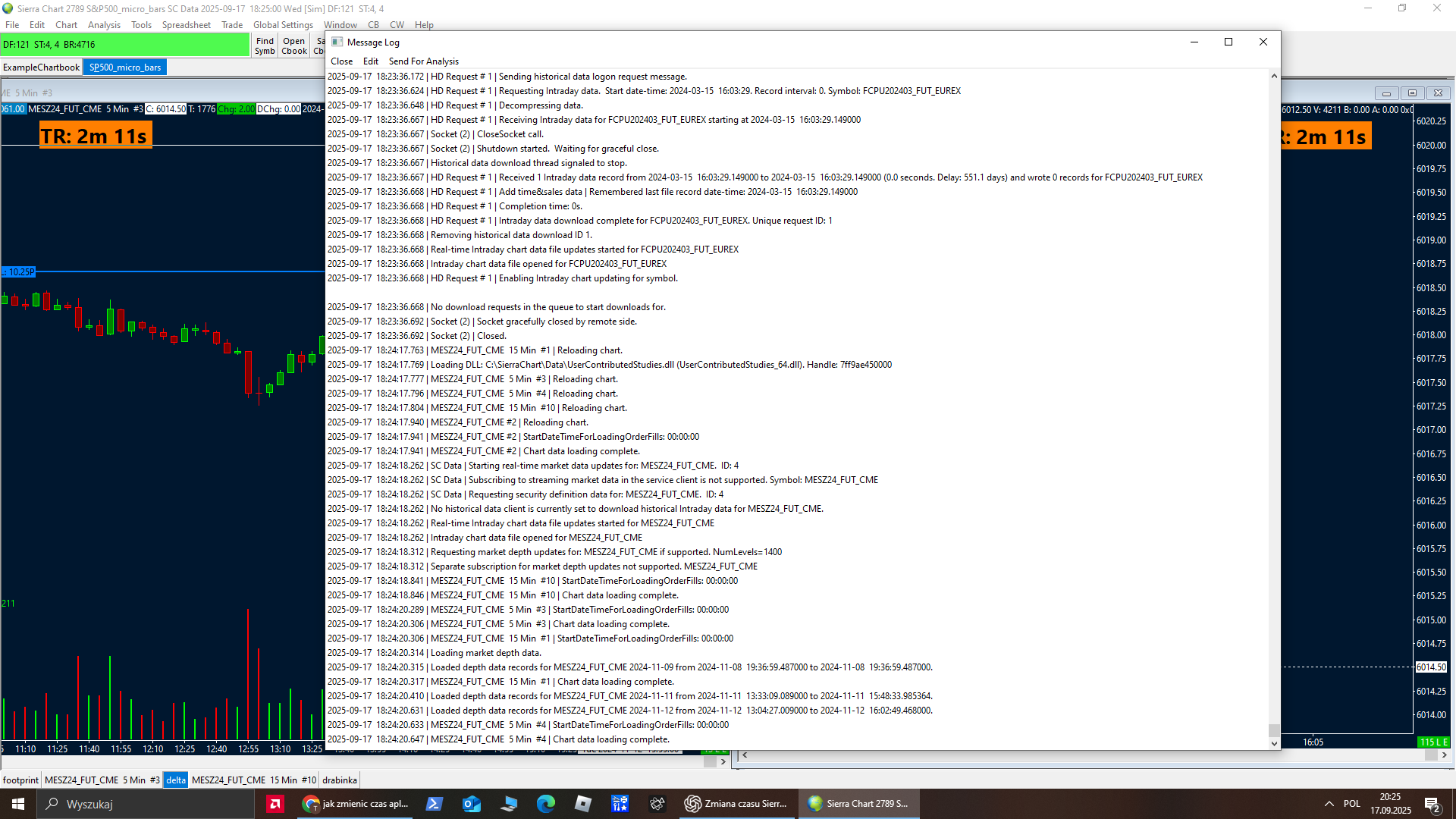

SP500 doesn't load historical data, it's always on the 2024 period. It only works if I go to trade service settings and switch to any data and then back to SC data. The problem only occurs on SP500, rollover is enabled.

Keep your service set to "SC Data". Do not change this.
You have the wrong symbols for your charts for "SC Data". With the service set to "SC Data" and your chartbooks open, select "Edit >> Translate Symbols to Current Service".
This should resolve your issue.
