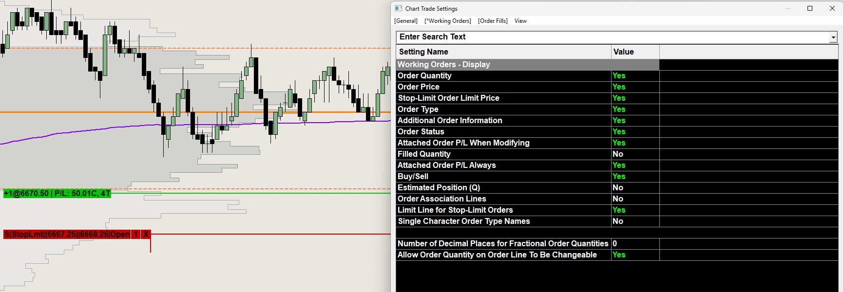

Hello, I've gone through a couple threads to find certain settings need enabled. I've enabled those settings and my stop limits still do not show expect loss, and my limit orders do not show expected gain.
imagesc.jpg / V - Attached On 2025-09-15 18:18:39 UTC - Size: 222.21 KB - 254 views

An attached Stop Limit order should be showing the Profit/Loss per the settings you have set.
But, if that Stop Limit is a separate order, then it will not show any Profit/Loss until it is filled.
Is that a separate order and not an attached order?

Hello John, I'm not sure if it is seperate order or not. I'm marketing in using right click and setting the stop using right click.

It is a separate order then, as you did not setup that Stop as a Stop Order as part of the parent.
If you want to see the Profit/Loss, then we would recommend setting that Stop-Limit as an attached order with the parent. You can set it far away at first, and then move it to where you want it to be later.
