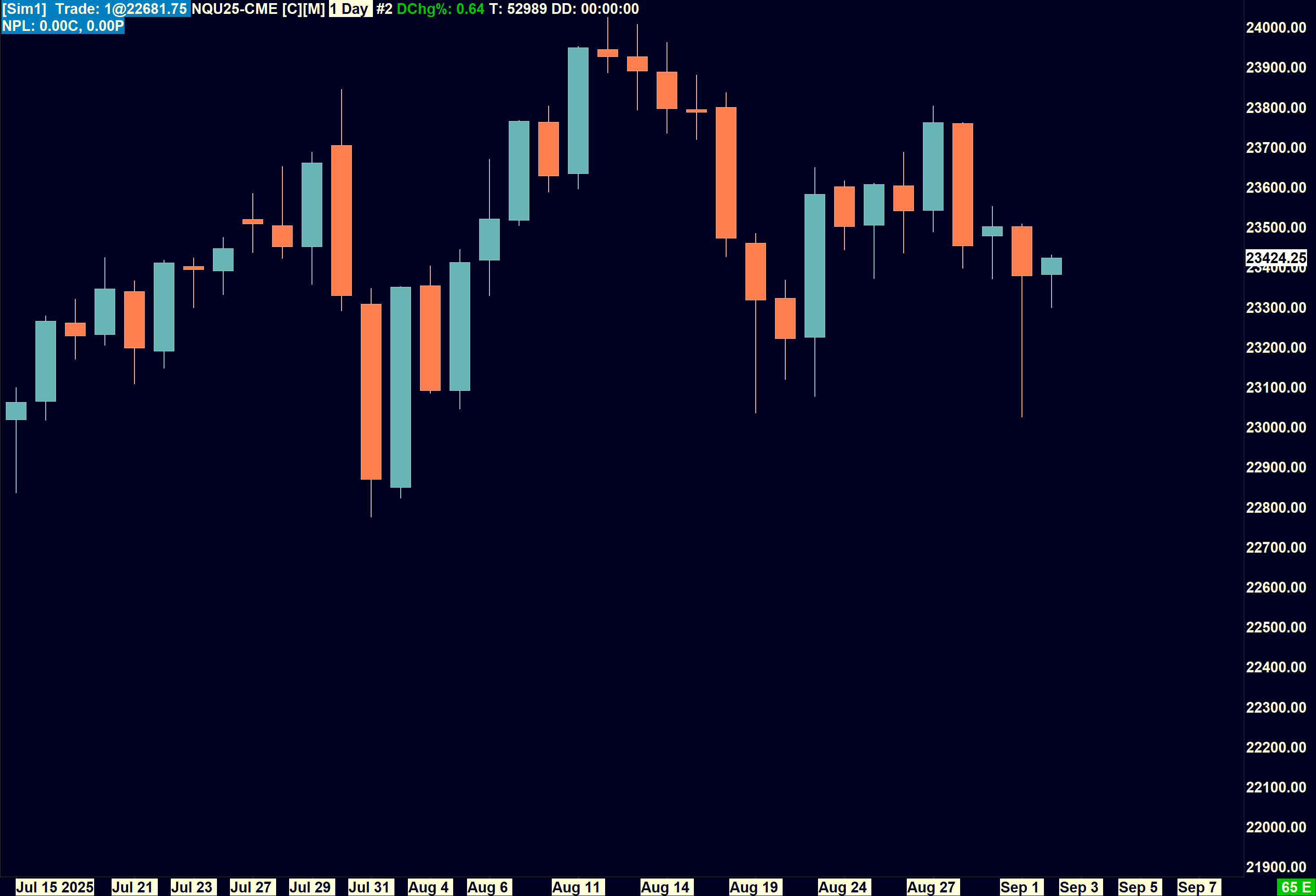

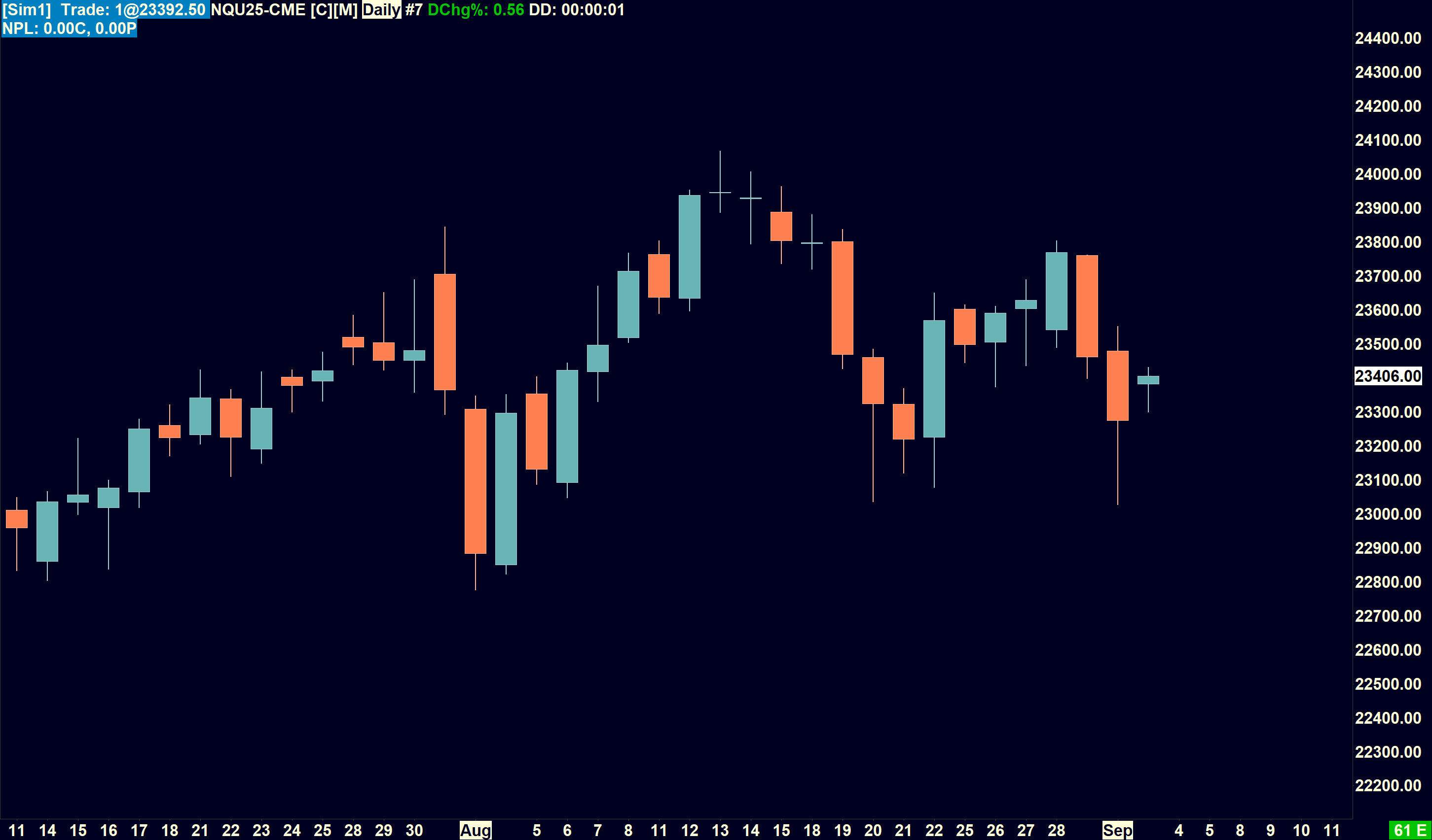

Please can you tell me the correct way to configure the intraday-based daily chart to match the historical-based daily chart, specifically with bars matching during holiday periods?
The screenshots show that the intraday-based daily chart contains an extra bar for the Sunday / Monday half session on 08/31 - 09/01 .
This is causing significant issues with the Pivot Points daily Study, which I am using for algo back testing.
My objective is to have accurate pivot points for historical backtesting.
-- Compare last 2/3 bars on the charts below --

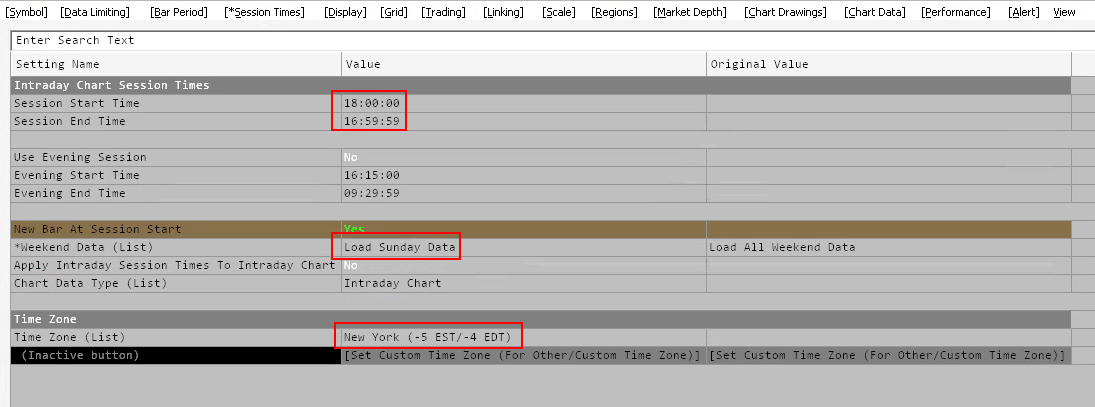

See the attached screenshot for the session settings you should use on your intraday-data-based daily equivalent chart (1-0-0). These are the settings SC support recommended a long time ago. They will automatically merge the Sunday evening session with Monday’s bar and produce historical daily-equivalent charts.
However, there are still two issues that cannot be resolved:
- The close price of historical daily data is always the settlement price, except for the current developing bar.
- On holidays, when there is an early halt, there is usually no settlement. Because of that, the partial short session will be missing from the historical daily data. The data will be merged with the next session’s data, but no individual bar will appear on the chart for that short session. So the intraday data based daily chart will have an extra bar.
Hope this helps.

I can confirm my session times are the same as yours, and I still see the extra bar on the intraday ("daily bar") chart, as you have described this expected behavior.
