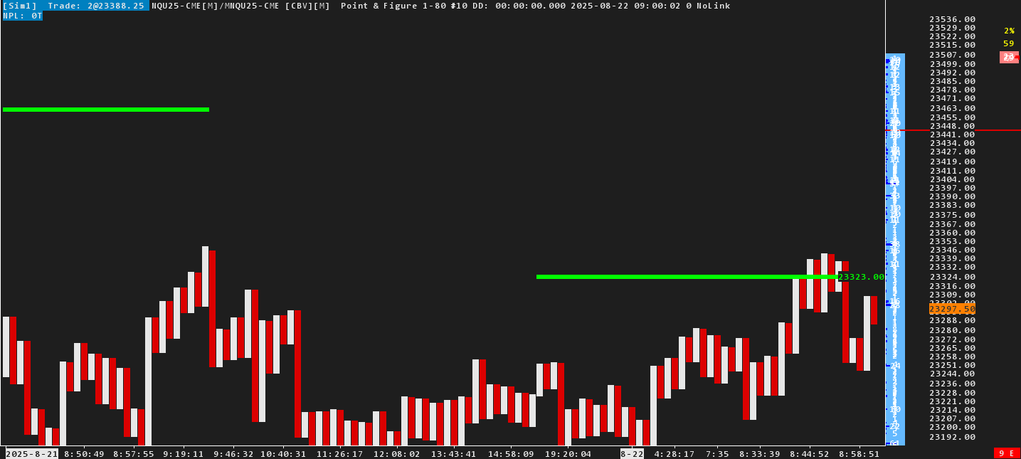

I have an issue with my NQ chart where the Daily OHLC study (used to draw the Opening Print line) is not showing.
The chart is a Footprint (Numbers Bars). I am using the same study template that works fine on other products (ES, YM, etc.), but on NQ the Opening Print line is not visible. The only difference I can identify is that in Chart Settings > Chart Data, I have Volume at Price Multiplier for Intraday Chart set to 4.
Could this multiplier setting prevent the Opening Print from displaying?
Or is there another setting I should check to ensure the study plots correctly?

We are not seeing any issue with the "Daily OHLC" study that has a "Short Name" of "Opening Print". We removed all the other studies and increased the width of the line and the attached image is what we get. The line goes from 17:00 to 09:30, which is what you have set for the Day Session, which is what you have specified to use in the study Inputs.
imageNQU25-CME[M][MNQU25-CME [CBV][M] Point & Figure 1-80 #10 20.png / V - Attached On 2025-08-25 21:19:32 UTC - Size: 56.81 KB - 260 views

That's my bad. I have not realized that the Day session was inverted with the ON session.
Reverting to the right session time settings, it works
