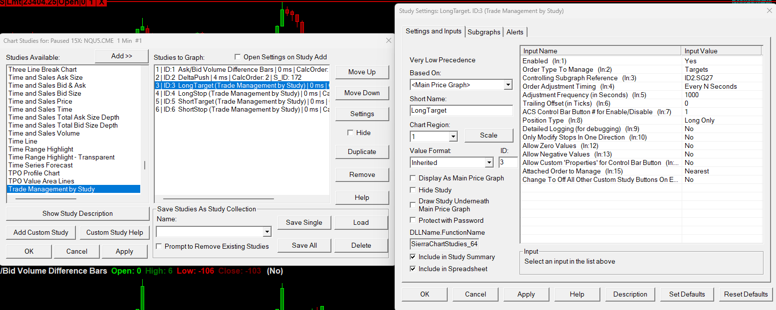

User827002 - Posts: 47
I just updated to version 2784 and my trade management by study is no longer working. All the settings are the same, the spreadsheet it references is the same, and I've tried rebuilding it and reloading and recalculating the chart with no luck. I've attached a screenshot to show my TMS settings if that's helpful.

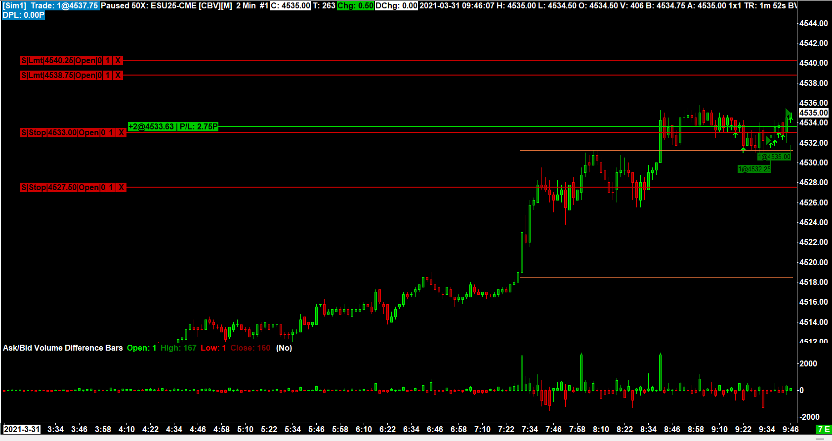

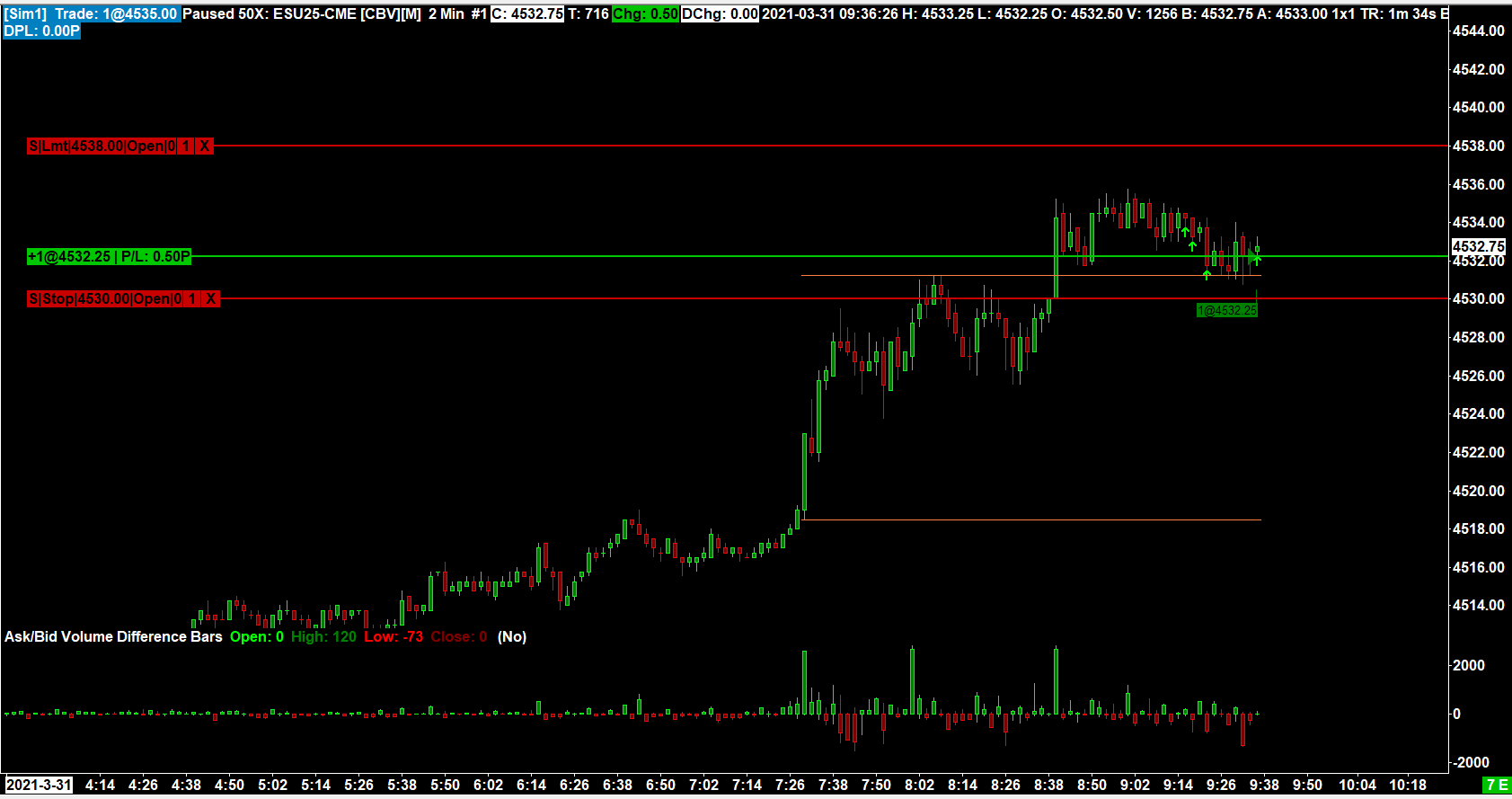

I've attached two files to show you the issue I'm having. In the first image where I have one open trade the target and stop are both correct. At the time that I enter the second trade in the next screenshot, the cell that TMBS references for the target shows 4540.25 and for the stop it shows 4533.00. I want it to keep the old target at 4538.00 from the prior trade, have the second target at 4540.25, and keep the stop at 4530.00 from the prior trade and have the most recent stop at 4533.00.
I believe the option you're talking about should work, but it's not currently doing what you're saying. I've made sure to update Sierra to the latest version, but when I add 1000+ seconds to the time it still just maintains whatever target and stop is set in my trade window, it doesn't update first. Let me know if there's something I need to do to enable that option you've added.
