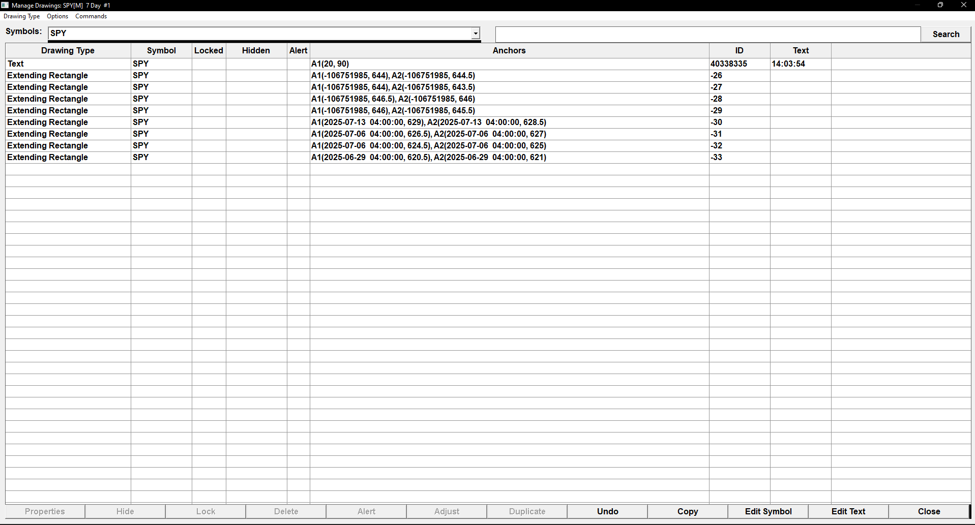

[2025-08-19 17:27:17]
Please reproduce this and then get us an image of the "Manage Chart Drawings" window showing that rectangle. Make sure that we can see all the information for the "Anchors" that are part of that window.
[2025-08-19 17:57:44]
User330721 - Posts: 8
I’ve attached a screenshot of my "Manage Chart Drawings" window. Only the top 4 rectangles are showing on the chart.
After messing around with the tool it seems the Extending Rectangle tool is only working partially — rectangles placed after the most recent weekly candle display on the chart, but those placed before it don’t appear on the chart (though they do show in the "Manage Chart Drawings" list). Also, the tool is double-extending by default, even though “Double Extend” is set to “No.”

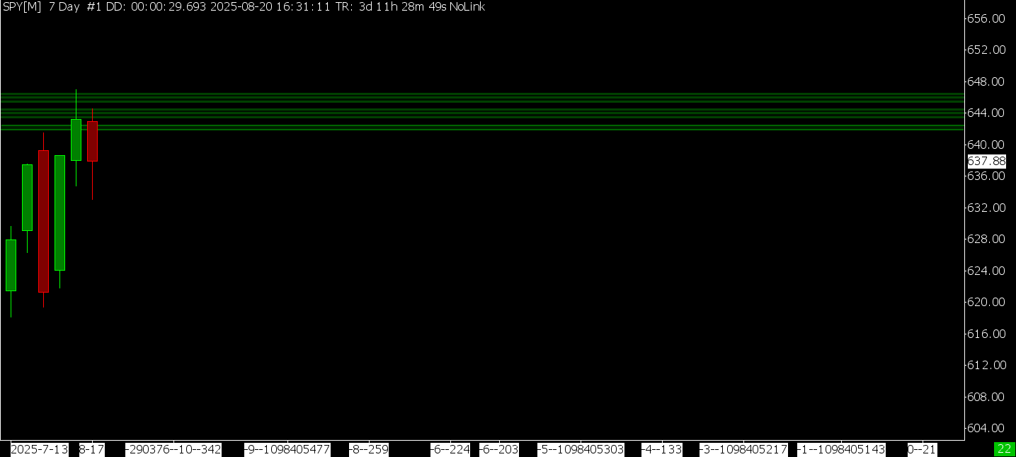

[2025-08-20 20:33:06]
There is something wrong with that weekly chart. Note the dates forward from the last bar and how they are not showing properly in the image we have attached.
The only thing we can recommend is to start a new chart and build it up to match what you have with the one that is not working and then delete the one that is not working properly.
imageSPY[M] 7 Day #1 2025-08-20 16~31~41.133.png / V - Attached On 2025-08-20 20:33:03 UTC - Size: 22.72 KB - 286 views
