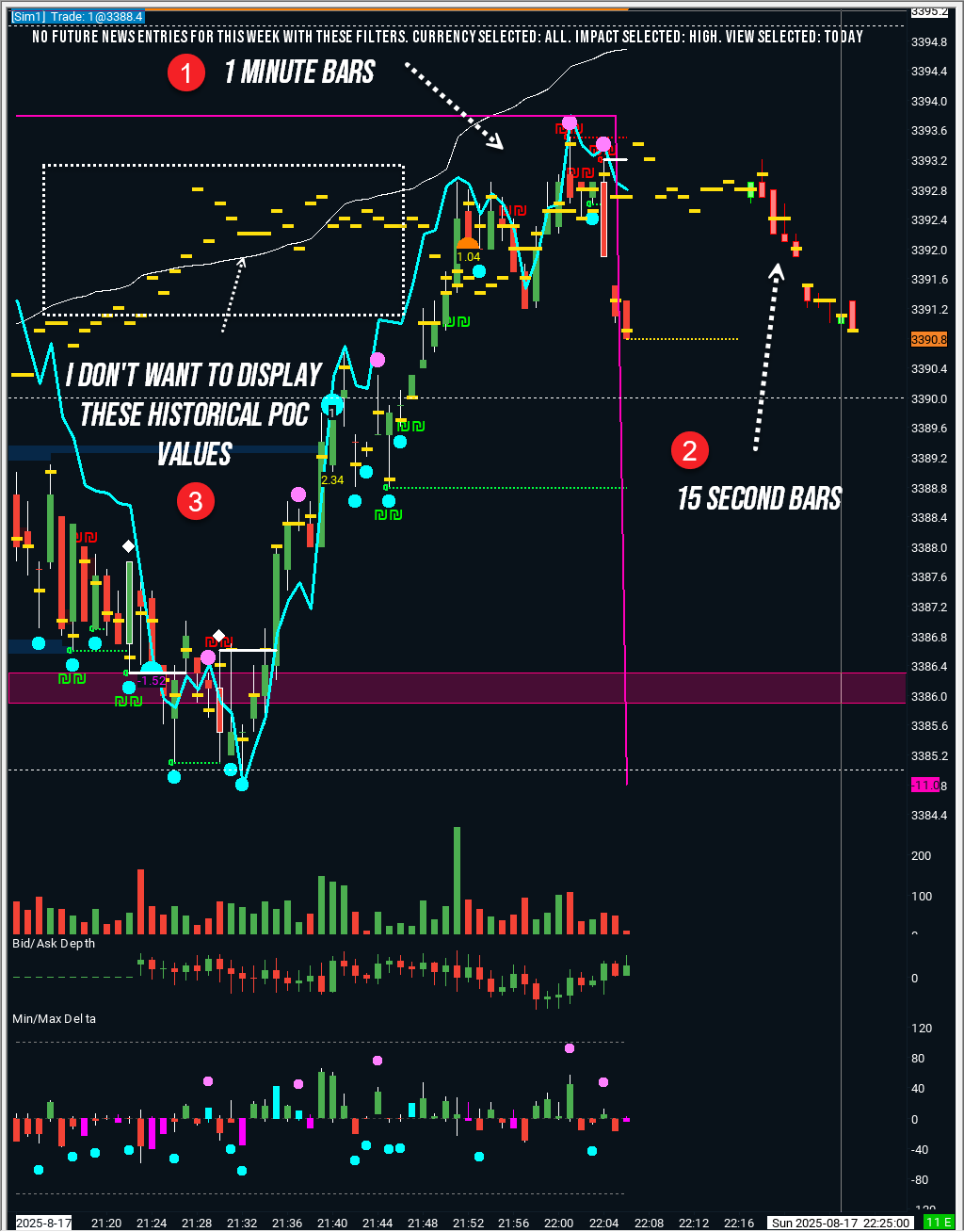

I was wondering if it was possible to overlay another chart on a lower timeframes' Volume Point Of Control For Bars while also limiting the number of bars to overlay.
1. I overlayed a 15 second chart to my 1 minute chart using Overlay Non-Sync which has the "Number of bars to overlay" I set it to 10 to get the latest 10 values
2. I used the Study/Price Overlay to overlay Volume Point Of Control from the 15 second chart
Now I would like to plot only the last 10 bars of the 15 second timeframe Volume Point Of Control on my 1 minute chart
Thank you!

The only way to not show the data prior to the current 10 bars would be to use the "Color Bar Based on Alert Condition" study in order to color the Point of Control prior to the time you want to be the same as the background so you will not see them. Refer to the following:
