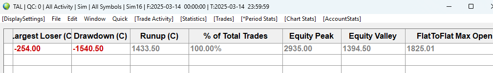

My system tracks the PnL and Max PnL via below:
  n_ACSIL::s_TradeStatistics TradeStatistics;
  if (sc.GetTradeStatisticsForSymbolV2(n_ACSIL::STATS_TYPE_DAILY_ALL_TRADES, TradeStatistics))
     pnlTotal= TradeStatistics.ClosedTradesProfitLoss;
     tradePnL= TradeStatistics.LastTradeProfitLoss;
     maxPnL= TradeStatistics.MaximumRunup;
These values are stored in subgraphs and used for risk management purposes.
I noticed that the TradeStatistics.MaximumRunup isn't retaining the intraday maximum runup of which is circumventing my risk management system.(e.g. intraday drawdown 3x threshold)
The TradeStatistics.ClosedTradesProfitLoss is at times greater than the TradeStatistics.MaximumRunup.
The attached screenshots display the issue. In the second the Equity Peak is listed as $2935 but the MaxPnL listed in the first screenshot is $1437.50 of which is smaller than the PnL (i.e.ClosedTradesProfitLoss);
Can someone advise concerning this? Thanks
imagePnL Error.png / V - Attached On 2025-08-16 07:14:07 UTC - Size: 6.41 KB - 325 views
imagePnL Error 2.png / V - Attached On 2025-08-16 07:14:13 UTC - Size: 19.53 KB - 304 views

[2025-08-16 16:48:22]
Gradient - Posts: 219
My code isn’t doing anything other than taking those values and storing them in subgraphs.
The output of those subgraphs are visible via the screenshots.
There is no issue with my code as I have shared the extent of the code relative to those values in the prior post of which is in the documentation.
There is no manual computation of PnL.
[2025-08-16 16:50:54]
How can the TradeStatistics.MaximumRunUp differ from Equity Peak? That’s not a side effect my code would even be able to produce.
[2025-08-16 16:57:21]
I physically watched a PnL of 60pts which aligns with the Equity Peak. Then watched the Max PnL decrement from that value which is why I investigated because if TradeStastics.ClosedTradeProfitLoss drops below a certain threshold of TradeStastics.MaxRunUp my system stops trading.
It didn’t stop.
Then I noticed MaximumRunUp was incorrect and less than CloseTradesProfitLoss.
This is how the error was identified.
That has nothing to do with my code.
[2025-08-16 17:04:24]
Sierra_Chart Engineering - Posts: 25481
This is not within the scope of our support and under no circumstances will we spend any time on this. This is just not within the scope of our support. And the definitions for all of these, is documented here:
Trade Activity Log
And you also have to understand, whether you are using the Flat to Flat Trade Statistics as well because the calculations change for some of the variables.
And another thing you do not understand is we cannot accept anything that you say. All of this has to be deeply analyzed, with the actual sequence of fills and the actual fills. This is just not part of our support at all.
And we do not know what you are saying is right or wrong because we have to look at the definitions. We have to look at the sequence of fills. This is not within the scope of our support.
These posts, are immediately rejected by us. And this is our standard policy:
Trade Activity Log: Questions About the Trade Activity Log Data
Date Time Of Last Edit: 2025-08-16 17:05:05
[2025-08-16 18:01:48]
We are going to make some changes, and write up a post about this. The functionality does function as documented but the field names, and the implementation is inherently confusing.
We will put a link to the post here when done.
Date Time Of Last Edit: 2025-08-16 18:02:07
[2025-08-16 18:21:11]
See our post here:
https://www.sierrachart.com/SupportBoard.php?ThreadID=24897&Page=Last#P423378
[2025-08-29 18:32:52]
We have released the changes. They are in the latest prerelease but we are not sure if there will be any functional differences because we did no comparisons to the previous implementation for these fields (listed below). We simply reimplemented them, and tested to make sure they function correctly. And they are also logged at every closed Trade as well and can be seen on the Trades tab of the Trade Activity Log window. So there is no guesswork, as to how they are arrived at.
Equity Peak and Equity Valley terms are no longer used. These are the new field names:
Highest Running Profit
Lowest Running Loss
Runup and Drawdown (also reimplemented but no change in names)
Date Time Of Last Edit: 2025-08-29 18:37:02

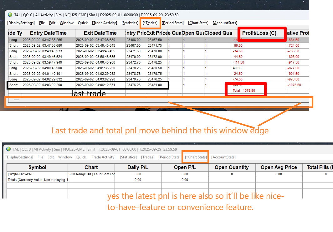

Lowry BigEarth - Posts: 51
How to keep the last trade and total PnL visible on TAL > trades tab without scrolling and readjusting the right side scroll ribbon? I and Gemini also, did not find much instructions from help docs.
Thank you.
[2025-10-01 14:59:19]
You can adjust the locations of the columns in the Trades tab of the Trade Activity Log. Just right click on a column header and then move it to where you want it.
[2025-10-01 16:56:03]
yes, that I found. But the last trade and total pnl keeps moving / hiding behind the edge of the window... I dont see it as an error, but might be as a feature request...
Thnx,
L.
Date Time Of Last Edit: 2025-10-01 16:58:04
[2025-10-01 19:38:41]
Can you please get us an image of what you are referring to, as we are not certain exactly what is occurring.
[2025-10-02 04:43:45]
C attached. It could be like nice to have or convenience feature... thnx.
imageSC TAL latest trade and total pnl could be visible on trades.png / V - Attached On 2025-10-02 04:43:12 UTC - Size: 161.77 KB - 177 views
[2025-10-02 15:49:57]
From your image it appears that what you are referring to is due to the number of Trades in the list and the size of the window. You can resize the window to show more lines so they are not hidden, or you can use the right-side scroll bar to scroll down. There is nothing to be done in this regard, as this is normal windows behavior and is due to the amount of information to be displayed.
We are not sure what you are trying to state with regards to the "Chart Stats" tab. What exactly are you wanting to see there?
