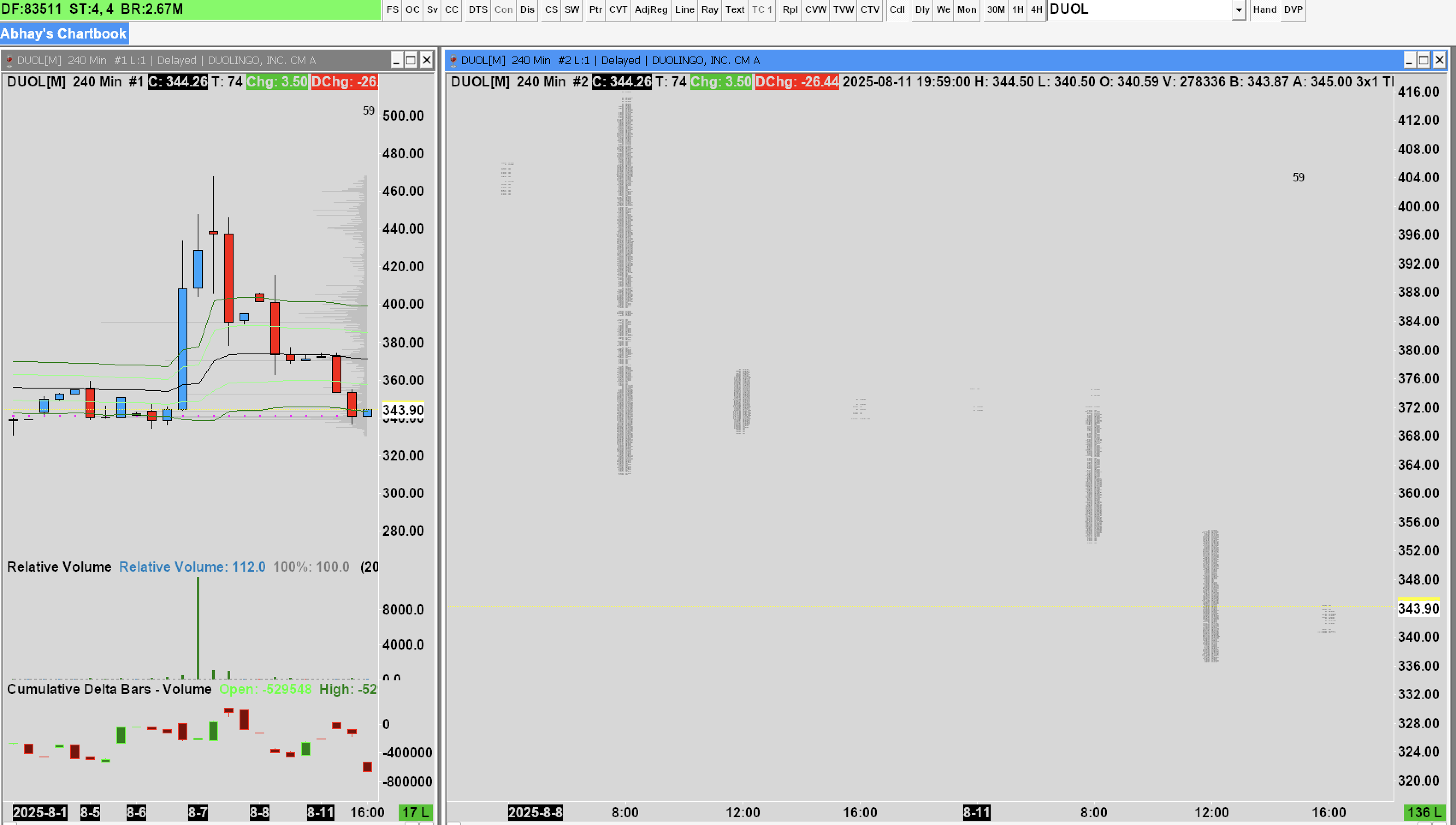

Every time I change the tick size in chart settings for the stock ticker DUOL, it changes while I stay on the on the stock. The moment I change the stock and visit DUOL stock back, it changes back to original tick size before I changed it. The issue could be that it is set through Global settings but I cannot revert back to a custom tick size for that stock.
I want a custom tick size only for that stock that way whenever I visit that stock back, I do not have to change it on the number bars.
Thanks,
Abhay

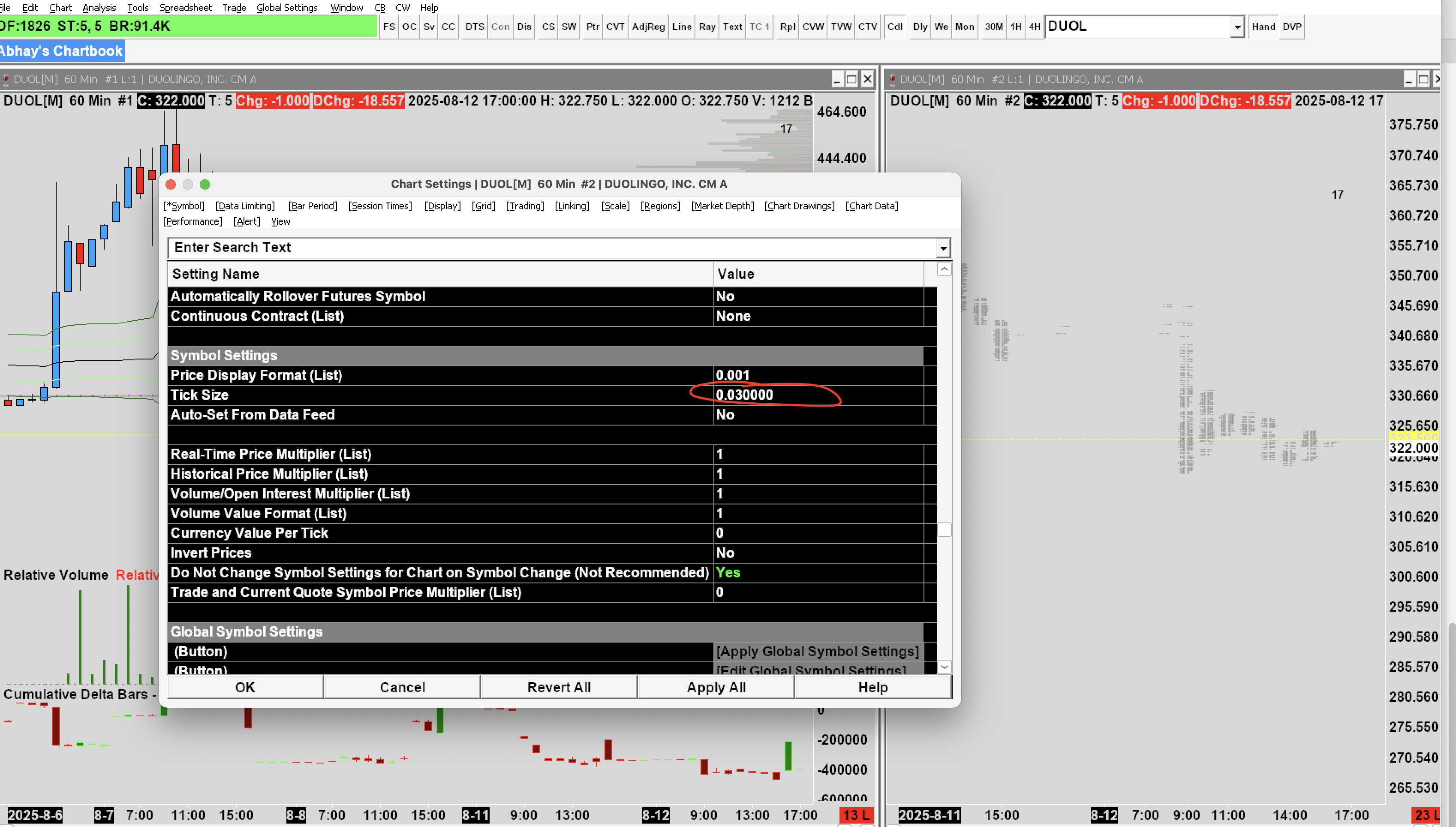

Refer to this setting:
Chart Settings: Do Not Change Symbol Settings for Chart on Symbol Change (Chart >> Chart Settings >> Symbol >> Symbol Settings menu)

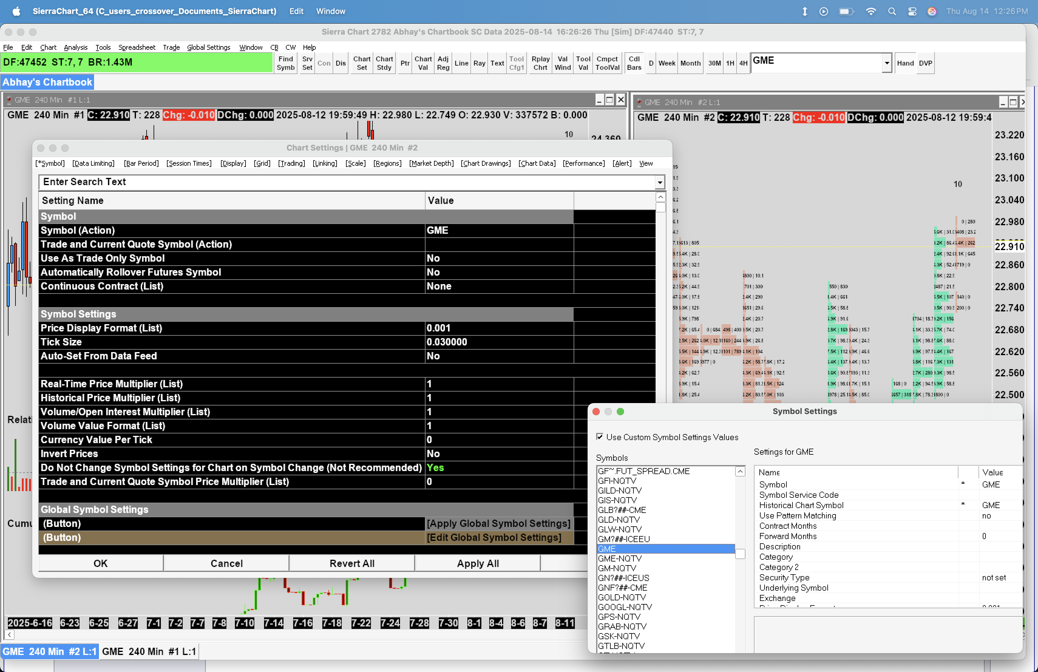

I added literal symbols to the global settings and individually went to each stock selected. Here is what happens: when I apply the global settings to GME stock (tick size 0.03 from global settings), it changes the DUOL stock's tick size to 0.03. Shouldn't it have read the tick size of DUOL from the global settings symbol?

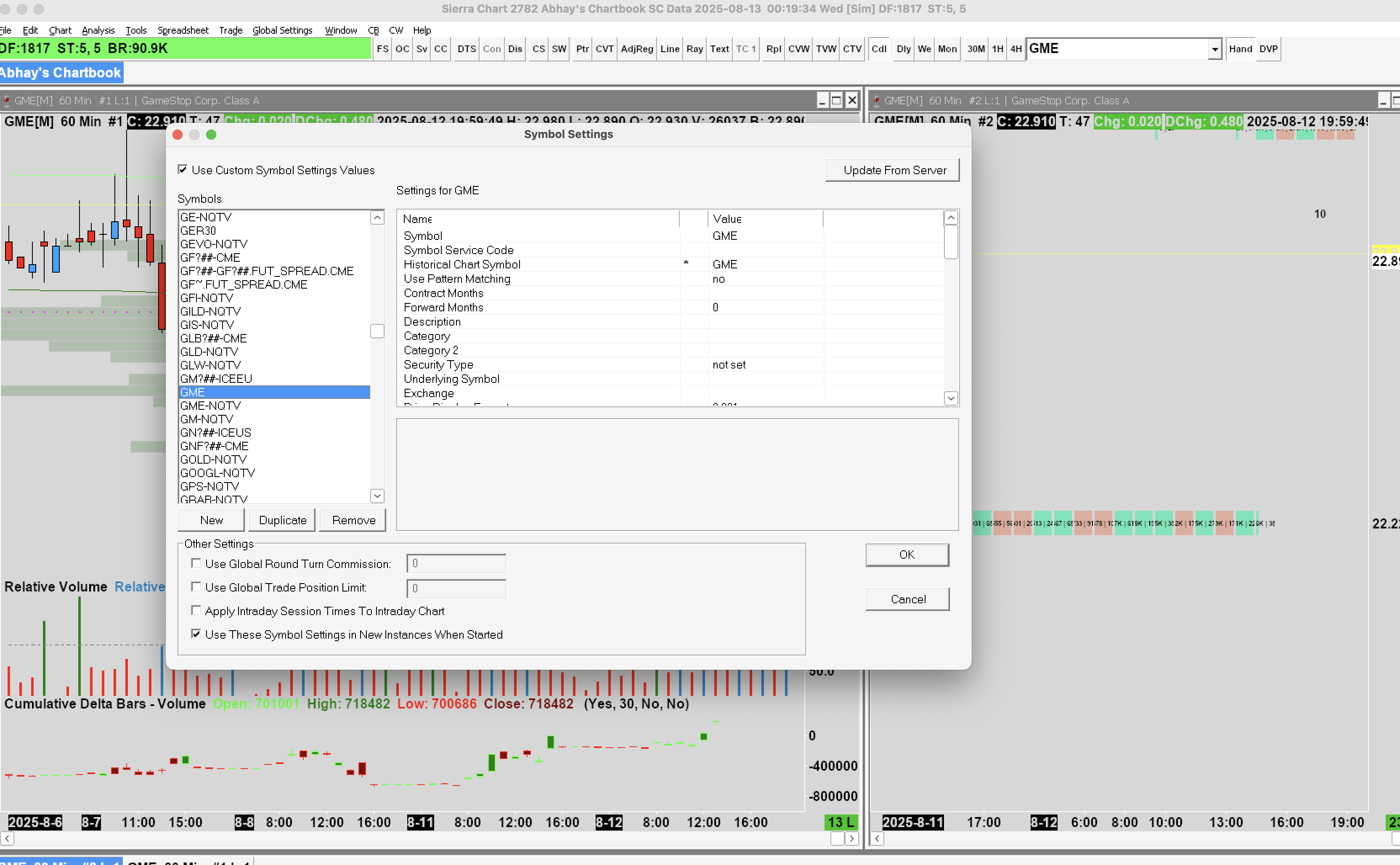

To clarify post #6, you can check the screenshots where I apply the global settings to GME stock. You can see that the tick size is 0.03 for that stock in the Symbol list. I click Apply All.
Then I go to DUOL stock that requires a different tick size of 1.1 that I had applied already but it changed to 0.03 (GME tick size from global settings). Having the symbol listed did not change anything for this problem unless I am doing something wrong.

We are still not precisely understanding the sequence, of events. However, being you have modified the Global Symbol Settings for those individual symbols with the Tick Size that you want, make sure this is set to No for the chart:

This did the trick! It was turned to ‘Yes’ and I turned it off. Thank you!!
