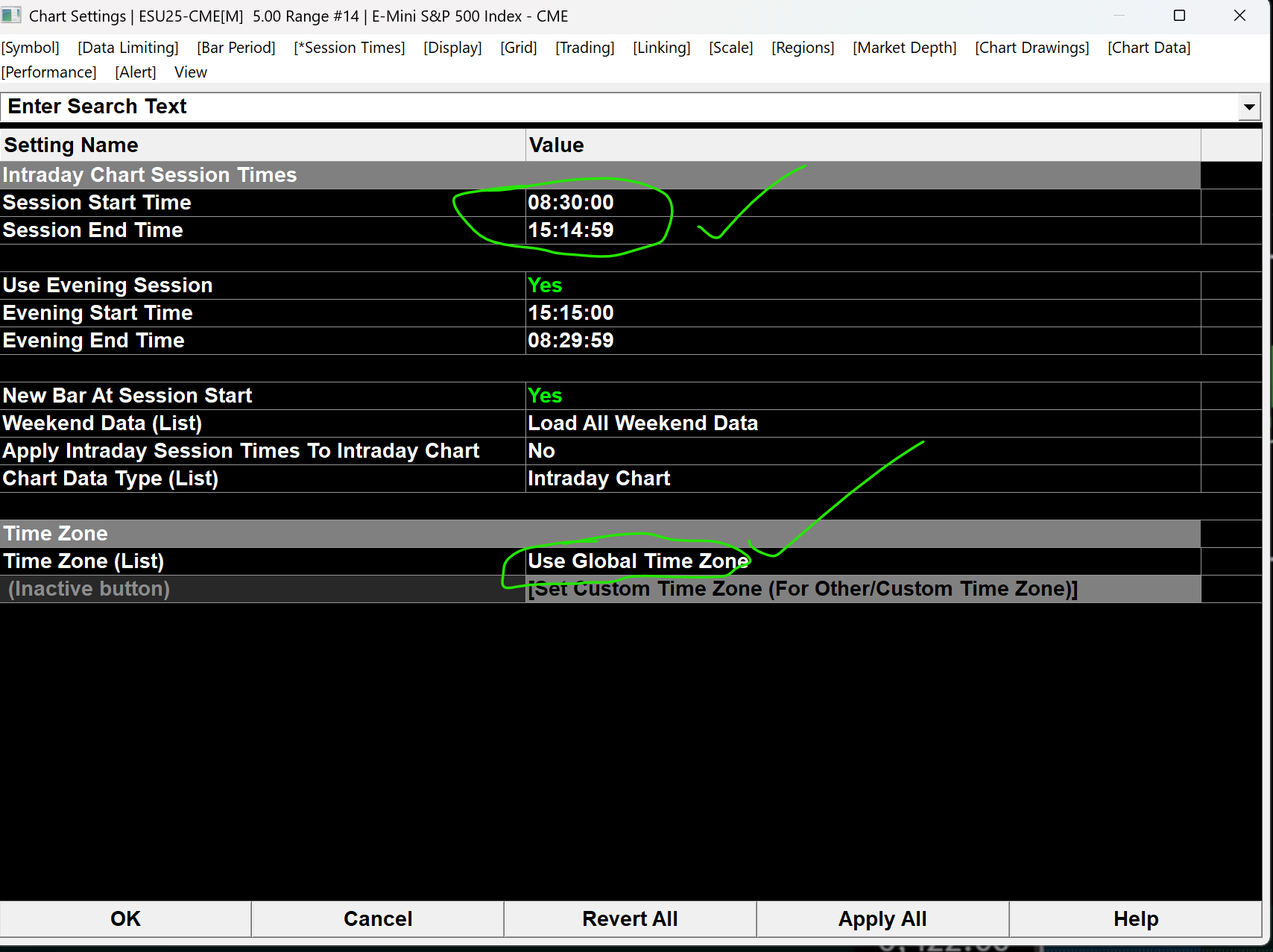

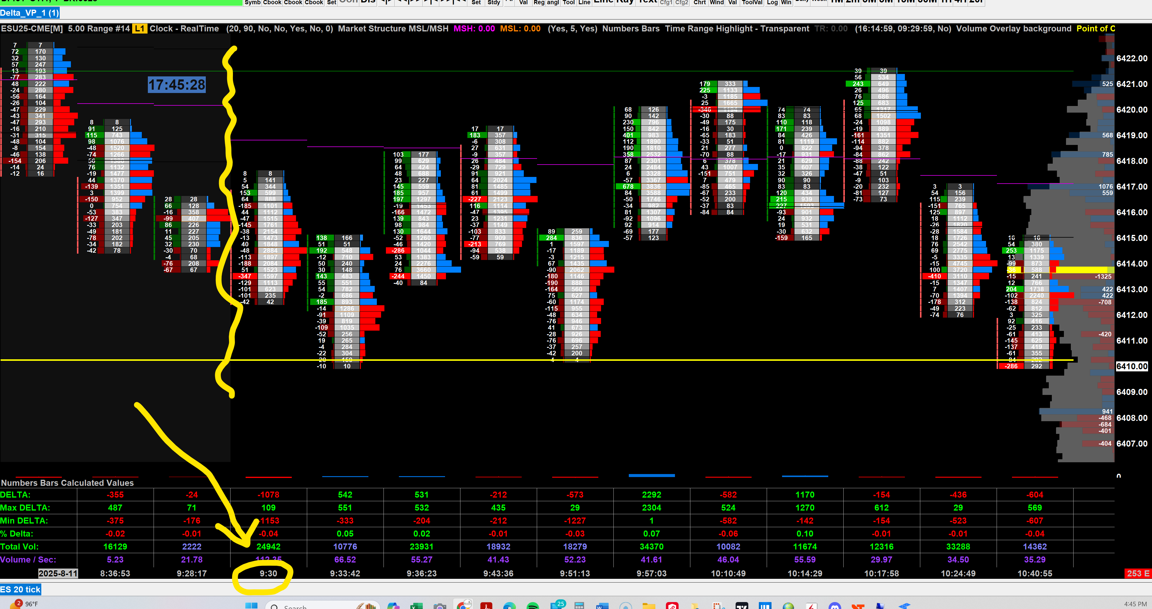

Hey, although i trade the NY Session, how can i adjust my time to show 8:30am opening bell, as opposed to where it is now at 9:30 opening bell?... Im in Dallas, TX (CST) so we are 1 hour behind. (see screenshot)

[2025-08-12 04:16:18]
Sierra_Chart Engineering - Posts: 25481
Refer to:

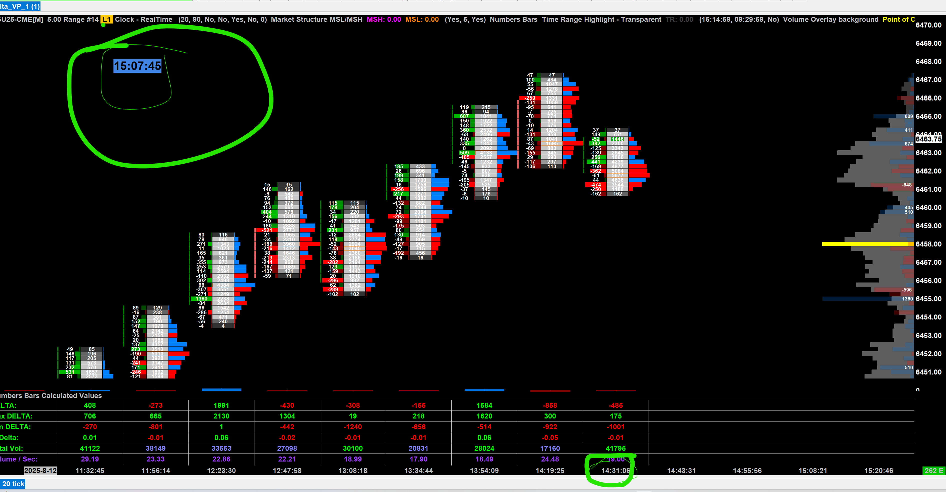

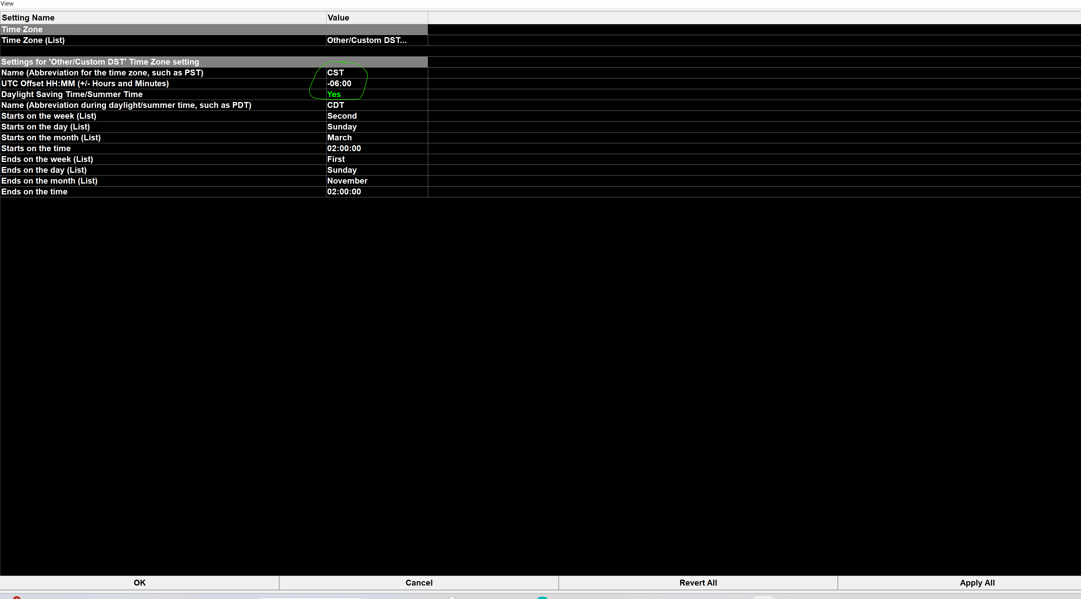

I followed the steps and tried Other/Custom DST, and as it shows in the screenshot attached, it appears to be correct however my real time footprint chart still is basing its time from the NY/EST timezone, not my Dallas/CST timezone.... what am i missing or doing wrong here?

[2025-08-12 20:18:43]
We definitely do not recommend using Other/Custom DST. It would be very rare that you would ever have to use that. Choose Chicago time instead.
And we recommend setting the Time Zone itself in the chart:
Time Zone Setting: Using Different Time Zone in Individual Charts

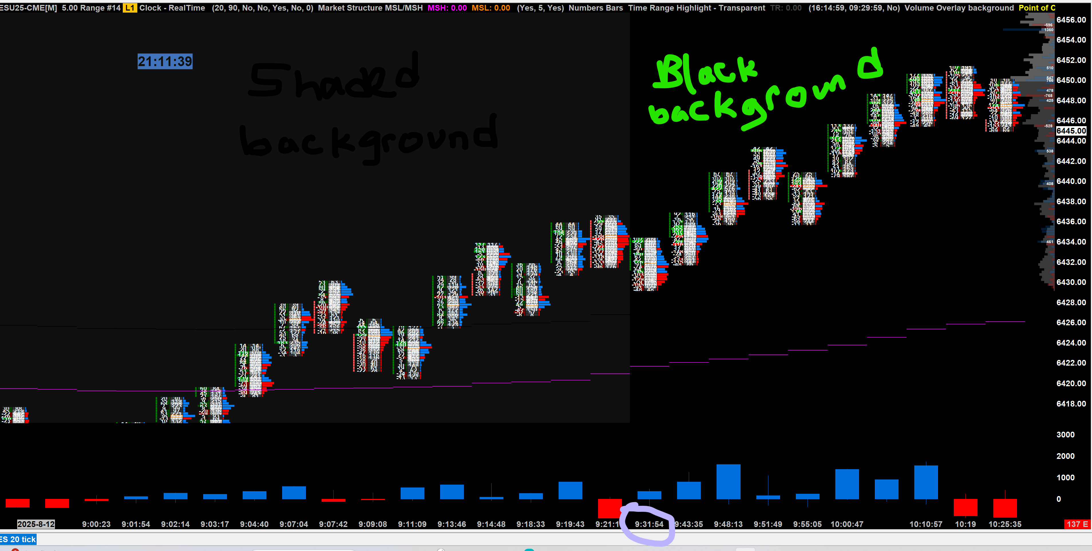

Ok so i found the chart settings timezone and made the necessary adjustments and its now showing my correct start and end time (see screenshot).... but how can i have the ALL BLACK BACKGROUND also reflect right at 8:30am (CST)... instead of it still being on the (9:30 time... (see screenshot)

[2025-08-13 01:57:57]
We do not understand at all post #5.

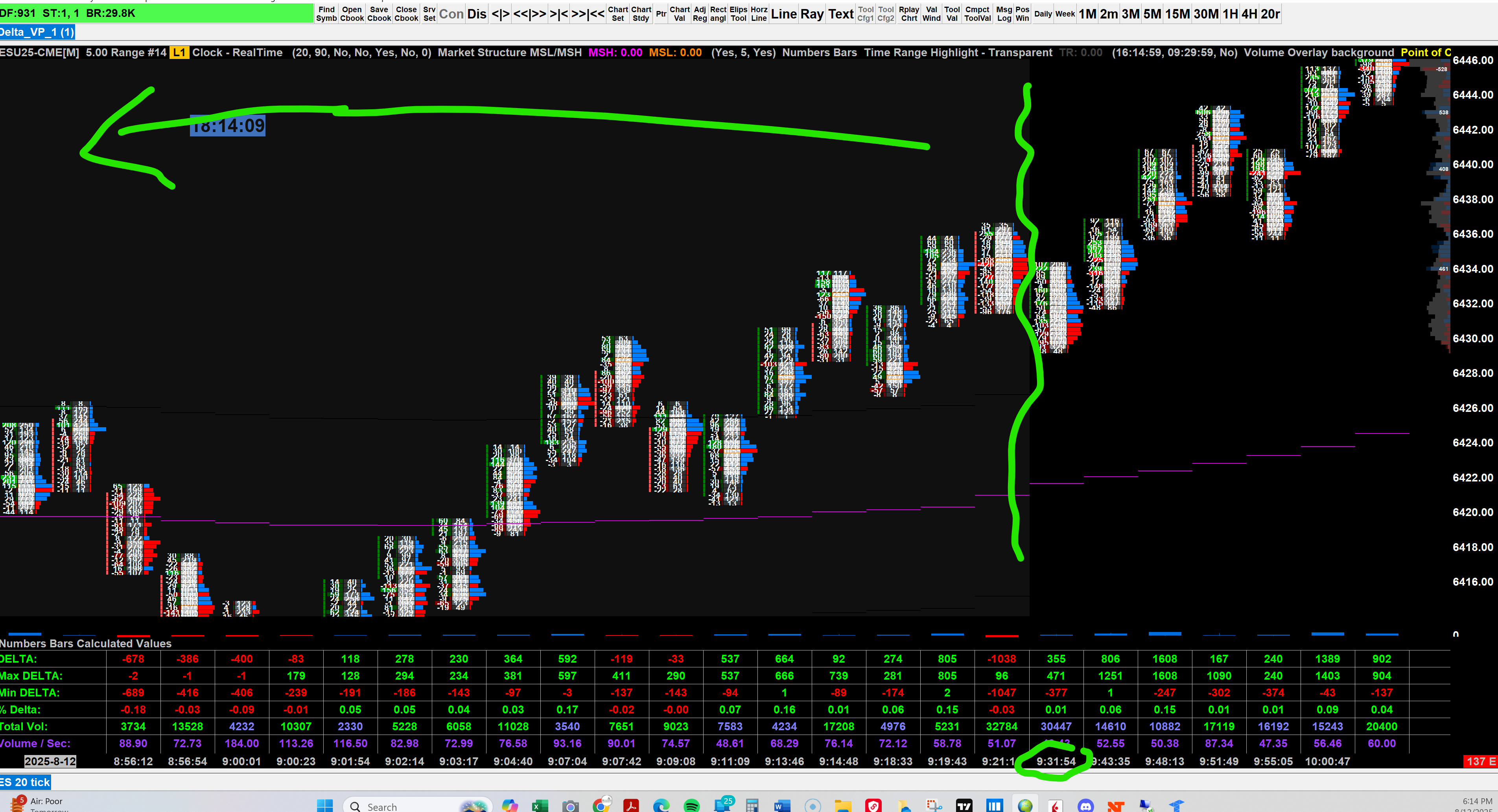

[2025-08-13 02:15:25]
Brightstone - Posts: 28
How do i change the background from shaded to black? (see attached). I need to to go from shaded to all black at 8:30am (not 9:30 am)

[2025-08-13 19:50:29]
Change the EndTime Input to: 08:29:59 in this study instance:
Time Range Highlight
