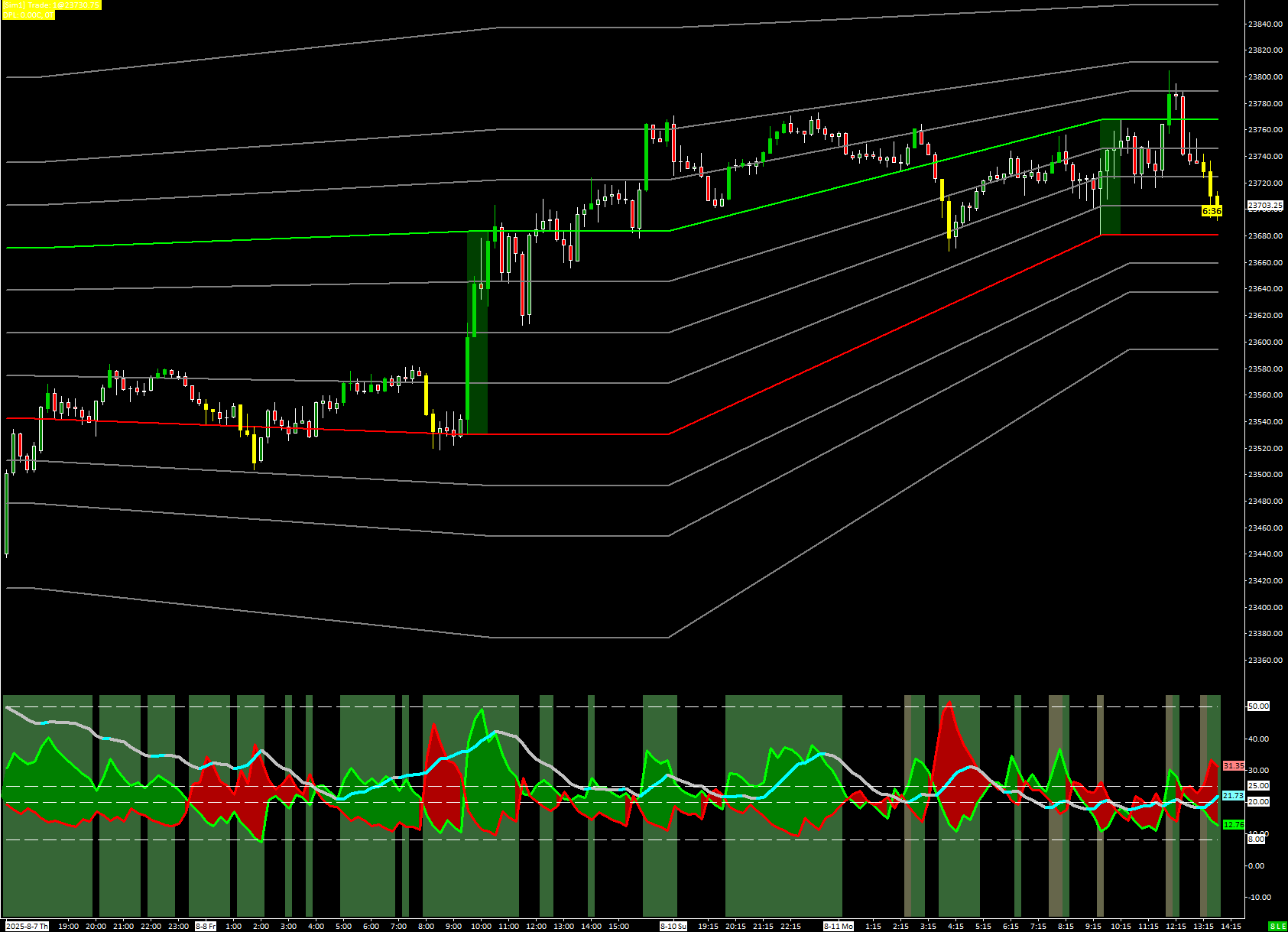

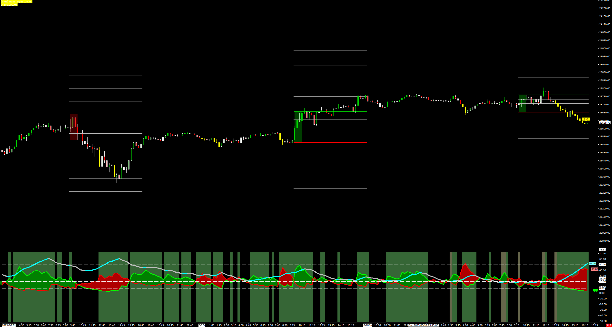

Could you tell me what would cause the lines continuously transitioning to the next start time when I include more time on the chart? One Pic has this. The other is obviously the desired effect - should be each day Start & Stop of the study even if multiple days are in view - Obviously I can only show one day for the desired effect .
https://www.sierrachart.com/image.php?Image=1754934801381.png
https://www.sierrachart.com/image.php?Image=1754934847833.png

I was using the free version of Claude AI. First time using AI too. Yep, I'm older. I have everything working and setup like I want except the Line End Time bug. Next run through, I am going to Start all my Deviation lines at the Beginning of the OB. When I trade I'll set the Number of Days To Calculate to 1 to avoid the line transition clutter. I really only need to see that day I'm trading. I thought it would be nice to scroll back though and see it like it's suppose to be.
It's weird, when I load the study when the market is closed it appears like it's suppose to every day - no Line transition clutter. But that changes at some point once data is flowing
Again I really appreciate your effort to help me.

[2025-08-12 00:15:59]
DualADX - Posts: 41
The High / Low for Time Period - Extended study is what I was using. It's what I fed into Claude AI as a base to work off of. As I was having it add the the lines in between the OB Top & Bottom and then the deviation lines it must have changed the End Time code. I'm going to feed that back into the AI as a source for the Time End only and see it that will work. Because yes, the Lines Stop in the original study. Can't use it again until 10pm EST. Limits on the free version. As a last resort I'll try it once from scratch now that I know how to specifically word everything.
[2025-08-12 00:50:26]
DualADX - Posts: 41
You know what? I found the problem! I just made the native High / Low for Time Period - Extended study do the same crap with the lines. I changed the Draw Style from Stair Step to Transparent Fill Top/Bottom then back to Line. Line is the problem! All my Lines needs to be Stair Step Draw Style.
[2025-08-12 02:35:59]
DualADX - Posts: 41
Got it.
https://www.sierrachart.com/image.php?Image=1754965977454.png
RTH only
https://www.sierrachart.com/image.php?Image=1754966109780.png
