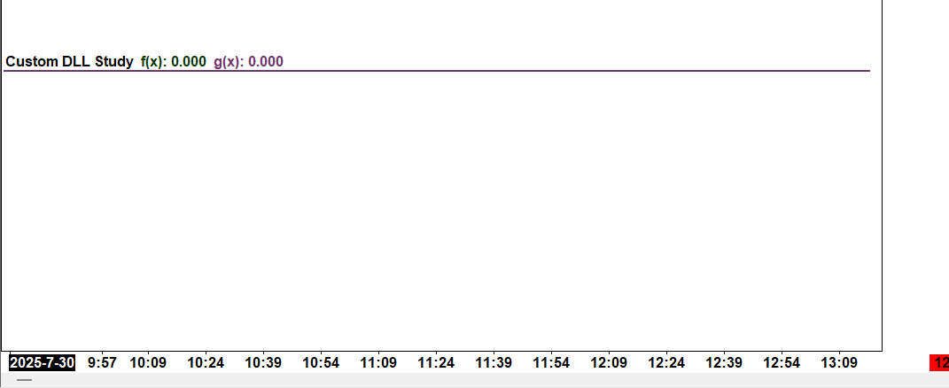

After applying the custom study, though the logic hasn't changed from prior w.r.t. the sc.GetStudyArraysFromChartUsingID (i.e. inputs are identical;) no values are populated.
I created a test study that only contains the sc.GetStudyArraysFromChartUsingID to troubleshoot whether or not the issue was isolated to the new study or something else.
After building the TestCustomStudy it too has the same issue but I noticed in the Add Custom Study menu, instead of just displaying the DLL name like prior studies, it displays scsf_StudyByIDTest.
When applying it to the chart, it doesn't display the actual study name but instead just says Custom DLL Study.
Can someone advise as to why this may be happening?

[2025-08-09 03:35:25]
Gradient - Posts: 219
I realized I omitted the sc.GraphName in the StudyByTestID defaults.
Adding it corrected the rendering of the name in the Custom Study Menu.
However, the issue with sc.GetStudyArraysFromChartUsingID still persist despite it being a copy and paste from prior versions of which have no issues rendering.

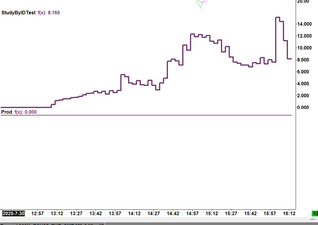

[2025-08-09 04:14:55]
I substituted sc.GetStudyArraysFromChartUsingID with sc.GetStudyArrayUsingID in the TestStudy and it correctly rendered the output of the study.
I then copied and pasted this code block into the Prod study and it didn't render the output.
imageCustomStudyCopyPasteNotMatching.png / V - Attached On 2025-08-09 04:14:35 UTC - Size: 18.55 KB - 274 views
[2025-08-09 05:11:35]
I've resolved the issue.
I realized that there was a return statement on the outside if the SetDefaults conditional.
This was preventing the subgraphs from populating.
