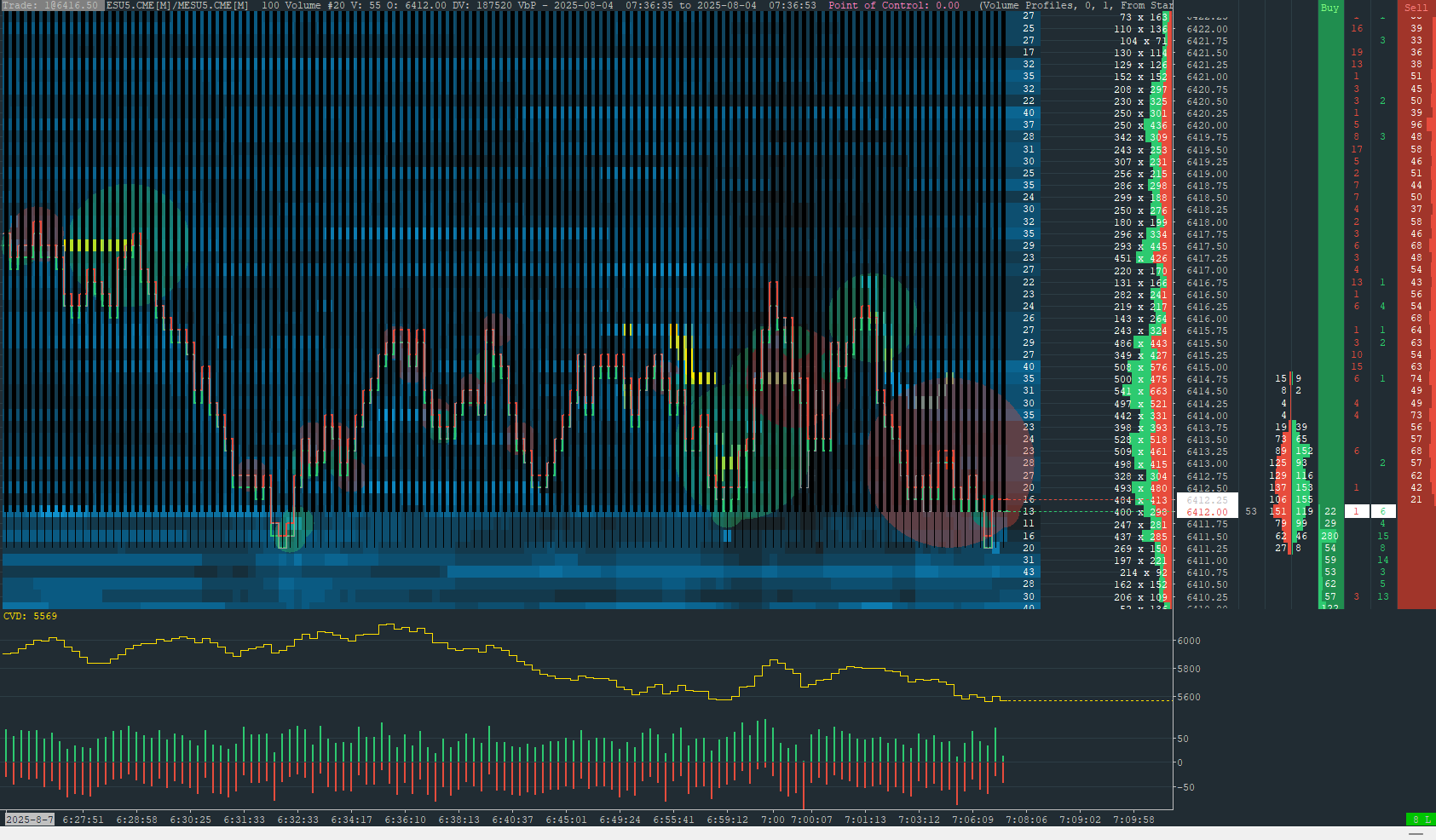

Hello, i copied a heatmap chart from a friend's chartbook. In his chartbook appears ok, but when copied in my chartbook there is a grid/ bars covering the graph which is not allowing me to see anything. This is kinda grid lines which become bars and they follow price as it moves.
Any idea how to remove it? Thank you
imageScreenshot 2025-08-07 120758.png / V - Attached On 2025-08-07 11:11:34 UTC - Size: 162.58 KB - 294 views
[2025-08-07 14:25:25]
Those are coming from some study. You need to go through the studies for that chart and determine which one is causing it.
[2025-08-07 15:58:19]
sadramistes - Posts: 24
That's what I thought too. I went through each one of them disabling them and bars are still there. I'll try again in case i missed something
[2025-08-07 16:02:11]
It looks like it would be from a "Study/Price Overlay", so look for that in particular.
If you can't find it, then get us the chartbook by following these instructions:
[2025-08-08 22:44:50]
You were right. It was a study overlay causing it. Thanks
