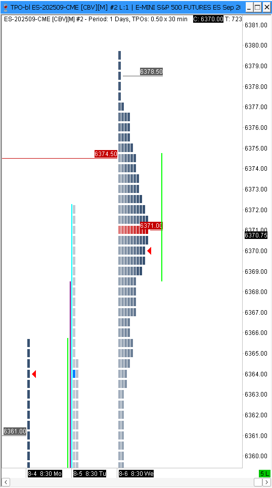

A chartbook with a TPO chart was loaded at the beginning of today's RTH.
Everything looked fine. TPO chart default size is 4L.
The chartbook was running in the background for the complete RTH session.

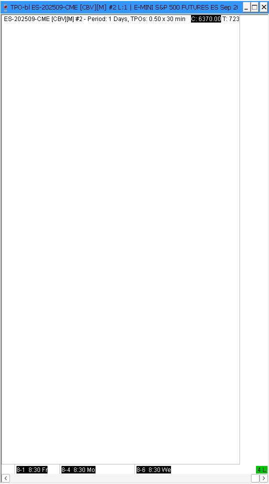

After the RTH session I brought the chartbook to the front and the TPO chart area was empty, including the scale area.
I experimented and found:
- With 3L the chart worked normal.
- With 4L the chart and scale is gone, but when I maximize the window, it works normal. When I minimize it again, the chart and scale again disappears.
- With 5L the chart looks normal at first, but the scale shows strange behavior: Regardless of the setting of "Interactive Scale Move" or "Interactive Scale Range", the function is always move. It is impossible to get the range function, either via the menu or via CTRL key.
- With 6L the chart works normal.
- With 7L, it is the same as 4L.
The problem is reproducible after closing and reloading the chartbook, and also after closing and restarting SC.
I have the same chartbook for ES, MES, NQ, MNQ.
The problem only shows for ES and MES, not for NQ, not for MNQ.

Particularly noteworthy is that in size 4L, a scale reset does not do anything!
It appears that the scale is completely gone (see attached screenshot).
