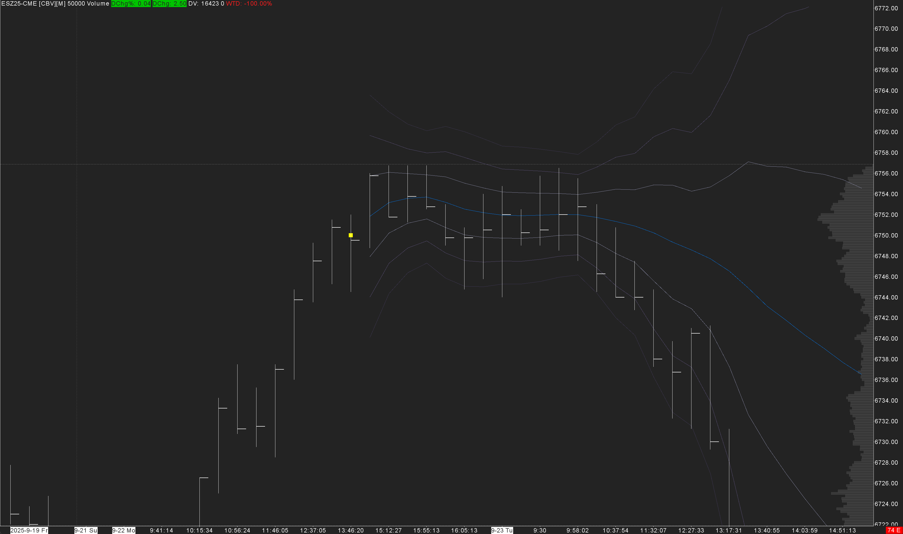

joshtrader - Posts: 569
I believe this is related. In the new AVWAP tool, I cannot set the anchor on certain bars.
Here the anchor is one bar ahead of where the VWAP actually begins.
Also, the VWAP stdev lines here are simply not correct, they're not even close:
https://www.sierrachart.com/image.php?Image=1758848250910.png

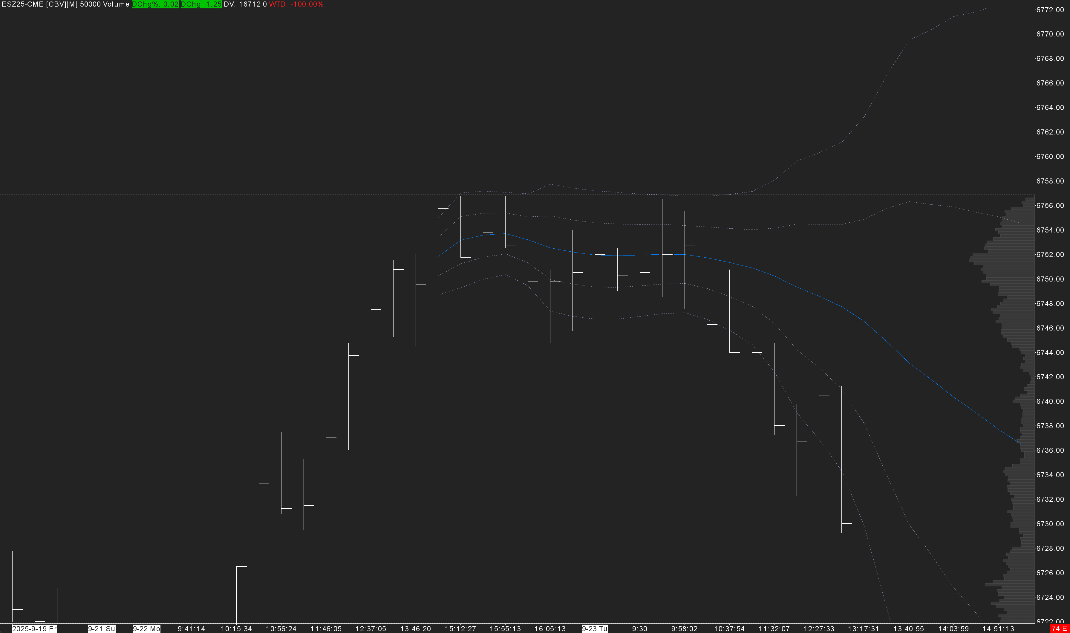

Here is the VbP 1&2 stdev on the same bar, with the correct stdev lines:
https://www.sierrachart.com/image.php?Image=1758848451239.png
