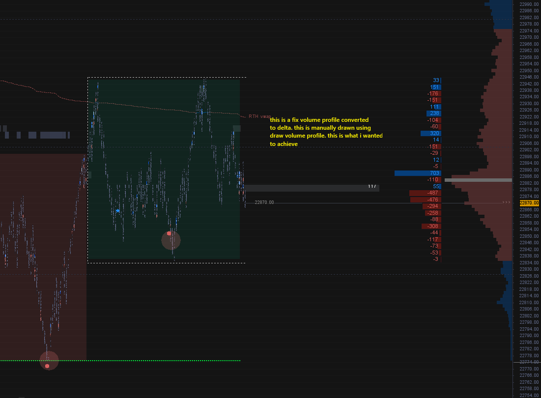

Is there a way to create a new fixed profile or delta profile at a specified time interval, redrawing it every time interval I set? I’ve tried different combinations of Volume Graph Period Type, but I can’t get it to create a new profile for every minute interval I specify.
I want it to create a new profile every 90-minute cycle, but the profile keeps displaying incorrectly.
I’m not sure if this is related to Bar Type or Bar Period. I’m using Renko bars in ticks with a Bar Period value of 4. Session Times are set to include the evening session (Evening Session set to Yes), and New Bar at Session Start is also set to Yes.

I'm trying to create a volume profile that displays deltas instead of standard volume. I want to automate this process, as I saw a YouTube video demonstrating volume-by-price profiles updating every 5 minutes. I'd like to achieve the same but with a 90-minute interval. You mentioned that using Renko bars prevents the profile from resetting correctly, but I'm basing the study on time, not the bars themselves.
I tried configuring it as follows:
Volume graph period type: One period at the end of a fixed time length
Time period type for fixed time: Minutes
Time period length: 90
However, the profile doesn't reset every 90 minutes as expected.

yea I also created multiple profiles based on fixed time intervals. However, I don’t want previous profiles to appear, as they’re no longer relevant to my strategy and clutter my charts. I only want to display the current 90-minute profile. I guess it cannot be done :(
