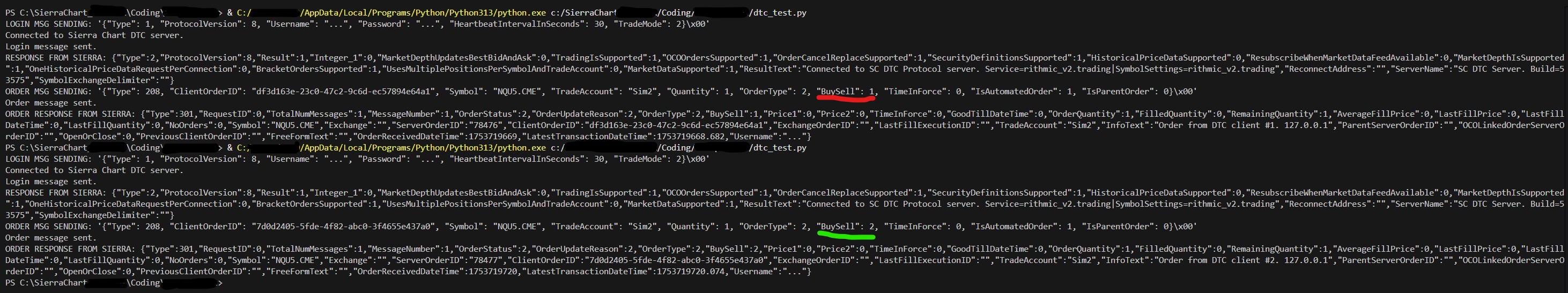

I have a perfectly working little python script that on execution sends a SELL order to Sierra Chart via DTC(JSON compact), order opens, I'm short, I'm happy.
But when I switch it to send a BUY order, no order gets opened in SC.
As far as I know, in order to send a BUY order I only have to set a 1 instead of a 2
"BuySell": 1
The Sierra log as well as the Terminal log on the python(client) side seem to not indicate any difference (unless I missed it).
I'll attach both logs and the small script.
Hopefully one of you can spot the problem bc I'm lost.
Thank you so much!
Private File
imageSellDontBuy.jpg / V - Attached On 2025-07-28 17:13:11 UTC - Size: 184.75 KB - 232 views
imageSellDontBuy_Terminal.jpg / V - Attached On 2025-07-28 17:13:17 UTC - Size: 490.3 KB - 291 views

It gets more strange, when I set it to "1" it appears as invisible LIMIT BUY order without a price! (see attached screenshot)
Even though OrderType is set to "2" (market order), which works correctly for sending a sell order.
order = {
"Type": 208,
"ClientOrderID": str(uuid.uuid4()),
"Symbol": "NQU5.CME",
"TradeAccount": "Sim2",
"Quantity": 1,
"OrderType": 2,
"BuySell": 1, # 1 should be "BUY", but only 2 for "SELL" works
"TimeInForce": 0,
"IsAutomatedOrder": 1,
UPDATE: if I send a LIMIT BUY order it executes as MARKET BUY! Could be a DTC bug?
At least I have a workaround now. I send limits when I want markets for buy :)
Until you fix it and my account blows haha.
"IsParentOrder": 0
Date Time Of Last Edit: 2025-07-28 22:35:44
imageinvLimitBuy.jpg / V - Attached On 2025-07-28 22:10:04 UTC - Size: 33.17 KB - 267 views

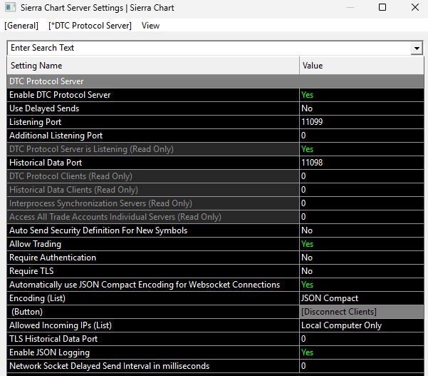

[2025-07-28 22:54:57]
User370774 - Posts: 35
My DTC sierra is set to JSON compact (attached setting)
So it kinda works now for me if I send a market order with a price it gets executed as limit at that price and vice versa a limit buy becomes a market buy.
If its a bug I can live with the workaround but if its my code then I rather find the fix of course.
Let me know what you think about my settings in the screenshot.
Maybe I should try something else than JSON compact and rewrite my script accordingly to binary or something?
Date Time Of Last Edit: 2025-07-28 23:23:28
imageSC_DTCsettings.jpg / V - Attached On 2025-07-28 23:23:24 UTC - Size: 92.51 KB - 210 views
[2025-07-28 23:33:03]
Sierra_Chart Engineering - Posts: 25461
JSON is fine, and you are not using the compact version. We do not see any obvious problems.
We are going to check on debug logging to help you determine the problem.
Date Time Of Last Edit: 2025-07-28 23:33:24
