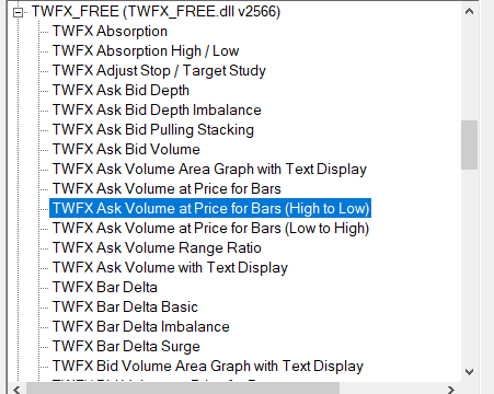

I'm using 3rd party studies such as TWFX Ask Volume at Price for Bars (High to Low), Bid Volume and also both for Low to High to sum up amount of buying/selling at top 3 points and bottom 3 points each bar and doing statistics on that data to see for instance when there's lowest selling in last 10 mins at bottom of bar, highest and same for top.
I have many Color Bar Studies based on various order flow events etc. So there could be 20-30 color bar on alert and checking so much.
So having it at close doesn't do fewer calcs? Putting it on another 1min chart with a 10 second update frequency wouldn't run cals far fewer times?
