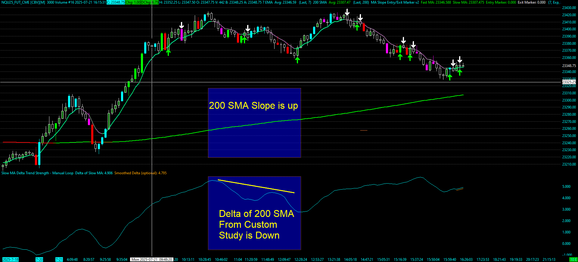

I have a relatively simple ACSIL custom study to calculate the difference of the 200 SMA of the current bar to the value 7 bars previous. I added logging and see that the Delta subgraph is printing values around 3.78 in the log but the plot doesn't look correct - it is trending down when the 200 SMA is trending up. I am attaching the ACSIL code as compiled, screen shot of chart, and message log. Appreciate any help with this. The code seems (to me) to fairly simple. Also, I tried same study on a time based chart instead of the tick chart but got the same result.

You're plotting difference on a very small scale. How were you expecting the plot to look?
[2025-07-22 14:20:20]
Knapp-Time - Posts: 5
The scale is very small at this point because the 200 SMA is flat. When the MA is trending, the values will be larger. I want to develop trading entry and exit rules based somewhat on the steepness of the 200 SMA. On one bullish day I have been looking at the SMA was above 10 and steepening. Rather than look in the tool values window and subtracting manually, the delta plot will let me hover the cursor over it and instantly see the numerical value that represents steepness.

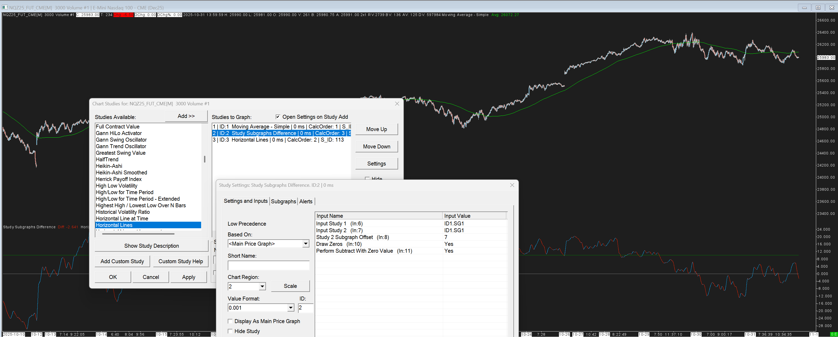

Writing code is fun. For this analysis, you can use some inbox studies as well. As for "trending down", if your lines are above zero, the 200ma is still rising, just not accelerating with your 7-bar lookback comparison. Keep experimenting and tuning.
