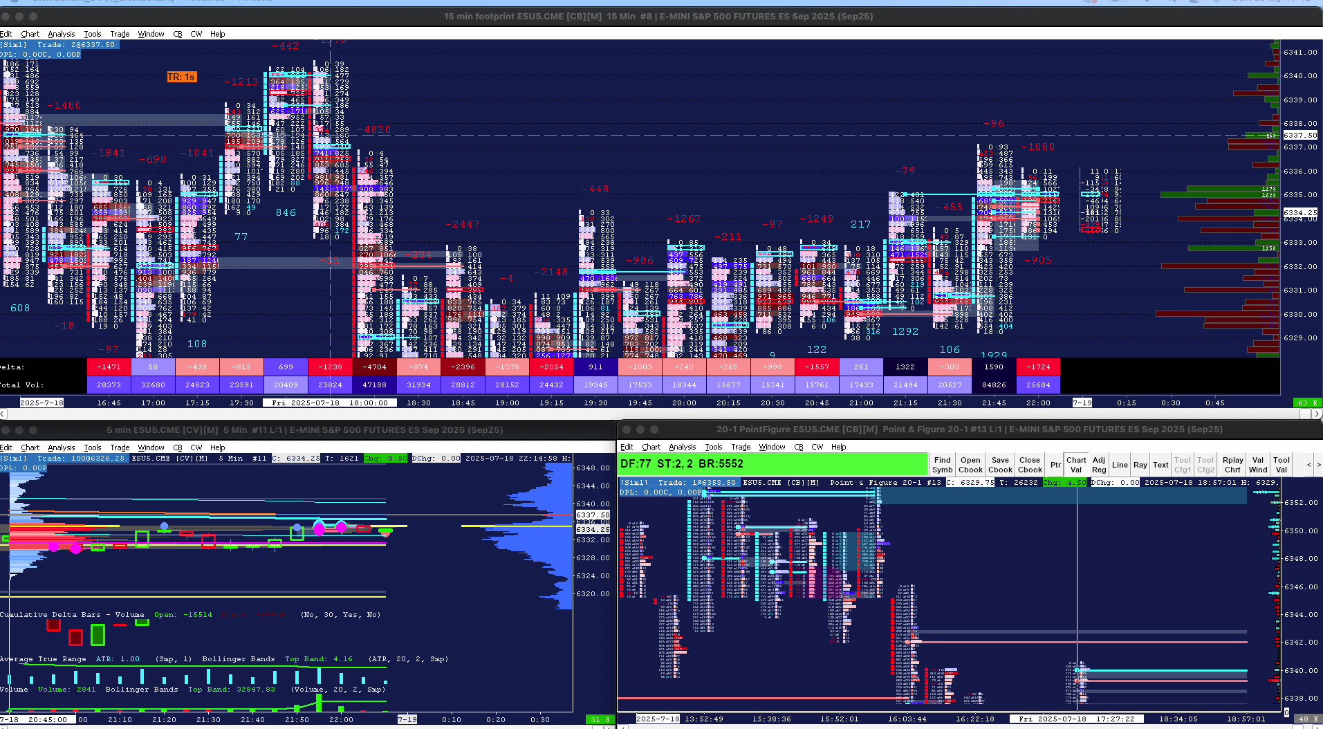

Hi! I don't understand why this chart (20-1) appears to have the main interface and isn't like the others. How can I remove it and display it like the other charts I have? Thanks.

[2025-07-20 12:29:09]
Sierra_Chart Engineering - Posts: 25481
Looks like you are referring to the title bar of the chart. That is controlled by the operating system. Not Sierra Chart.

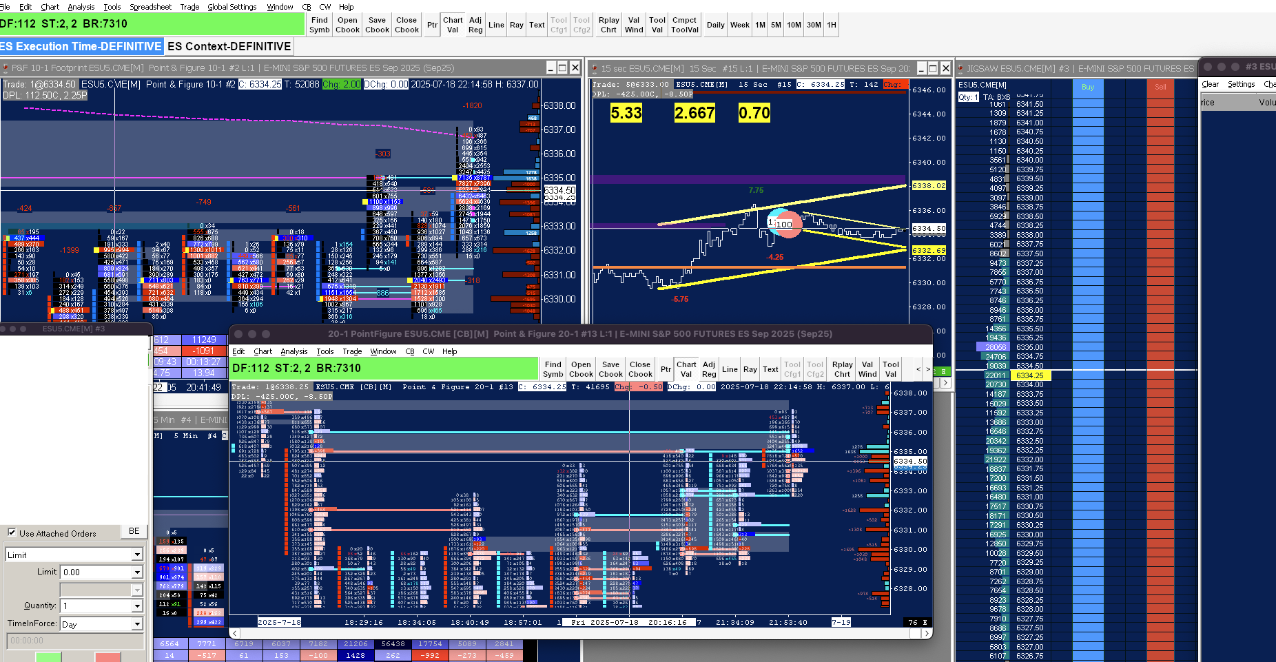

User931951 - Posts: 79
No, I mean, when I "detach window" from the main screen of Serra, all the charts "detach normally", as if they were subchats of the main one (by main I mean the one with the green bar that says I'm connected to the data), while this one is as if it were the main one. I don't know how to explain. I'm attaching another photo. Can you see what the other charts look like? Without the bar that tells me I'm connected to the data? I'd like the point and figure charts to be like this too. Thanks, I hope I was clear.

[2025-07-20 17:12:32]
cmet - Posts: 747
In the chart, go to Windows > Control Bars and make sure they're all unchecked.
Yes, you are referring to a Control Bar on a detached chart which is supported. Refer to:
Control Bar
They can be disabled through the Window >> Control Bars menu on that chart.
