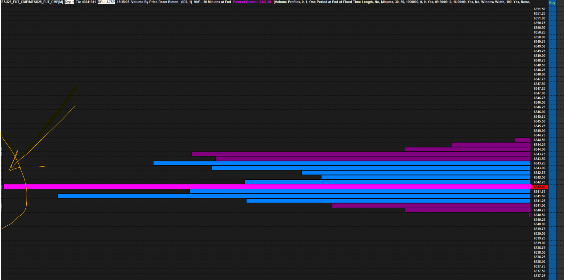

[2025-07-17 19:34:38]
User871314 - Posts: 32
https://www.sierrachart.com/image.php?Image=1752780846518.png

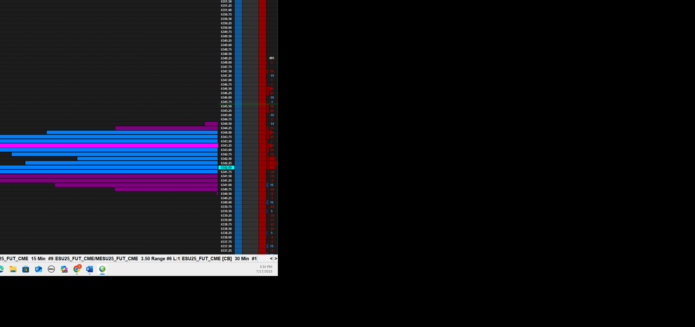

[2025-07-17 19:37:33]
I attached a better screenshot here. you can actually see the delta profile when I expand the window but it is extremely small and all the way to the left. unreadable and not scaled.
imageScreenshot 2025-07-17 153546.png / V - Attached On 2025-07-17 19:36:35 UTC - Size: 196.24 KB - 282 views
[2025-07-17 20:52:30]
You probably have the one profile setup to take up most of the space in the window. Check how you have the following Input and the one below it set:
Volume By Price Study: Maximum Volume Bar Width Type
You should probably set these to be "Window Width" with a percentage of about 30% for each.
[2025-07-18 01:44:29]
Thank you
