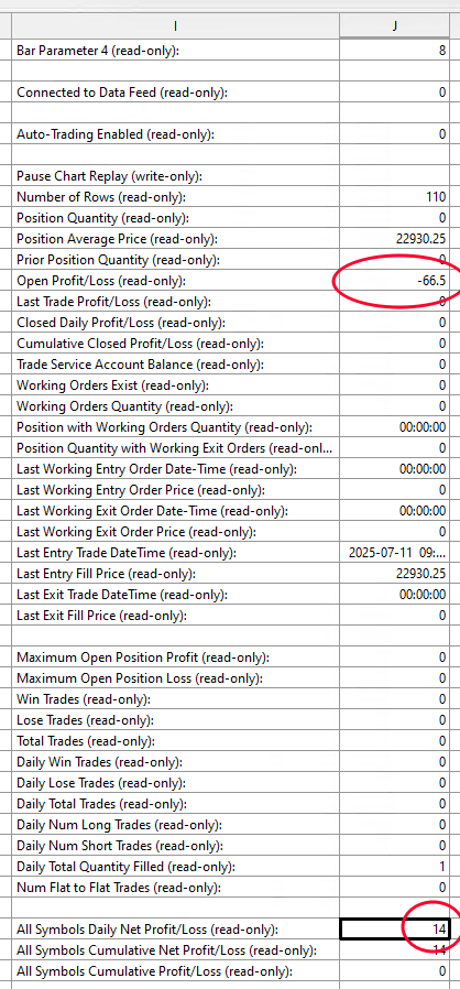

I'm trying to setup spreadsheet alerts based on "all symbols daily net profit/loss", field J65 with v2 J data enabled.
I cleared all sim data/trades (trade activity log shows empty). Then I did 1 sim trade on a replay of around 9:35am Friday on a single chart.
J65 shows 14. I don't know where the 14 comes from at all.
J34 open Profit/Loss shows the correct -66.5.
I want to reliably reference 1 field that provides the current open+closed net P/L for all tickers in the current account.
(Setting up these alerts would be easier for users if incorporated into the global profit loss management. I just want audio alerts when the open+closed net p/l for all tickers is over, or under, account profit/loss values)
imagesierra-spreadsheet-2025-07-12_02-12.png / V - Attached On 2025-07-12 06:15:53 UTC - Size: 36.77 KB - 274 views
imagesierra-spreadsheet2-2025-07-12_02-14.png / V - Attached On 2025-07-12 06:15:56 UTC - Size: 89.96 KB - 324 views

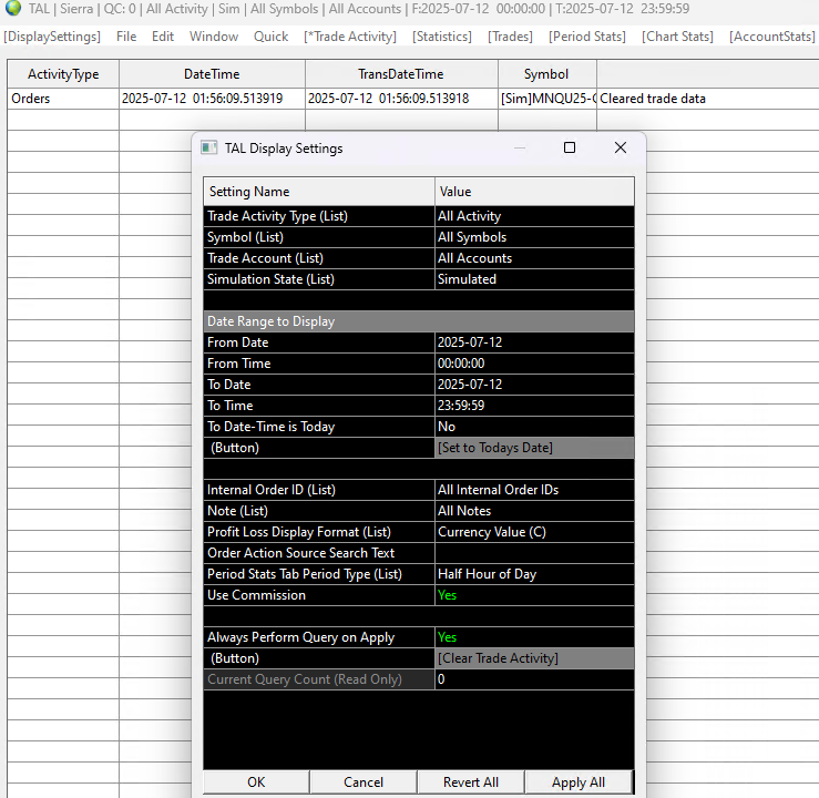

[2025-07-14 14:14:33]
Given how your Trade Activity Log states "Cleared Trade Data", this implies that you cleared the trade data through the option when starting the replay and that you only cleared the data for the symbol MNQU25-CME. This means that you have another symbol somewhere that has fills for it that is contributing to the Net P/L. These would be from before July 12, 2025, since that is the only day that you are displaying in the Trading Activity Log. You need to change the "From Date" to go back far enough to find other orders that would be contributing.
Another solution would be to use the "Trade >> Clear Trade Simulation Orders and Data" to completely remove all data associated with simulated trading.

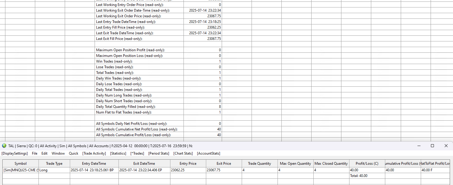

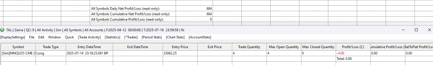

Attached is another test.
imagetest1-2025-07-15_04-27.png / V - Attached On 2025-07-15 08:35:21 UTC - Size: 31.77 KB - 257 views
imagetest2-2025-07-15_04-29.png / V - Attached On 2025-07-15 08:35:25 UTC - Size: 57.25 KB - 248 views
