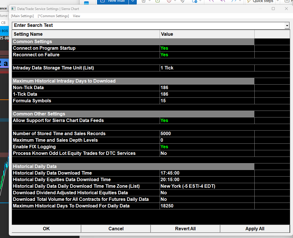

The trading goes through that vendor - yes. But the data does not have to be.
Are these separate installations on the same computer or different computers?
If they are on the same computer, then for the installation connected to Rithmic, please tell us what the setting for "Global Settings >> Data/Trade Service Settings >> Common Settings >> Allow Support for Sierra Chart Data Feeds" is set to.

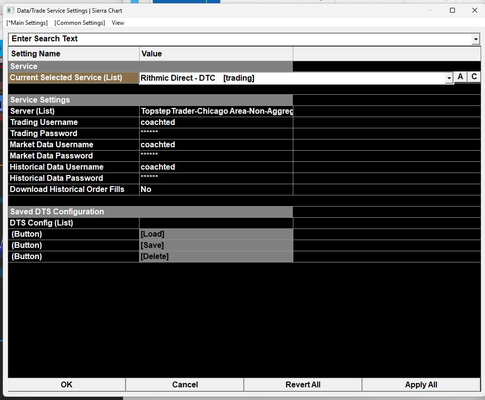

coachted - Posts: 545
I have always been under the impression in order to trade a funded account the installation must be connected to rithmic otherwise the funded account would not be connected...
Date Time Of Last Edit: 2025-08-01 14:35:28
imageScreenshot 2025-08-01 103147.png / V - Attached On 2025-08-01 14:32:02 UTC - Size: 75.85 KB - 201 views
imageScreenshot 2025-08-01 103220.png / V - Attached On 2025-08-01 14:32:35 UTC - Size: 48.96 KB - 267 views

Yes, that is correct. Whatever account you are trading, you need to be connected to that account.
But you do NOT need to get the data from that trading service. From what you show us, you are getting your data from our Denali Exchange Data Feed, while you are trading with Rithmic. This is fine.
Back the original issue then, which is that if what you show in your images is for the same installation where you are connecting to Rithmic, then you should have the Market Depth data in that DOM. Are you still having an issue with this?

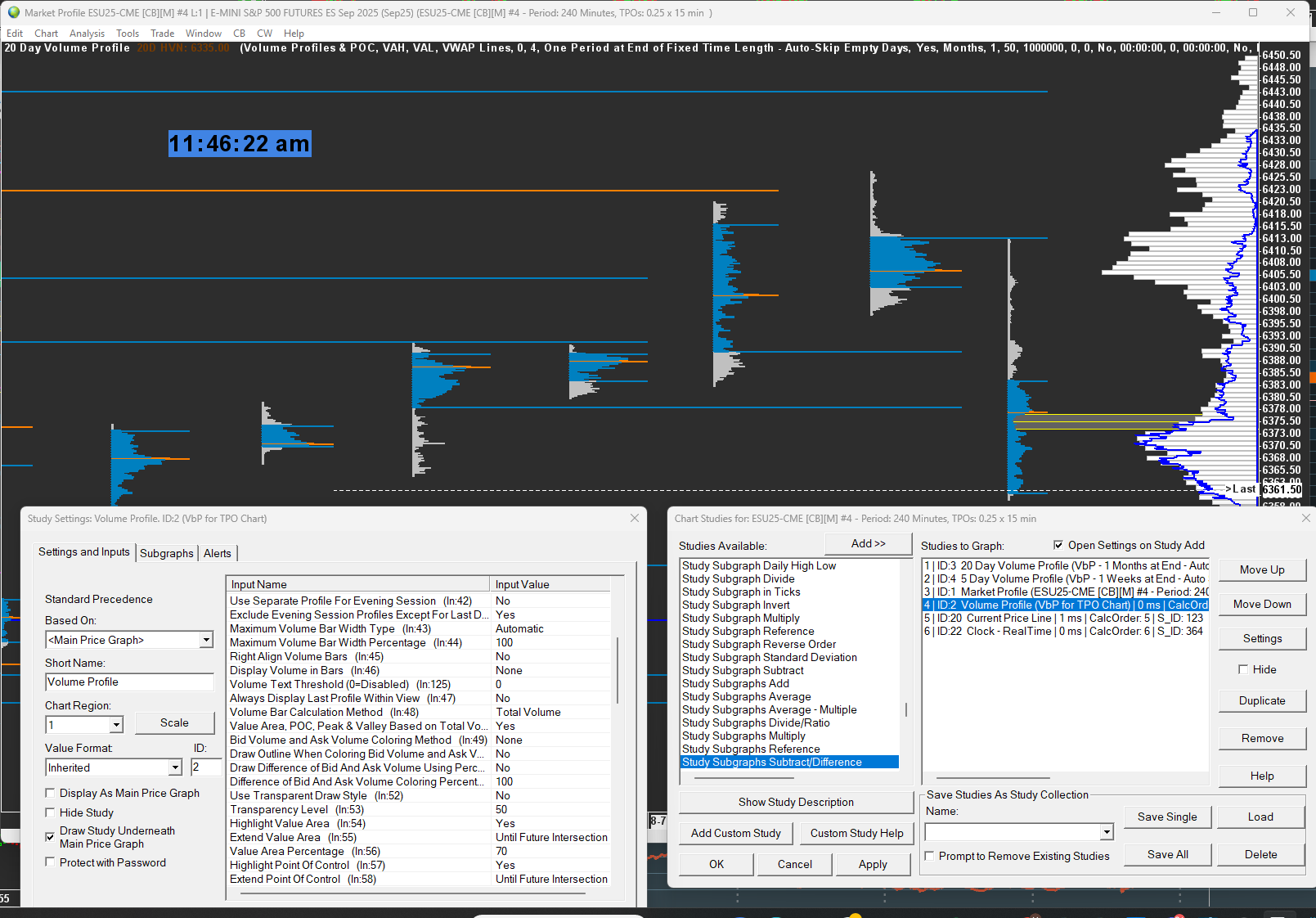

So i have created a chart that contains a TPO study and a Vbp study..the Vbp study is based on the the TPO chart...I have changed the TPO study to reflect a 40% value area...yet when i change it in the Vpb study it will not stay...it keeps reverting back to 70%...the reason i have created the chart this way it allows me to set the time of the vbp and merged them where as if i did a vbp chart based on multiple periods it does not allow merging of time periods....can you please advise
imageScreenshot 2025-08-07 114630.png / V - Attached On 2025-08-07 15:49:57 UTC - Size: 205.56 KB - 259 views

Refer to the information here:
Volume By Price Study: Value Area Percentage

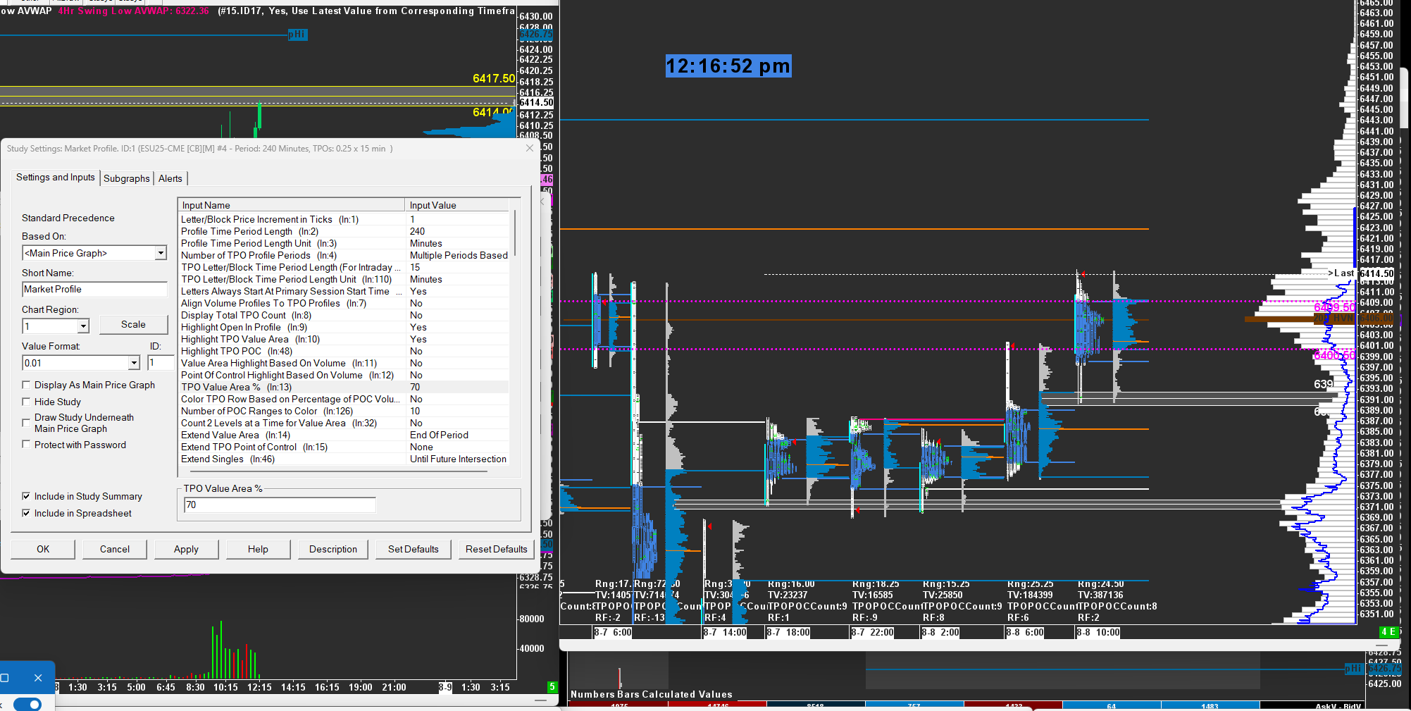

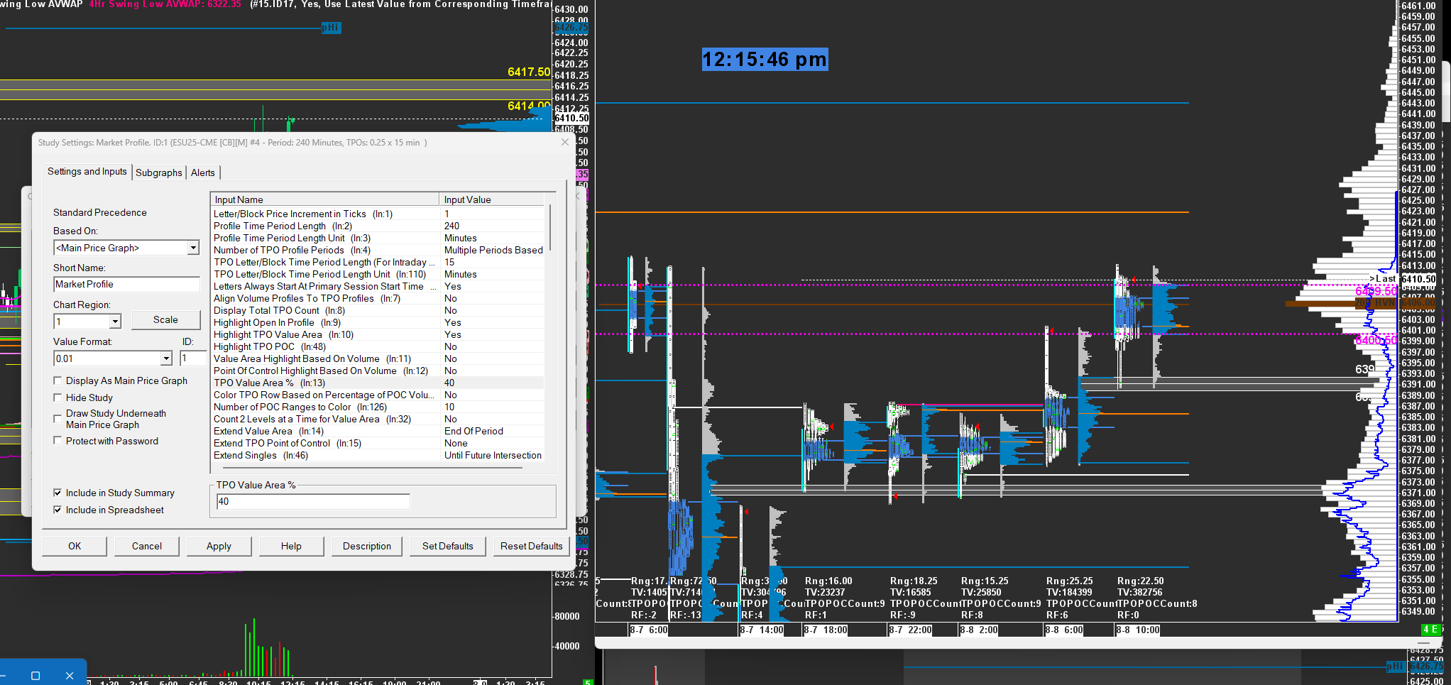

Ok so i did read it...there is no reason to be nasty or condescending...i have set the TPO to be 40% and the Vbp does not change to 40%....see the first picture has the tpo set at 40%...the VBP is not reflecting the 40%......the second picture has the tpo value area set at 70% note the vbp is still the same value area..essentially the value area is not changing with the TPO setting.
imageScreenshot 2025-08-08 121552.png / V - Attached On 2025-08-08 16:17:42 UTC - Size: 265.26 KB - 262 views
imageScreenshot 2025-08-08 121656.png / V - Attached On 2025-08-08 16:17:52 UTC - Size: 261.7 KB - 240 views
[2025-08-08 16:46:21]
You are still not reading the documentation correctly. You need to change the Input for "Volume Value Area %" on the TPO study. This is a different Input from the "TPO Value Area %".
