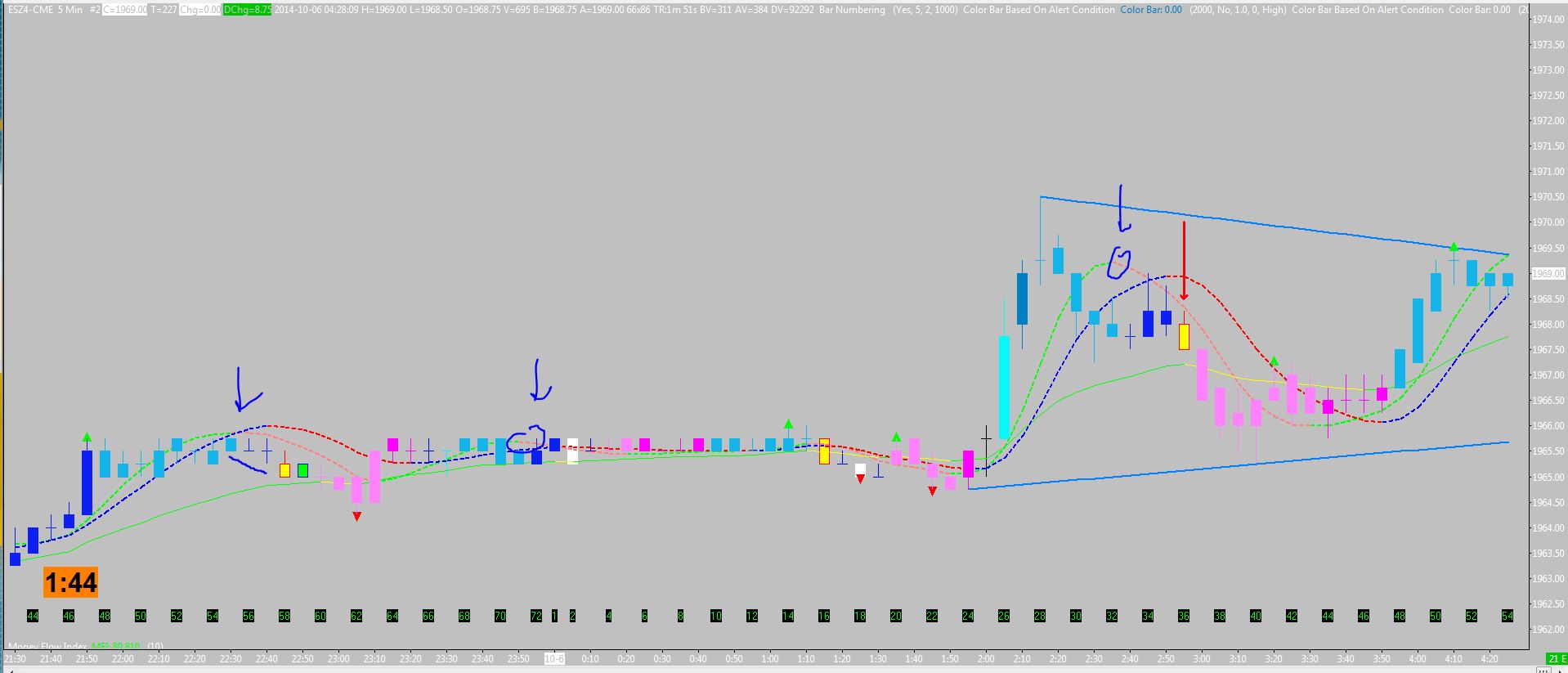

User28317 - Posts: 155
I HAVE SEVERAL ALERTS THAT COLOR THE BARS BASED ON SET CONDITIONS. HOWEVER, I CAN'T GET THE BAR TO CHANGE FROM A BUY TO A SELL WHEN THE SLOPE OF THE 16 HULL CHANGES FROM POSITIVE TO NEGATIVE. THERE IS A SEVERAL BAR DELAY BASED ON ANOTHER CONDITION. ANY ADVICE WOULD BE APPRECIATED.
imageHOW TO CHANGE BAR COLOR BASED ON SLOPE OF HULL.JPG / V - Attached On 2014-10-06 08:32:51 UTC - Size: 118.98 KB - 575 views
[2014-10-06 13:35:40]
mkata - Posts: 103
You will need to move the hull condition study up higher in the study list so that it takes precedence before the other study conditions.
http://www.sierrachart.com/index.php?page=doc/doc_ChartStudies.html#StudyDisplayOrder

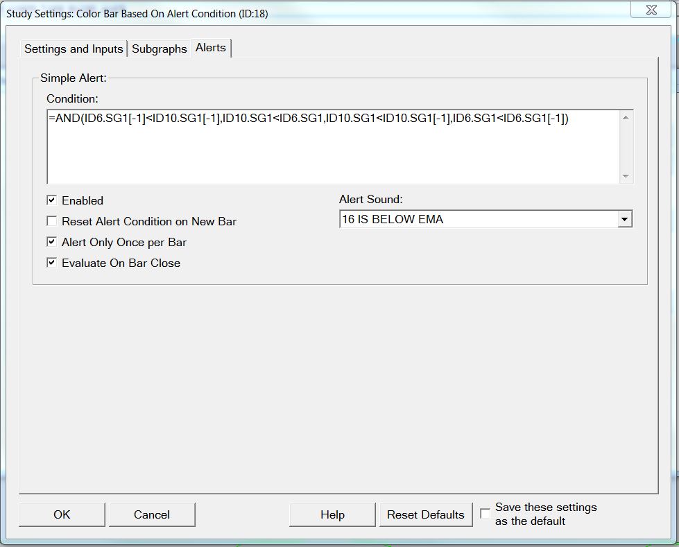

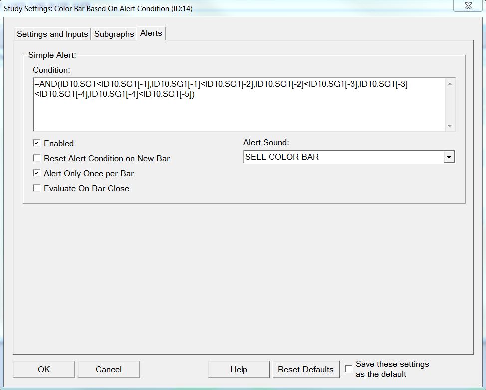

these are two sell expressions, how to combine them as one?
imageALERT 14 SELL.JPG / V - Attached On 2014-10-06 15:41:39 UTC - Size: 79.69 KB - 493 views
imageALERT 18 SELL.JPG / V - Attached On 2014-10-06 15:42:00 UTC - Size: 81.79 KB - 455 views
When both are positive I want to color the price bar positive. If the 16 Hull is above the 25 Hull and the 16 hull turns color due to slope, and price bar closes below the MA's, then I want to prioritize the color to being negative.

mkata - Posts: 103
See if this works. In my example ID6=16Hull and ID7=25Hull.
ALERT#1
=OR(AND(ID6.SG1>ID6.SG1[-1],ID7.SG1>ID7.SG1[-1]),OR(AND(ID6.SG1>ID6.SG1[-1],ID7.SG1<ID7.SG1[-1])))
ALERT#2
=OR(AND(ID6.SG1<ID6.SG1[-1],ID7.SG1<ID7.SG1[-1]),OR(AND(ID6.SG1<ID6.SG1[-1],ID7.SG1>ID7.SG1[-1])))
