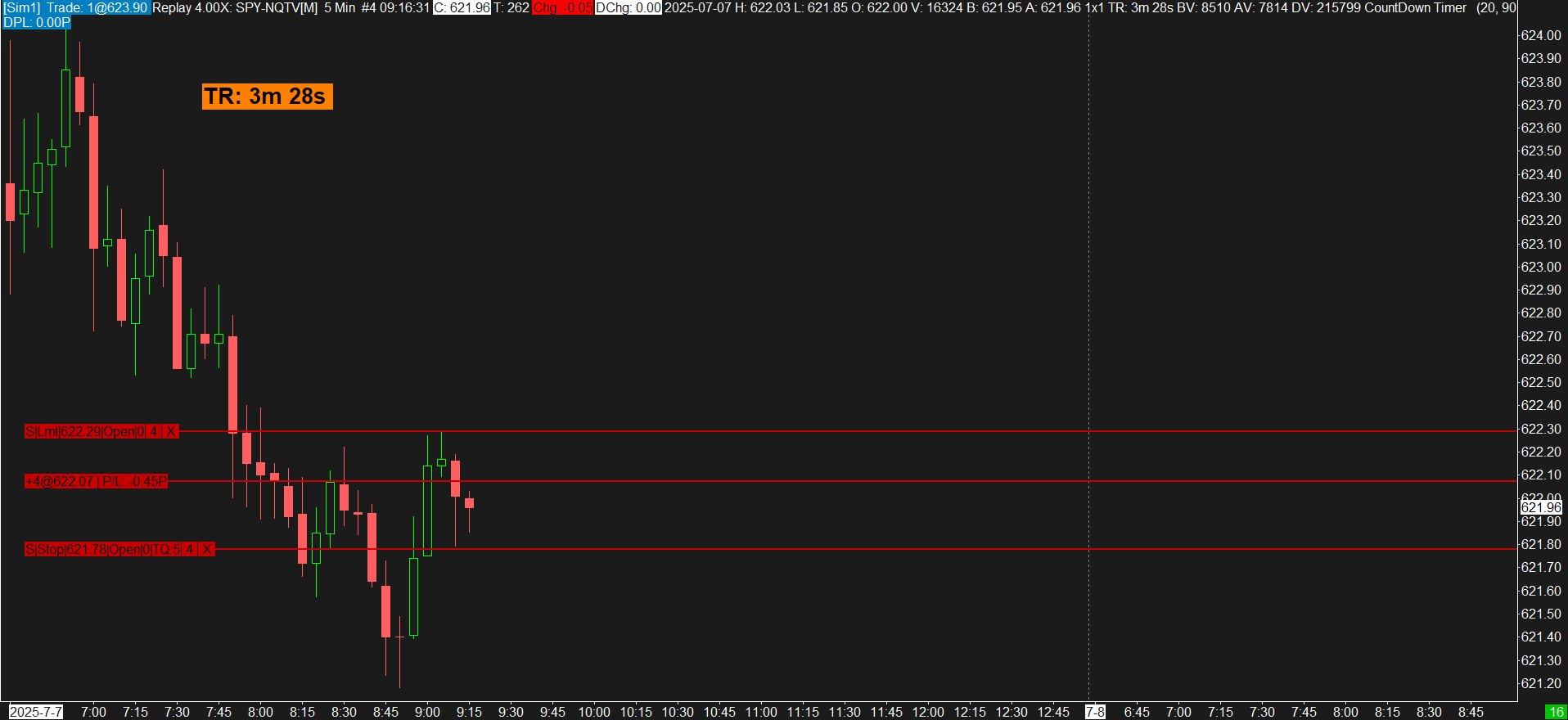

Now I am having issues with the opposite parent order not having its attached orders, and instead acting almost like a scaleout order. See https://www.sierrachart.com/image.php?Image=1752101744763.png , where there are qty 4 long position, after 3 bull bars, and scaling in on the close of the bear bar. The opposite sell order at the low of the bear bar shows up in the Attached Stop Order as TQ 5. I would like this to appear as its own order with an attached buy limit and buy stop order above.
I have included the snippet of the code below, which creates the long scale-in order at the close of the bear bar, and then sets TradingScaleOut to false, and submits the opposite order.
I have also attached a version of the cpp file with changes. Thanks

[2025-07-11 20:58:01]
rajeshh - Posts: 50
Hello - Any Takers? I have renamed the thread because the original hang issue in the title of the thread was due to my bug, and I felt the title is misleading. The current issue may still be due to a bug, but I have taken a hard look at the code, and cannot spot anything.
So in short, I need to create a reversal order with attached orders at the same price where I have the stoploss for my current position. So if I am long 4 qty, I want to create a sell order of qty 1 with its own attached orders at the same price as the attached stop order of the long position. With the code in the attached file, it is creating the new reversal order, but not the attached orders. I have manually tried this in Sierra Chart, and it works as expected. I need help getting my ACSIL to do the same. Thanks
