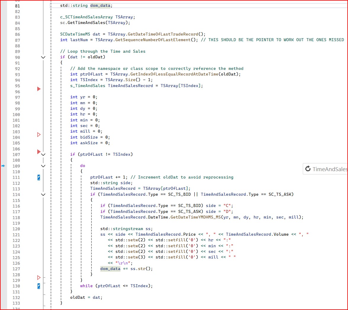

I am trying to write some signal processing code on the time and sales data using your custom interface. I have a problem when I compare your time and sales window to the data I receive within a study. I use dat = GetDateTimeOfLastTradeRecord() to compare with the previous study loop iteration to make sure there is new data. I then use the GetIndexOfLessEqualRecordAtDateTime(oldDat); for the new starting position and cycle round until up to date. I filter on record type with TimeAndSalesRecord.Type == SC_TS_BID || TimeAndSalesRecord.Type == SC_TS_ASK to screen out any type 6 data but I get reduced number of trades reported both in quantity and volume.
I am a coder of 30 years c++ and c#, and I am using vs2022 >> debug >> attach to single step the process, but still no joy where the problem is. I will include a code snip, just in case...
// Get DOM data
s_MarketDepthEntry DepthEntry;
std::string dom_data;
c_SCTimeAndSalesArray TSArray;
sc.GetTimeAndSales(TSArray);
SCDateTimeMS dat = TSArray.GetDateTimeOfLastTradeRecord();
int lastNum = TSArray.GetSequenceNumberOfLastElement(); // THIS SHOULD BE THE POINTER TO WORK OUT THE ONES MISSED
// Loop through the Time and Sales
if (dat != oldDat)
// Add the namespace or class scope to correctly reference the method
int ptrOfLast = TSArray.GetIndexOfLessEqualRecordAtDateTime(oldDat);
int TSIndex = TSArray.Size() - 1;
s_TimeAndSales TimeAndSalesRecord = TSArray[TSIndex];
int yr = 0;
int mn = 0;
int dy = 0;
int hr = 0;
int min = 0;
int sec = 0;
int mill = 0;
int bidSize = 0;
int askSize = 0;
if (ptrOfLast != TSIndex)
do
ptrOfLast += 1; // Increment oldDat to avoid reprocessing
std::string side;
TimeAndSalesRecord = TSArray[ptrOfLast];
if (TimeAndSalesRecord.Type == SC_TS_BID || TimeAndSalesRecord.Type == SC_TS_ASK)
if (TimeAndSalesRecord.Type == SC_TS_BID) side = "C";
if (TimeAndSalesRecord.Type == SC_TS_ASK) side = "D";
TimeAndSalesRecord.DateTime.GetDateTimeYMDHMS_MS(yr, mn, dy, hr, min, sec, mill);
std::stringstream ss;
ss << side << TimeAndSalesRecord.Price << ", " << TimeAndSalesRecord.Volume << ", "
<< std::setw(2) << std::setfill('0') << hr << ":"
<< std::setw(2) << std::setfill('0') << min << ":"
<< std::setw(2) << std::setfill('0') << sec << ":"
<< std::setw(3) << std::setfill('0') << mill << " "
<< "\r\n";
dom_data += ss.str();
    while (ptrOfLast <= TSIndex);
oldDat = dat;
