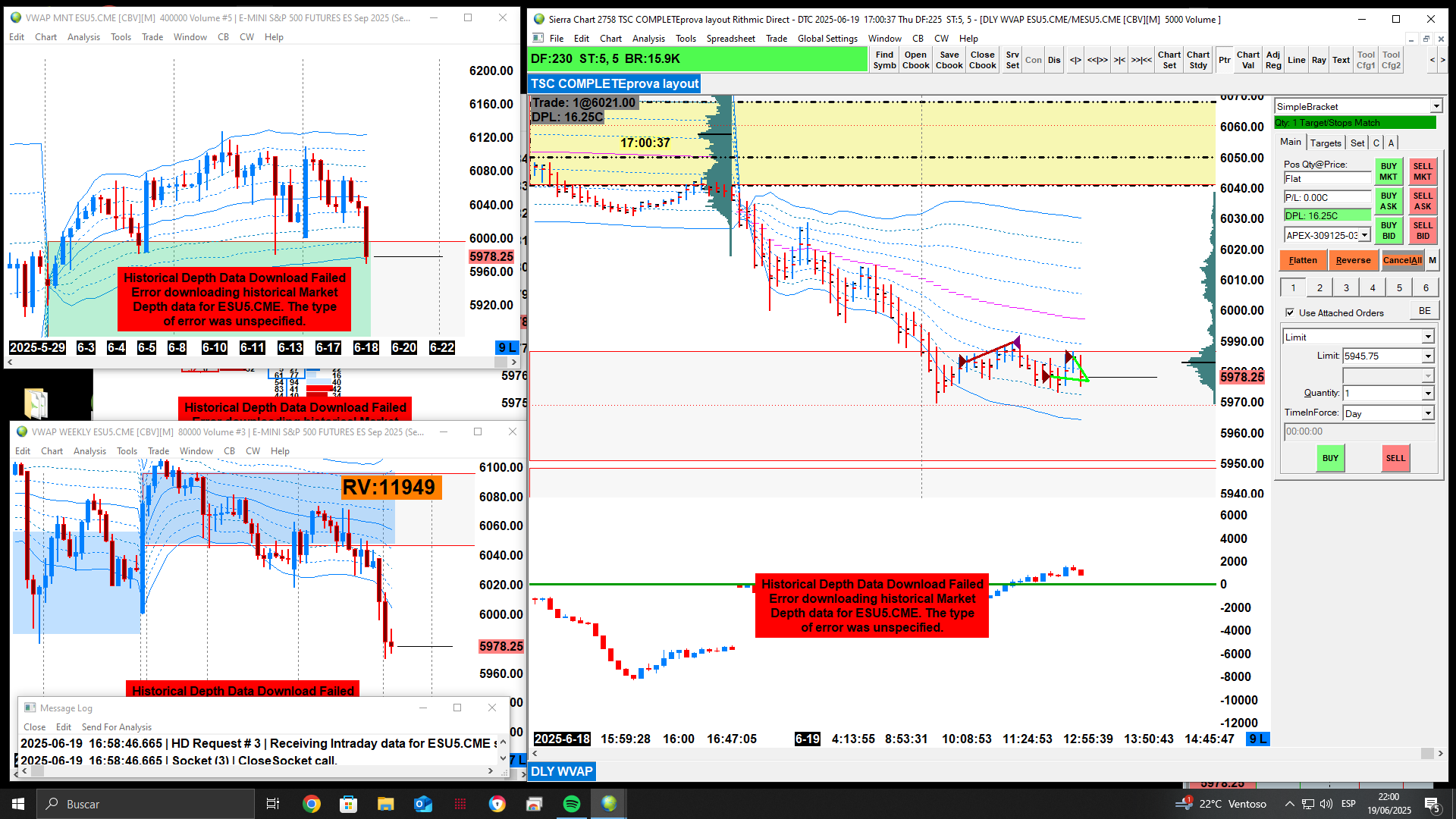

salve,oggi nel mezzo della sessione di trading mi si e' bloccato tutto,provo a riconnettermi ma mi da errore nel scaricare i dati,mi si e' fermato il grafico e non carica piu' nulla,comme posso risolverlo? vedere foto

From Google Translate:
Hi, today in the middle of the trading session everything froze, I tried to reconnect but it gave me an error downloading the data, the graph stopped and won't load anything anymore, how can I fix it? see photos
We believe that part of the reason you are having an issue is that today is the U.S. Juneteenth holiday, so the CME Group stopped trading at Noon Central US time.
Although that specific error is a bit odd. Were you trying to get historical market depth data at the time?
[2025-06-19 21:19:54]
User561779 - Posts: 6
Ok grazie,non ero al corrente della festività di oggi,si quando è apparso questo errore stavo cercando di Ricconnettermi e di conseguenza di scaricare anche l'istoriale delarket depth
[2025-06-19 21:37:29]
John - SC Support - Posts: 48659
Ok thanks, I was not aware of today's holiday, yes when this error appeared I was trying to reconnect and consequently also download the depth archive
Please wait until the markets open again and see if you can get the historical market depth data at that time. The CME Group will be back trading at 17:00 Central US Time today (June 19, 2025).

[2025-06-20 09:04:41]
Everything it's working as normal now,thank you very much for your help
