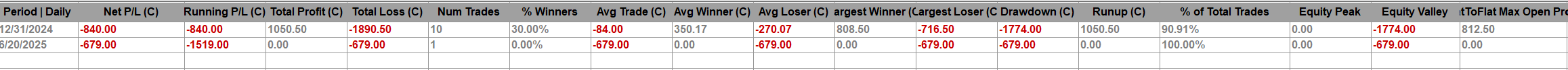

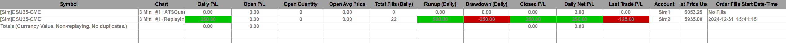

Also today the Period Stats and Statistics tabs are incorrect but the Chart Stats tab is correct. I've attached screenshots of those.
The replay started as of 2024-21-31 but PnL is appearing for the current date even though the testing period ends prior to it.

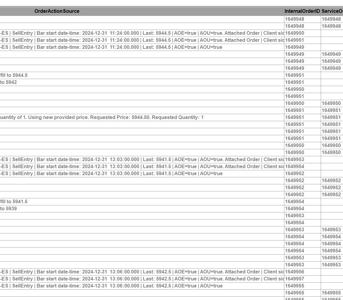

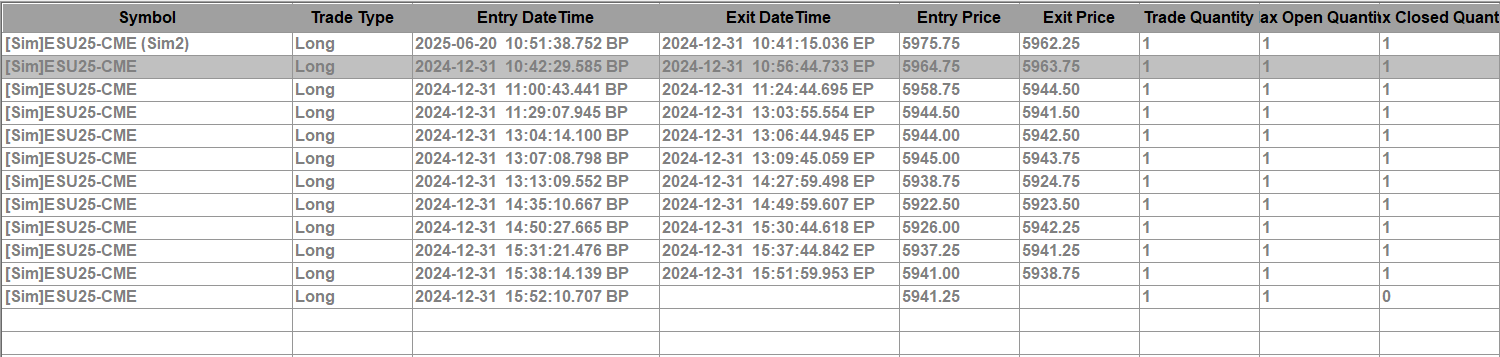

The TAL is creating orders that never occurred.
I've attached screenshots of the TradesList and OrderActionSource.
Viewing the OrderActionSource, you can see that the system was selling throughout the period (i.e. 2024-12-31); The PnL matches that of the ChartStats.
However, viewing the TradesList, every trade is Long. There were no long trades.
Also, the backtest started on 2024-12-31 but here are trades on the current date of which is not part of the backtest.
Looking at the TradesList, you can see that even though there were no trades on 6-20, TAL lists an entry as of the current date with an exit as of the beginning of the backtest (i.e. 2024-12-31)

[2025-06-20 15:46:25]
John - SC Support - Posts: 48658
The Sell Entries are lining up with the time of the trade closing. So you are getting a Sell offsetting a Buy at some point, which is why it is showing as a Long position. The same is true for the trade that shows the current date - the current date is an Entry, which is then offset by the first Sell order during the backtest.
In other words, there is/was an open position at the time the backtest was started, which created an offset in the order fills.
You need to redo the backtest and ensure that there are no positions or orders in the chart. You may want to delete all simulated orders and positions to ensure that everything is "zeroed" out prior to the backtest. Refer to the following:

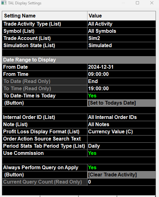

@Engineering
I was referring to the button in the Display Settings(see attached) to clear the activity.
The refresh of the queue lags. At times there are several pending events.
I'm aware of properly configuring the settings as I've used Sierra for over a decade.
Currently, I have to clear activity multiple times in an attempt to offset the phantom order being generated prior to the backtest beginning.
The queue increments.
Then I have to wait for the queue to clear, otherwise, if I begin the backtest, the queue will refresh and delete the trading activity up to that point.
