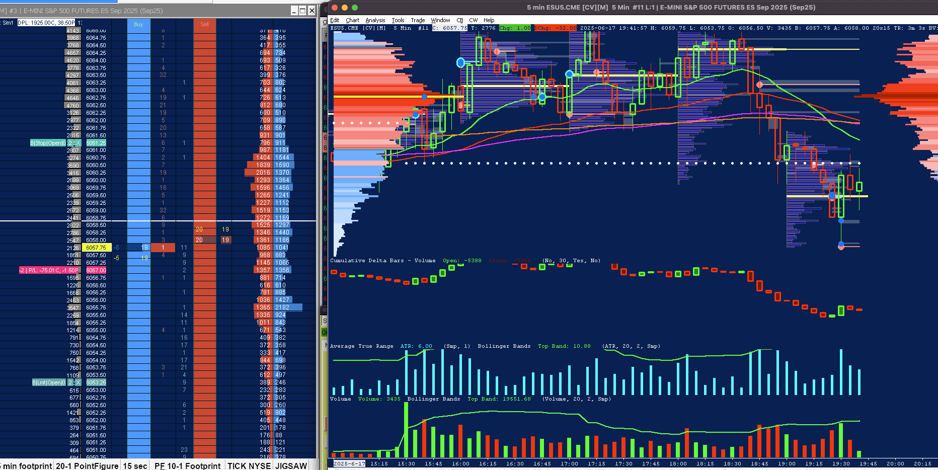

Hello, I wanted to know how to connect the left dom with the right chart in a single page so that the price moves together. As if it were the same chart. Thanks See photos
imageScreenshot 2025-06-17 alle 19.41.58.png / V - Attached On 2025-06-17 17:44:28 UTC - Size: 220.62 KB - 282 views

There is not really a way to do this in the way you are asking. The best you could do would be to setup the linking options for the two charts to have the same "Vertical Scale" and set the Scale Settings to be the same between the two scales, which would require setting the Chart scale to "Constant Range" and setting the same range value as the Trading DOM. And then you need to have the DOMs themselves be the same size.
In the end, there is a human factor in this such that it will be very difficult to get them to exactly line up.
The best option is to setup the DOM the way you want it within the chart itself.
