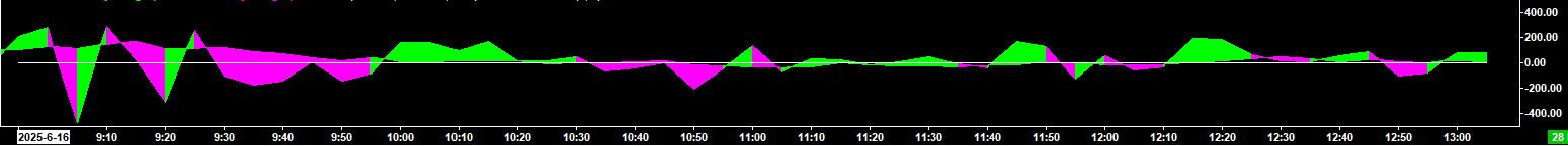

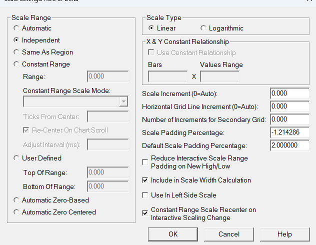

When I initially created this study, the data displayed above and below a fixed horizontal axis with "0" as its value (I'm using the "Study Subgraphs Reference" study). However, the data is no longer using "0" as an "anchor" point. Can you please tell me how to change back to the original settings? I've also attached the scale settings if that helps?

Reset the scale:
Chart Scale and Scale Adjusting: Resetting the Scale

I believe I tried every option on the chart scale re-set panel, but I still cannot get the data to display across a horizontal zero line with positive data above and negative below. I assume I am missing something obvious? Thx

If that is the only study in that region, then set the "Scale Range" to be "Automatic".
