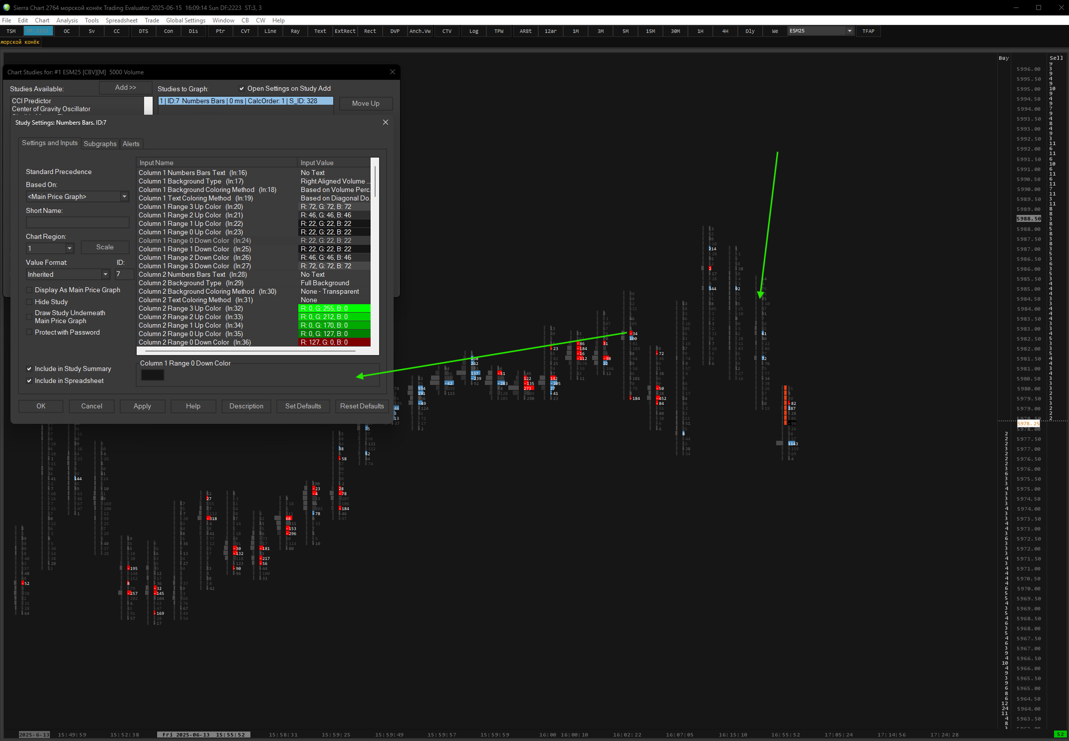

[2025-06-15 20:15:12]
jmftattoo - Posts: 106
There is no RGB value in the settings interface, see screenshot, also no close markers being drawn between values.

[2025-06-16 07:54:25]
Right... I have done that, updated , updated again to pre-release, fresh install, and still... No RGB values in settings panel, and NO vertical box open or close markers past the current bar https://www.sierrachart.com/image.php?Image=1750060378996.png

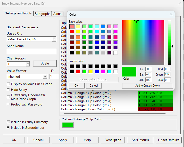

[2025-06-16 15:59:49]
John - SC Support - Posts: 48659
It looks like you have not selected the color button on the Settings window to bring up the color selector. You need to select that color that is showing at the bottom to bring that up. Attached is an image what you should get when you select that color.
With regards to the Markers not showing in the other columns, this is because you have the set the "Graph Draw Type" to "Renko Brick with Wicks", but since this is not a Renko chart, it does not make sense. Change the "Graph Draw Type" to "OHLC Bars" or "Candlestick" and you will see the markers in all the bars.
