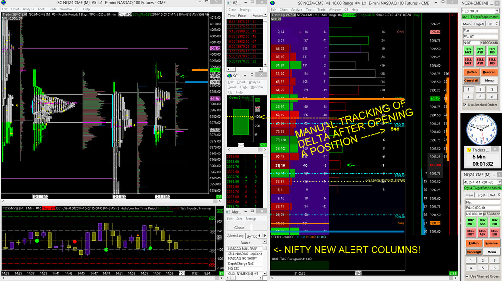

I would like to see a text study that can be placed in the fill area that shows 0000 on the screen when a trade position is flat.
I would like that number to go non-zero and display the cumulative delta at the moment a trade is put on.
The number itself could be colored based on above/below zero.
I've been doing this manually by marking the delta with a horizontal line and have not been able to pull this together using the spreadsheets.
http://www.sierrachart.com/image.php?l=1412318037203.png
Thank you very much for implementing my last request. Isolating the triggered study name in its own column is working great. ( Alert Manager Column Order )

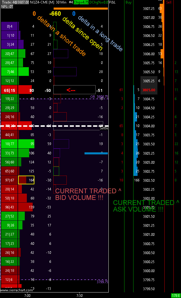

Tomgilb, this is working great. Take a look at the new feature from SC. v1200 added ChartDOM columns for Current Traded ASK/BID Volume!
The image shows how the numbers are displayed and I've also tied audio alerts to the delta numbers when they move for/against my favor.
Thanks again and good trading to you.
