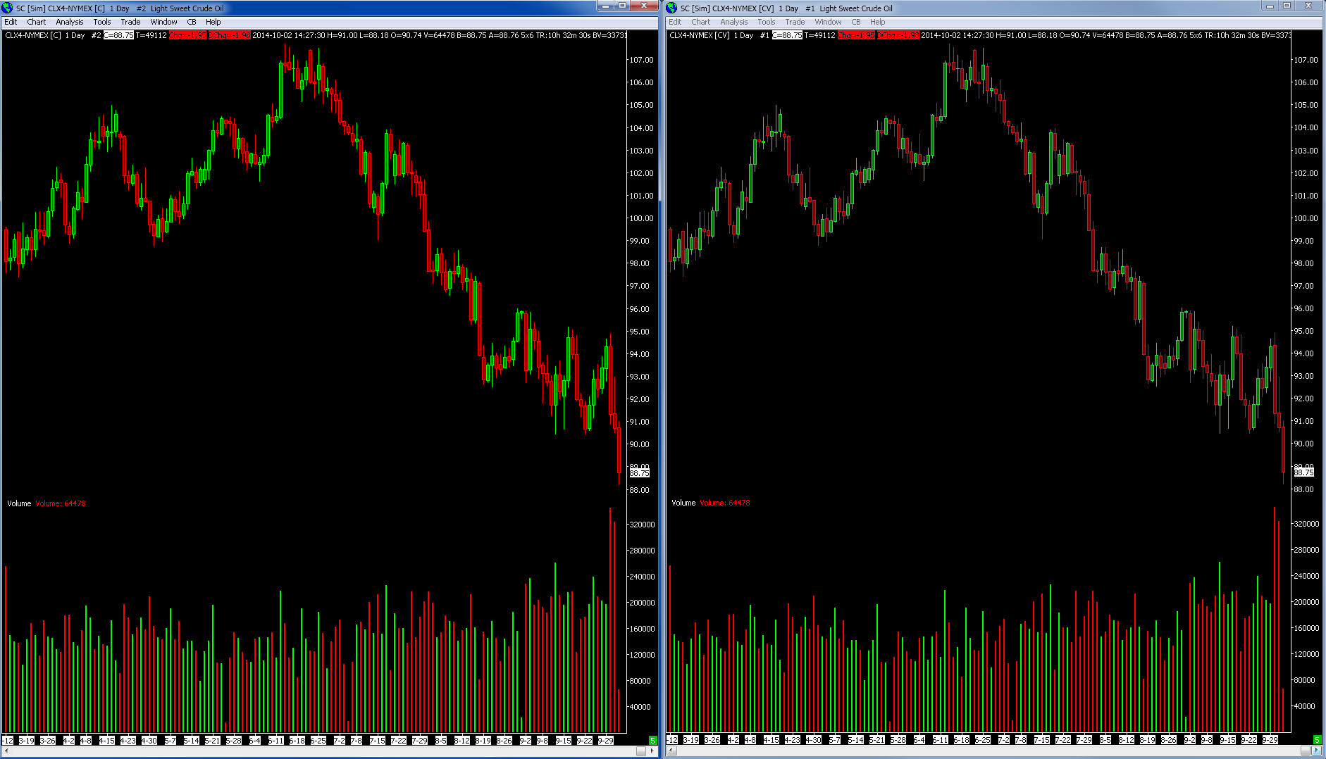

For a long time I felt that the volume based rollover is "not working well". sometimes it seemed to do a good job and sometimes it didn't.
Trying to fix this, I looked on global symbol setting rollover parameters and found that if I change the number of days there... it changes the way the volume based rollover chart is constructed.
What?? can't be.
Volume based rollover should have no other parameter to choose the day of rollover other than volume transition... yet the chart changes.
It took sometime to sink, but today I compared a chart of Continuous Futures Contract based on volume rollover to a chart based on date rollover.
What do you know >>> they are identical!
This explains why the "volume based" chart is influenced by number of days setting changes in the global symbol settings window... because it actually does a "date based" roll over.
This also explains why sometimes the "volume based" rollover seemed to do a good job and sometimes it didn't. because by accident sometimes the date rollover actually fell on the volume transition and sometimes it didn't.
* Attached picture of crude oil. left side is date rollover and right side is volume rollover.

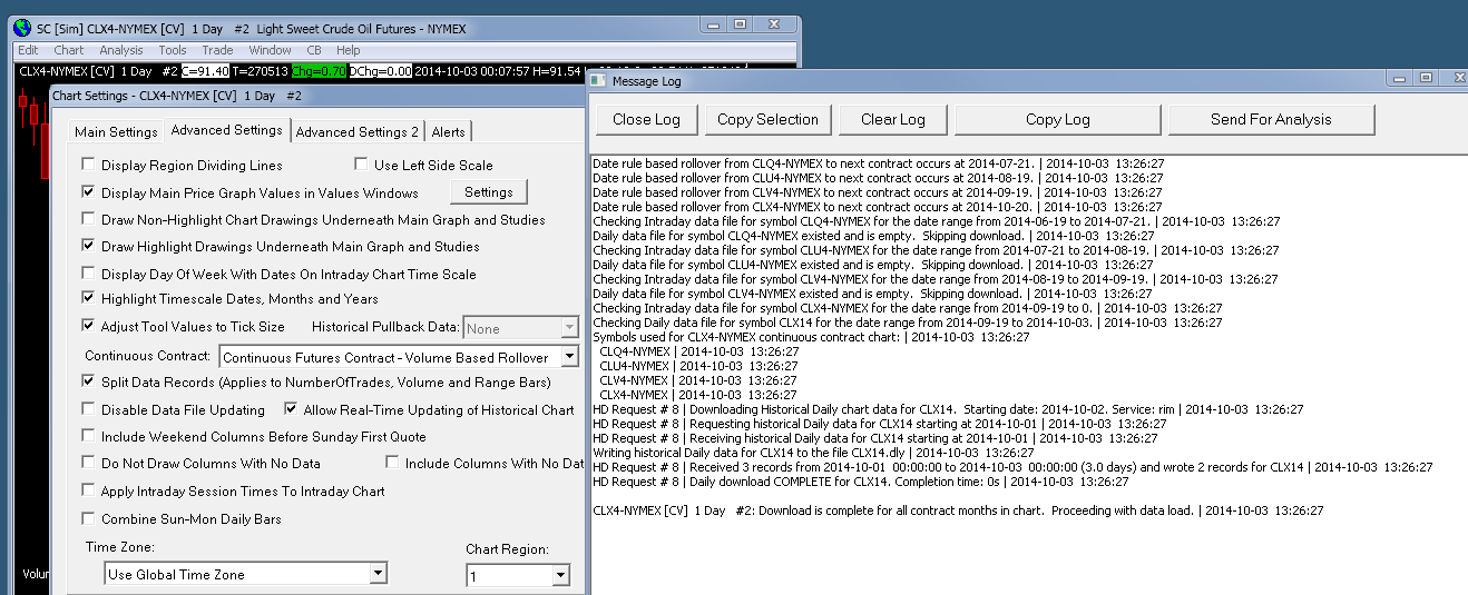

* Attached a picture showing volume rollover chart with the log and chart setting windows.
* No "cannot be determined" error line.
* From the first line of the log you can see that SC right away goes to "date rule based rollover" and sets the rollover dates.
* And of course the chart did not roll on the day of volume transition... even though there is no error msg.

[2014-10-03 15:10:54]
Interesting. It works fine for us:
Date rule based rollover from CLQ4 to next contract occurs at 2014-07-21. | 2014-10-03 11:10:05
Date rule based rollover from CLU4 to next contract occurs at 2014-08-19. | 2014-10-03 11:10:05
Date rule based rollover from CLV4 to next contract occurs at 2014-09-19. | 2014-10-03 11:10:05
Date rule based rollover from CLX4 to next contract occurs at 2014-10-20. | 2014-10-03 11:10:05
Checking Intraday data file for symbol CLQ4 for the date range from 2014-06-19 to 2014-07-21. | 2014-10-03 11:10:05
Checking Daily data file for symbol CLQ14 for the date range from 2014-06-19 to 2014-07-21. | 2014-10-03 11:10:05
Checking Intraday data file for symbol CLU4 for the date range from 2014-07-21 to 2014-08-19. | 2014-10-03 11:10:05
Checking Daily data file for symbol CLU14 for the date range from 2014-07-21 to 2014-08-19. | 2014-10-03 11:10:05
Checking Intraday data file for symbol CLV4 for the date range from 2014-08-19 to 2014-09-19. | 2014-10-03 11:10:05
Checking Daily data file for symbol CLV14 for the date range from 2014-08-19 to 2014-09-19. | 2014-10-03 11:10:05
Checking Intraday data file for symbol CLX4 for the date range from 2014-09-19 to 0. | 2014-10-03 11:10:05
Checking Daily data file for symbol CLX14 for the date range from 2014-09-19 to 2014-10-03. | 2014-10-03 11:10:05
CLX4 [CV] [M] 60 Min #12 | Symbols used for continuous contract chart: | 2014-10-03 11:10:05
CLQ4 | 2014-10-03 11:10:05
CLU4 | 2014-10-03 11:10:05
CLV4 | 2014-10-03 11:10:05
CLX4 | 2014-10-03 11:10:05
Volume based rollover from CLQ4 to CLU4 occurs at 2014-07-18 | 2014-10-03 11:10:05
Volume based rollover from CLU4 to CLV4 occurs at 2014-08-18 | 2014-10-03 11:10:05
Volume based rollover from CLV4 to CLX4 occurs at 2014-09-19 | 2014-10-03 11:10:05
We need to think about this and look at the code.

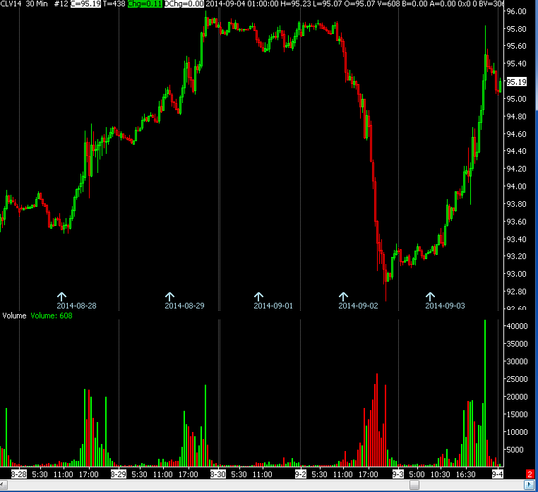

2. I tried to exclude a date from a chart (see attached picture) but it doesn't seem to work. never tried this before

2. For a moment I thought I was imagining.
I checked things again and it seems that this feature eliminates the date prior to what you put in.
In the pic I wanted to eliminate the low volume date, but SC actually eliminated the day before... which was a Sunday and hence to me it looked like nothing changed.
So it does work, be you eliminate a date prior to what entered.

Hendrixon - Posts: 130
Its there, check the first attached pic, i added date markers as well.
Picture two shows that in order to eliminate 9-1 I actually need to enter 9-2 (2010-09-02).
As you can see 9-2 is still there but 9-1 is gone.

[2014-10-07 16:23:16]
What are the Session Times for the chart and the time zone setting in Sierra Chart.
There should not be a problem with this.
