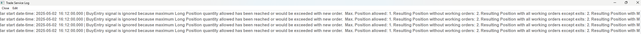

Regarding alerts, whenever an order is generated, my system sends an alert to notify me that an order is being generated.
The Trade Service Log is stating that max positions has been reached as the reason for not sending orders. This is weird as the Max Positions in the Trade Service Log is listed as 1 but the Max Position Size Allowed isn't set in my system. I haven't explicitly set sc.MaximumPositionAllowed.
Also if the Max Positions was 1, that shouldn't prevent the system from trading. It should only prevent a single trade quantity from exceeding this amount. The behavior I'm experiencing is as if after a single trade has been placed, no further trades are allowed.

imageMax Position Allowed Error.png / V - Attached On 2025-06-02 13:48:49 UTC - Size: 35.52 KB - 308 views

Update:
I don't understand what is happening with Max Positions Allowed as I'm not setting it.
I do understand why my system isn't trading as a result of that.
My system dynamically determines position sizes.
So its sending an initial order for a 1 lot and attempting later in the replay to send orders with quantities greater than 1.
Because of whatever is happening with the setting of Max Positions Allowed, the orders are being rejected.
