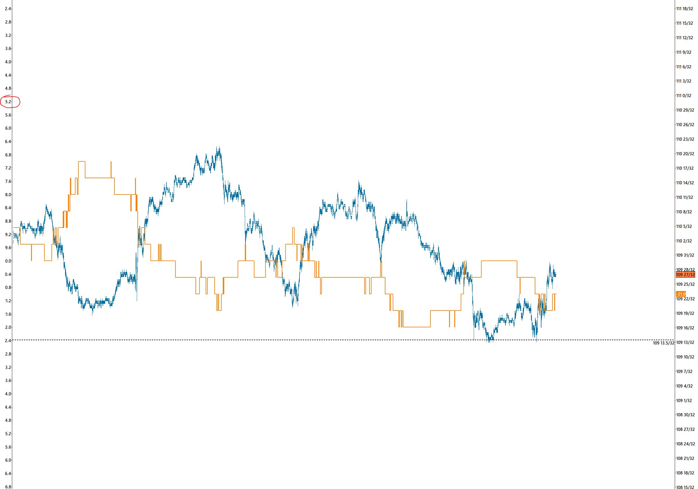

Please refer to the attached imagine. I have two symbols where I want to overlay, and have used the 'additional symbol study" to do so. However, I want to adjust the lefthand scale from 0.2 to 0.5 to correctly match the tick increment of the additional symbol. I cannot seem to do that without messing up the entire chart.

There is no way to specifically control the increment that is displayed in the Left Side Scale. Any changes that you made to the Scale Settings actually affect the right-side scale.
The only item you can change that would affect what is displayed in the left side scale is the "Value Format" of the study that is displayed in that left side scale. This will change how many digits are displayed.

thanks for the response, is there something in the works to make this possible?

There is nothing currently under development in this area.
We take all suggestions for changes, but we can not say when we would get to any particular item.

ok understood. Based on my use-case which is just seeing 2 symbols overlaying with correct price increments, do you know of any other way to achieve this?

There is not a way to do this with the Left-Side Scale. You would have to use the main scale on the right.
