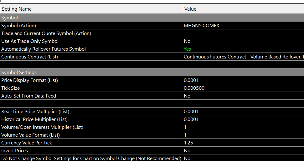

Made changes in symbol settings saved and restarted app.

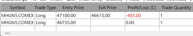

Toke trade 2 tick winner, PNL should be 2.5 but is 10.

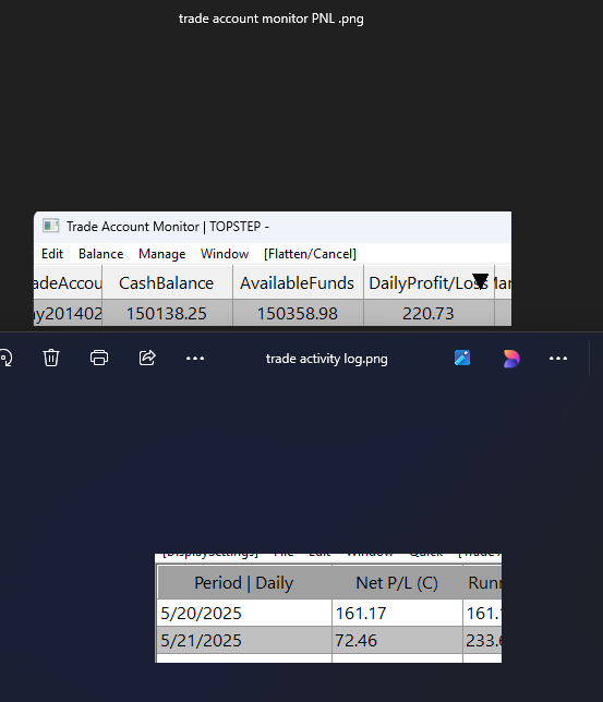

Also 2 different daily PNL Trade account manager ( correct ) / Balance window vs. Trade Activity log (wrong).
Also chart has 4.6755 format and Trade Activity log has different format 46755.
What should I do to fix a problem ?
imagemade changes.png / V - Attached On 2025-05-21 15:48:55 UTC - Size: 30.78 KB - 349 views
imagetoke trade.png / V - Attached On 2025-05-21 15:49:12 UTC - Size: 7.93 KB - 264 views
imagepnl diffence .png / V - Attached On 2025-05-21 15:51:59 UTC - Size: 38 KB - 320 views

[2025-05-23 21:13:59]
We apologize for the delay on this. We will need to set up symbol settings for the symbol for Rithmic.
Date Time Of Last Edit: 2025-05-23 21:14:09
[2025-05-25 03:49:41]
This symbol has been set up.
Re-download all the data in the chart by going to the chart and selecting "Edit >> Delete All Data and Download" from the main Sierra Chart menu. You just need to do this once per symbol and not for each chart. This command is on the main Sierra Chart menu at the top. Only use it from that location.
