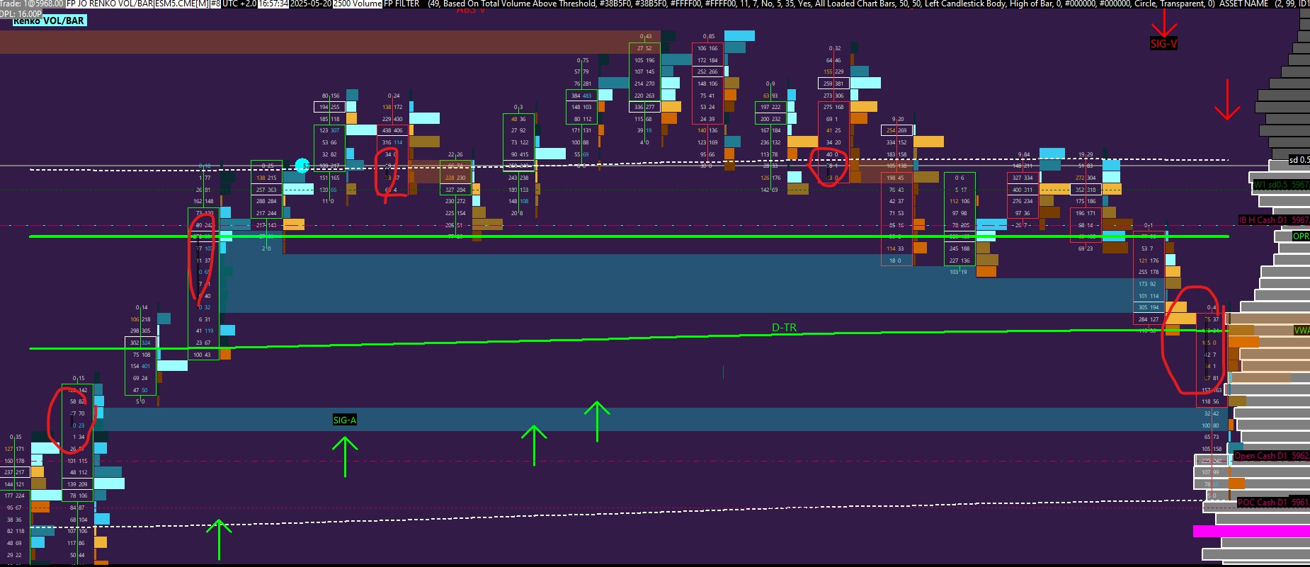

I have a renko footprint chart, but I have a slight problem on my Display, espacially on the edges zones, I know how to put the edges zones, but I have a black mark that I can't take off wich doesn't allow me to read the data as weel as I would Like.
Can you tell me how to take it out please. (see the attached file).
Thank you

We do not know what is causing that. You would need to remove other studies one by one to see if there is a particular study that is drawing that. Once you find the study, then you would need to keep it removed, or figure out what needs to change to have it draw as you want.

ok, thank you for your answer, i'll try to isolate the problem

I found the problem, it comes from the settings of my study (Volume at price threshold Alert V2), at the subgraph "adjacent highlight Alert) with some configuration that idon't need, it tootk care of the problem
