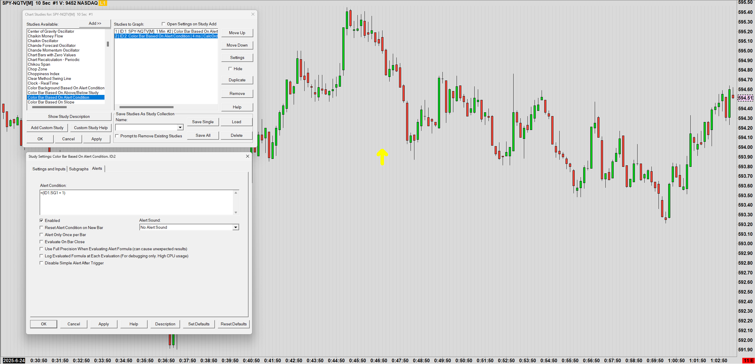

Apologies if my wording is confusing, but I'm finding it difficult to wrap my head around this.
I have 2 charts open, both using different bar periods (chart #1 and chart #2)
With chart #2, I'm using Color Bar Based On Alert Condition (ID1.SG1). I have "Output When Condition True" set to Study Subgraph Reference.
I am referencing a Moving Average (ID2.SG1) set to "hidden" on that same chart, so that whenever the alert condition is true, the alert paints an arrow on the chart where the moving average currently is.
On chart #1, I'm using "Study/Price Overlay" (ID1.SG1) to overlay the arrows from chart #2. However, I would like to change the positioning of the arrows. Perhaps put them above the candles, or even have them attached to a different length moving average etc.
How would I go about doing this? I tried adding a Color Bar Based On Alert Condition to chart #1, and setting the formula to: =(ID1.SG1 = 1), but that didn't work.
imagechart #2.png / V - Attached On 2025-06-24 02:18:05 UTC - Size: 168.53 KB - 333 views
imagechart #1.png / V - Attached On 2025-06-24 02:18:08 UTC - Size: 203.52 KB - 245 views
